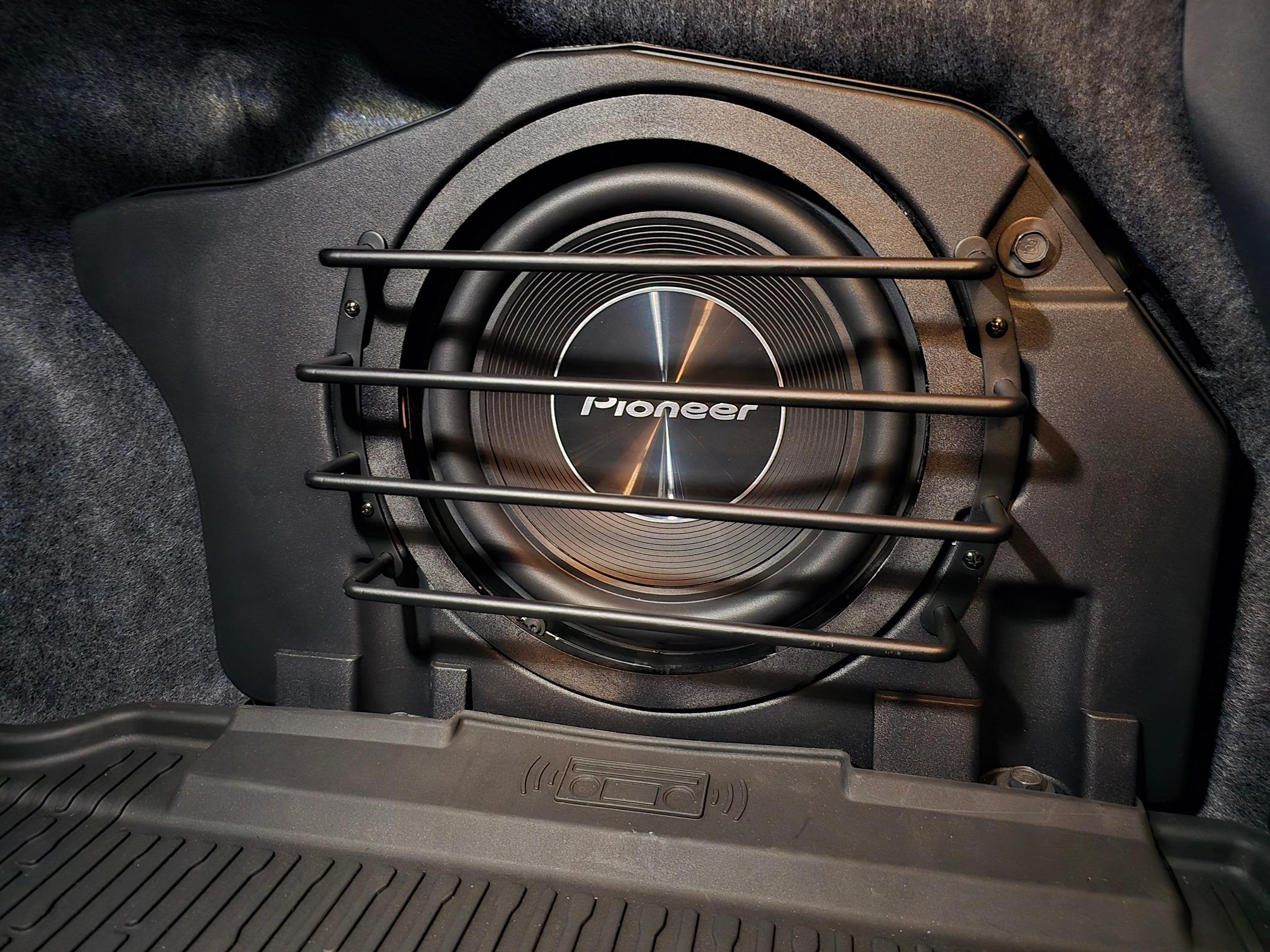

Although, I did the Pioneer sub swap. Watched every video, read every post on how to remove the trim ring. Got the first one popped without breaking, then when 6 for 6 breaking every f'n one.
Metal clips could give me life! 😂

I think it really helps the B&O system greatly. Much more tight and controlled bass. If you're looking for window shaking bass, this isn't it. I'm very happy with it and it was around $100.00.
Link to post
https://www.mustang6g.com/forums/threads/b-o-10-sub-replacement-guide.148813/
Supplies for the swap
Pioneer TS-A250D4 10" Dual 4 ohms Voice Coil Subwoofer, Black https://a.co/d/6aLDnhe. On sale!
RED WOLF Door Speaker Wiring Harness Compatible with 2002-2019 Jeep Wrangler JK, Chrysler, Dodge Vehicles Car Harness Plug for Aftermarket Front Rear Door Speaker Wire Cable Connector 4 PCS https://a.co/d/ihZ3HgW
Fairfield The Original Poly-Fil, Premium Polyester Fiber Fill, Soft Pillow Stuffing, Stuffing for Stuffed Animals, Toys, Cloud Decorations, and More, Machine-Washable Poly-Fil Fiber Fill, 12-ounce Bag https://a.co/d/86XrLEg
I bought this grill, to hold the trim ring in place, along with some velcro
GS Power 10 inch Bar Grille for Subwoofer & Speaker in Chrome Silver or Matte Black Finish (1 pc). Also Available in 8 & 12” https://a.co/d/cIyLOnt
