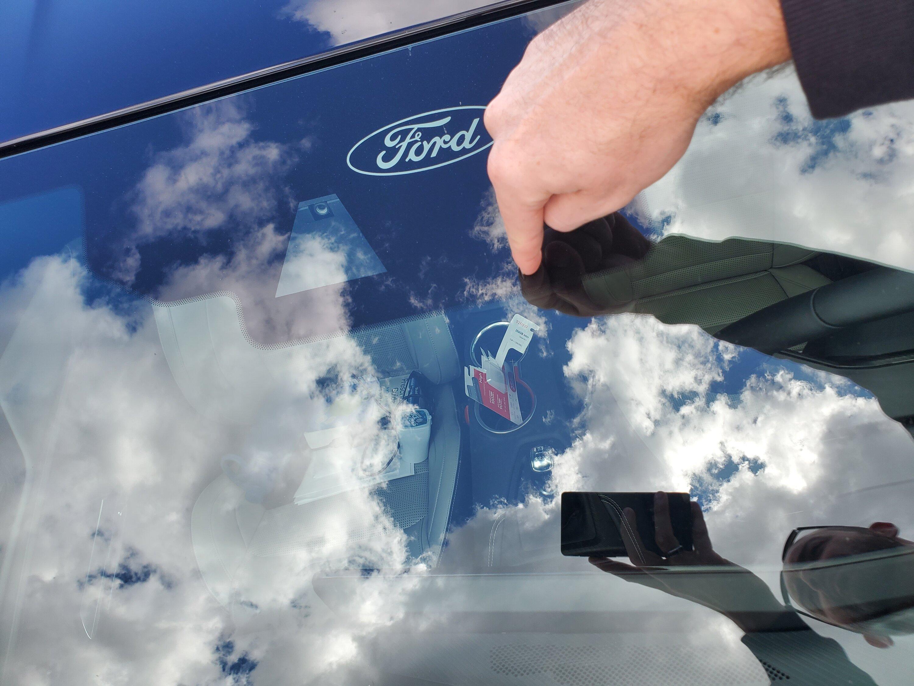

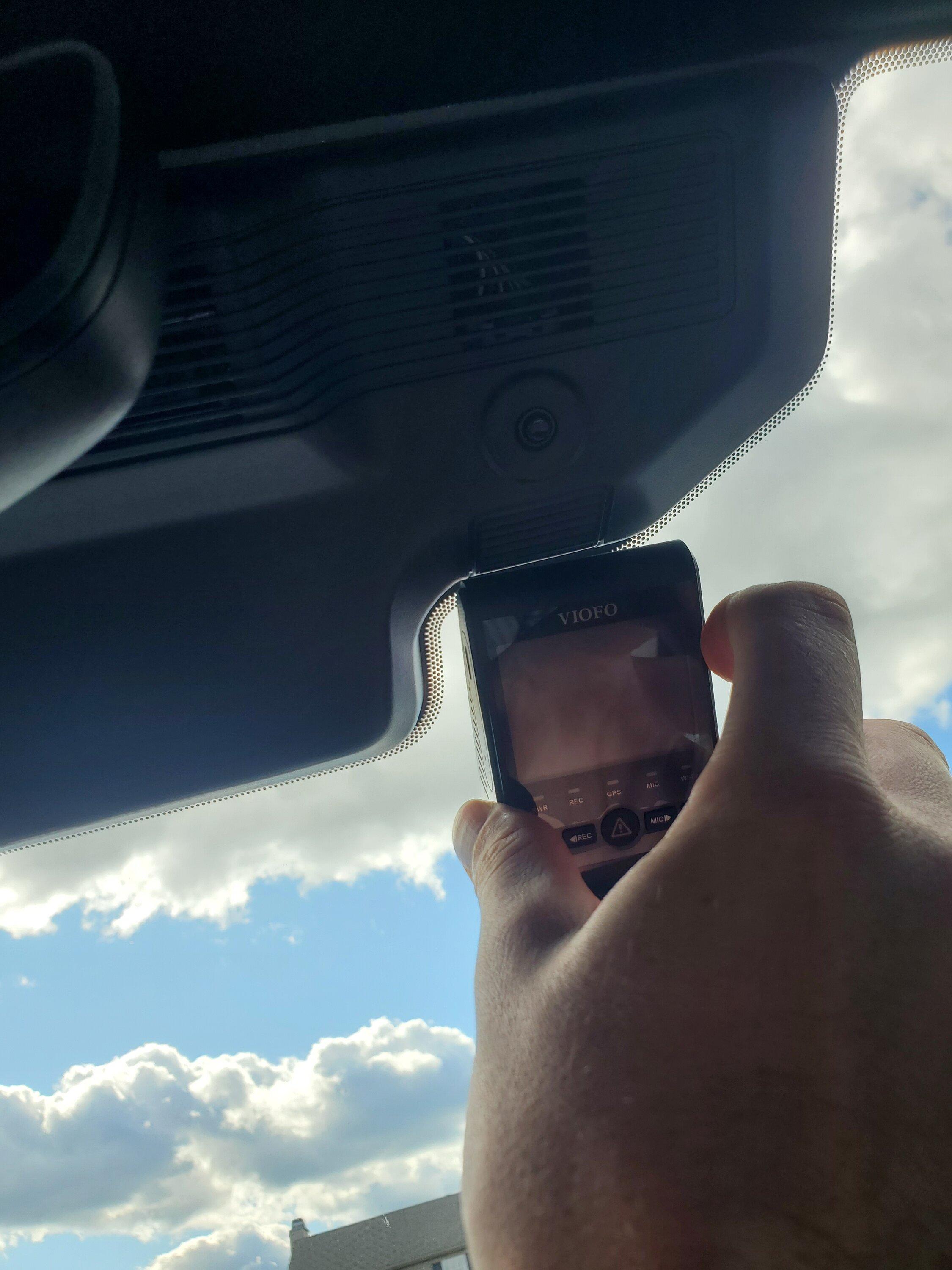

Got newest Viofo 229 or whatever today. Came with Large front camera, rear cam, and memory card. 2 really long cords USBC (both ends). One smaller USB A to C cord, and cigarette plug. Judging by the manual the A to C cord is for charging not recording but I'm curious if it'll work since our rear mirrors have a USB A port not C I'll have to find an alternative cord bc I don't feel like hard wiring or running the long cords through the car
Pointing to location of USB A port and other Pic is pretty much the only mounting spot that just barely sticks below the mirror for My field of view. I'm also 6'4" so my field is a little higher lol

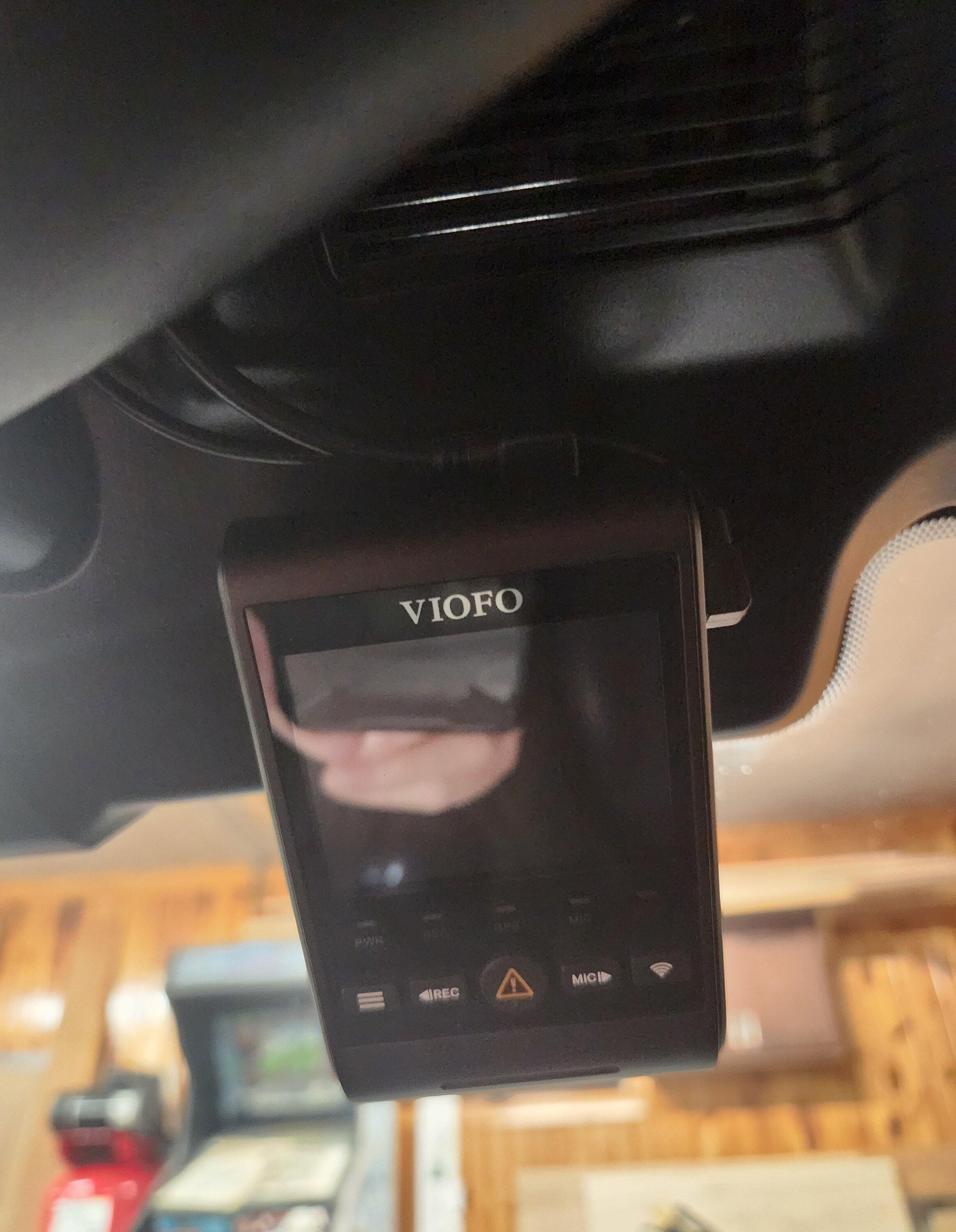

I have the same camera. I put it on the plastic part behind the mirror. Just to the left in your pic. The lense hangs down just below the plastic. I works fine for me. I agree there is just not a good spot with all that crap going on up there.
I can post a pic if you want

Ah nice I didn't think to attach it to the plastic. Nice call

I can take better pics if you want. Just make sure it's to the right far enough so the mirror doesn't hit it and down far enough to unplug. The mirror will hit something else up there before it hits the camera.
