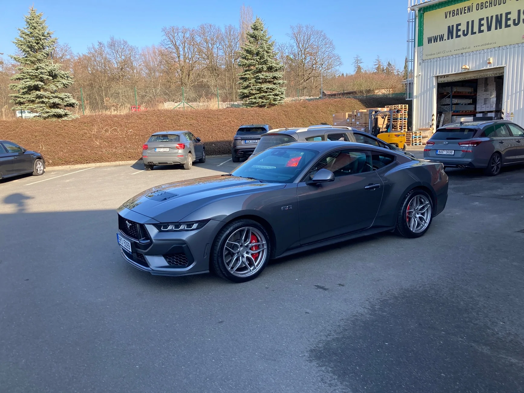

So, new wheels fitted and no problems with adaptive cruise control. It seems that the problem only occurs when the front wheels are larger in diameter than the stock ones.
