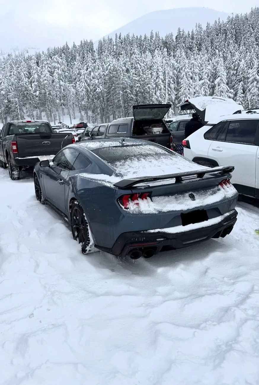

Pirelli sottozero winters worked great for me these past 2 seasons plus the car is a blast to drive in the snow. These new s650s were essentially built to go sub-8 around the nordschleiffe in blizzard conditions
S650 Mustang Winter tires? IMG_2398
