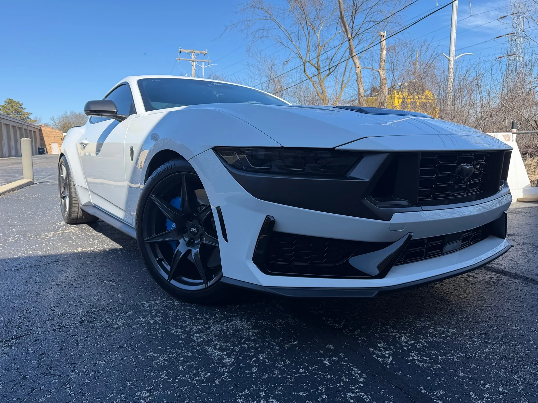

So it’s just when TC is off that your adaptive cruise isn’t working?
ChitownStang
Mar 9, 2015
1,325
1,253
Chicago, North Shore
2015 Mustang GT Premium
It’s either that or sport mode. I didn’t test that but can later possibly.

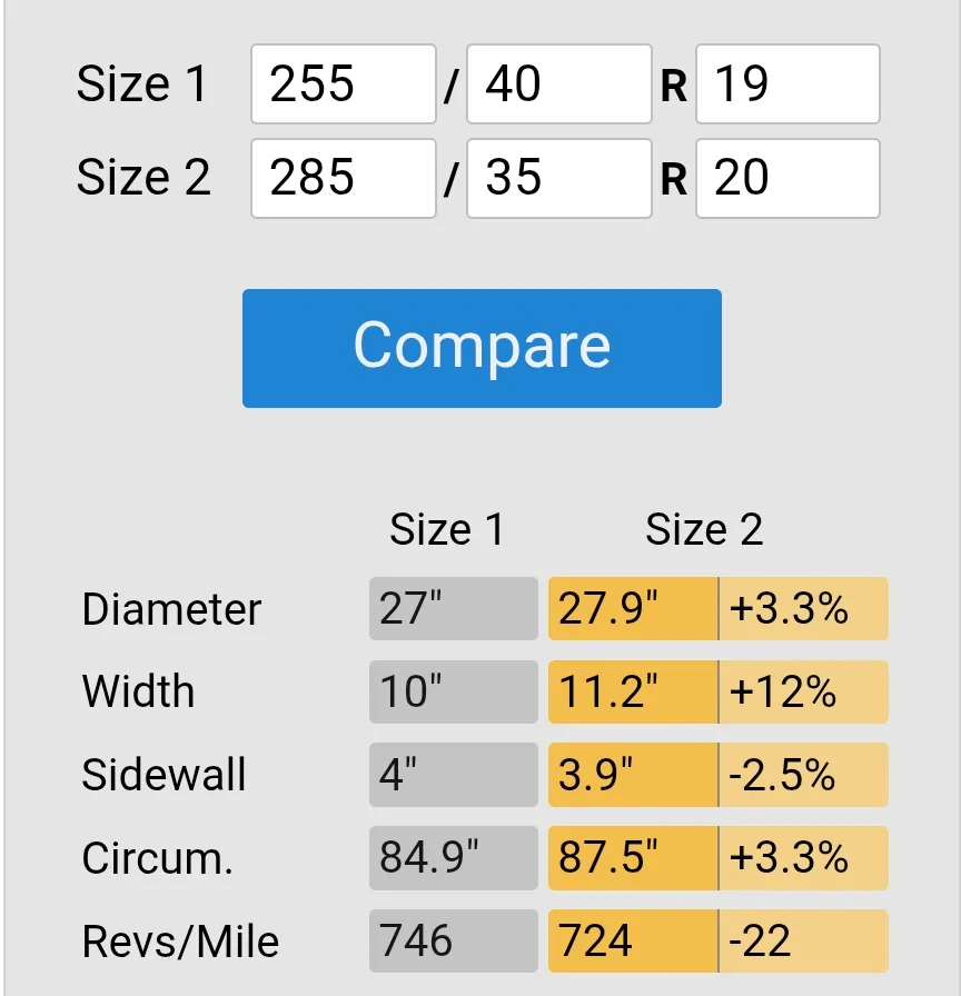

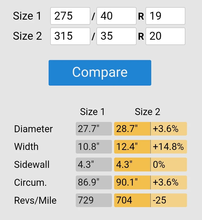

Could it be the angle the car sits at affect the forward facing adaptive cruise sensor? Perhaps if the car remains at the same angle (or within 1-2 degrees) post wheel/tyre change everything is fine… can someone work out using agreywolfe’s before and after diameters if there would have been any change?
That's quite possible. I don't know what the precise angle change would be, but the changes for both the front and rear sizes are reasonably close. There shouldn't be a large change in the angle.
S650 Mustang Taller Tires & Cruise Control 1000017805
S650 Mustang Taller Tires & Cruise Control 1000017806
