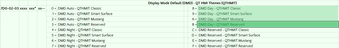

I see a couple of things of interest here. I pulled the config from a 2025 Mustang and these bits in the APIM stand out:
S650 Mustang SYNC Navigation Map - Night/Dark mode only 1779295225226-ii
3rd and 4th bits of the first block are C1. According to the spreadsheet:
S650 Mustang SYNC Navigation Map - Night/Dark mode only 1779295765068-88
S650 Mustang SYNC Navigation Map - Night/Dark mode only 1779295270258-x3
So these bits would need to be changed to 41 to enable DM night and day and keep everything else as it is:
S650 Mustang SYNC Navigation Map - Night/Dark mode only 1779295316818-wt
On that same line, the 4th bit of the second is a 6 which means display mode default is night. I would try change that to a 2 for DMD auto Mustang.
S650 Mustang SYNC Navigation Map - Night/Dark mode only 1779295563844-2q
So what I would try is:
7D0-02-03
xx4x xxx2 xxxx
Write the change, reboot the APIM and see what happens.
Edit: Confirmed that the APIM in my F150 that has it working from factory shows DM Night and Day and DMD auto enabled.

7D0-02-03
xx4x xxx2 xxxx
There is no asterix at the 3rd position of the 1st block where the 4 is supposed to go.
Can I just overwrite Ford's entry with a 4?

7D0-02-03
xx4x xxx2 xxxx
Yes. The X just means leave whatever is there as it is

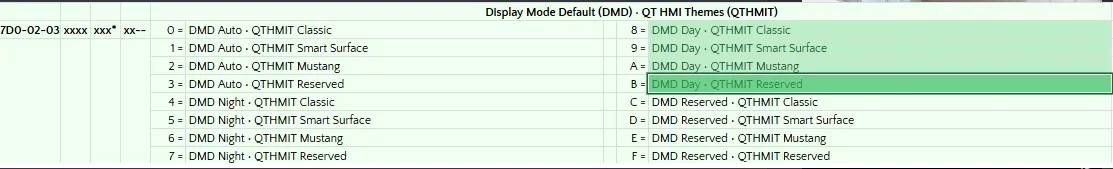

So 3rd and 4th bits of the first block need the 4 and 1, correct?

Just to report back with a feedback.
After the APIM changes I am now having the Display option Night - Day or Auto mode. But no matter what I pick the middle display stays in night mode. Have twice done a master reset, again no change.
Could there be another APIM entry which needs to be changed in addition to 7D0-02-03?
I'll dig through the spreadsheet to see if I see anything else related to this.
rugedraw
Apr 17, 2024
476
594
Miami, FL
I don't see anything else in the APIM or IPC that corrolates to this. Not to say there isn't anything else, but I went cross-eyed looking at every feature code on the spreadsheet and I didn't see anything.
I asked one of the gurus on the F150 forum and he said a lot of these things are defined by the vehicle type itself, so it may not work. With that said, I would try changing this value to something other than a Mustang to see what happens. My F150 shows a 1 there and I have the unreal theme enabled in the APIM so I have HVAC controls on the touchscreen like these cars do, so it's worth a shot. Maybe try a 0 for "classic" which I am not sure what that is, but if Smart Surface doesn't display properly, you could try that, too. If this doesn't work, then I am out of ideas.
S650 Mustang SYNC Navigation Map - Night/Dark mode only 1779902466872-0
Edit: Making this change may cause a loss of many Mustang specific features in the APIM. Even if you gain the day/night mode feature, you may lose other things. It can easily be changed back if you don't get the desired result.

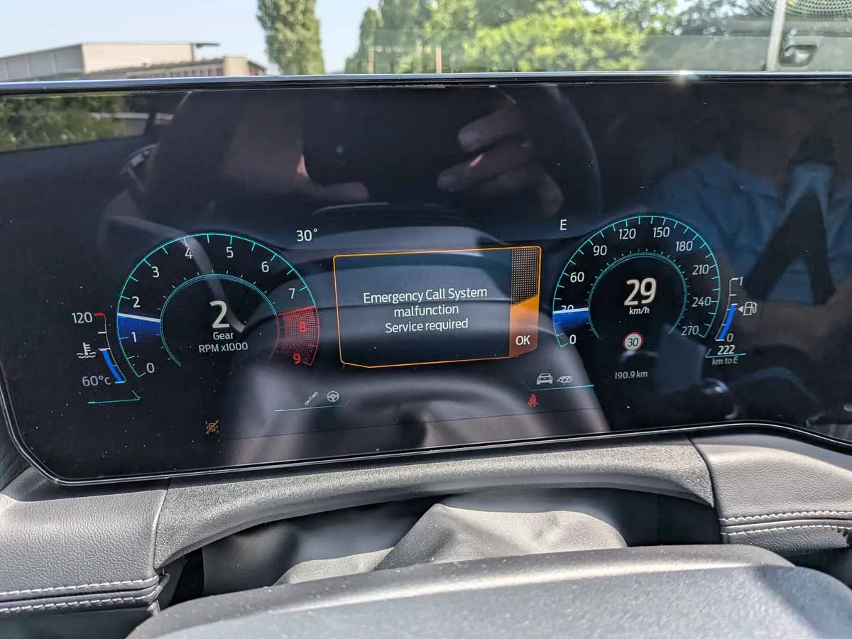

As it has transpired Ford did away with that Day - Night - Auto option in the Sync4 menu for all the Mustangs. Strange and unnecessary but that's how it is.
On another note my car shows an error message at every start (see pic).
I don't need that crap and I am sure that emergency call feature can also be disabled using ForScan.
Sorry for bothering you again but maybe you know which module and the code to have it permanently disabled.
Thanks, Roland
