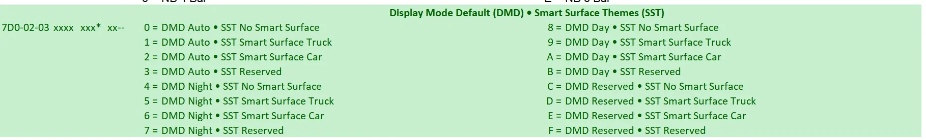

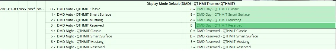

So what's the difference between SST and QTMIT Display mode Defaults?

Just for clarity:
Thank you rugedraw.
But have a look at my car's APIM DMD options.
There is no specific code for a Mustang like in your APIM. Maybe it's because m car is MY26 but at the same time Sync4 is Sync4 und older versions get constantly updated. Who knows.
Looks like I'll have to try with 1 = Smart Surface Truck, correct?
Just for clarity:
Same thing; different verbiage. Once you make the change, you will need to go to the wrench icon and reboot the APIM for the change to take effect.
SST is smart surface theme. Not sure about the other one.
