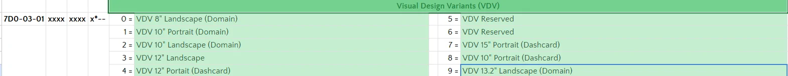

I have an idea. I don't have a Mustang that I can change the APIM to an F150, but I have an F150 I can change into a Mustang. 🤣
Stand by. Firing up my laptop now.
rugedraw
Apr 17, 2024
488
619
Miami, FL
Ok, so I changed it from smart surface to mustang. The screen didn't render correctly due to the difference in screen size. So in this first video, I was not able to get into the display settings to change it from light to dark, so I say in the video that it won't work on the Mustang.
In this second video, I changed the VDV settings to get the screen to render right. I was able to navigate to the display settings and change it from day to night to auto, but the screen stayed in day mode. So at the end, I say that it cannot be done with the APIM set to Mustang.
However, when I changed the VDV back to what my truck is supposed to be, I messed it with a bit more while the APIM was still set to Mustang and viola! It allowed me to change it from day to night and to auto with the APIM still set to a Mustang.
So, in conclusion: Idk WTF is going on. lol I can change it between light and dark with the APIM set to be a Mustang with the screen rendering incorrectly. But, if I change the VDV so the screen renders somewhat correctly, it stays in day mode.
I can't tell if we are closer or further away from seing if this will work or not, but I still think it is worth changing the APIM from Mustang to Smart Surface and see what happens. There is only one VDV setting for a 13.2" screen, so if it does not render properly when set to Smart Surface, then I don't see a way to fix the rendering.

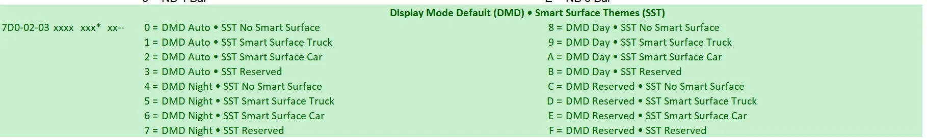

Thank you rugedraw.
But have a look at my car's APIM DMD options.
There is no specific code for a Mustang like in your APIM. Maybe it's because m car is MY26 but at the same time Sync4 is Sync4 und older versions get constantly updated. Who knows.
Looks like I'll have to try with 1 = Smart Surface Truck, correct?
