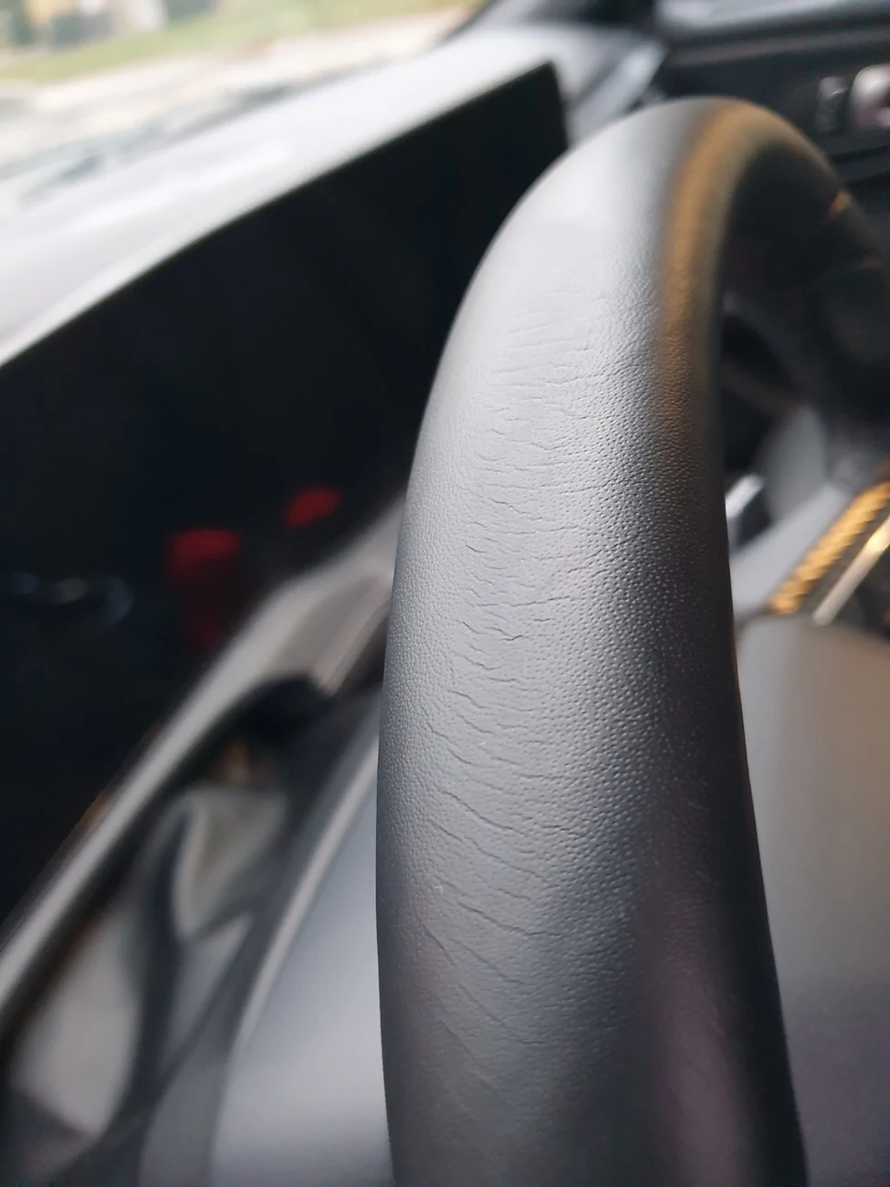

Update:
Thanks for all replays, they helped me a lot. I have booked a warranty visit at the local Ford dealership the 25th this month about the two above errends (brake noise and pedal noise)
I have also included a new errend that is a wrinkled steering wheel, see attached picture.
I will post an update on how it went!

Brake pedal sounds like it needs a lube.
Brakes sound like they are binding. but if they are squeaking at a stop, either the pads or rotors are glazed or you just need new pads.
If you get your rotors cut that should stop the sound, unless it's the pads.
Steering wheel: try applying a leather conditioner.
that's all I got...

I'll suggest that the brake noise is normal, that's just the sound that performance pads make when engaging and releasing. The pedal noise is different, not normal, but probably not something that I'd worry about. A quick shot of some lubricant at the pivot point might take care of it.
I don't know how things are in Sweden, but here in America warranty claims for things like this are often hard to get resolved. With the steering wheel, I'd also not have much hope of getting a positive response to that either, they'll probably blame the cow.
Best of luck!

Hi all,
Sorry for the late update, finally went to the ford dealer.
Conclusion:
* Brade pedal making a swoosh-sound is not a warranty matter.
* Brakepads squeaking is not a warranty matter.
* the tearing at the steering wheel (see post nr5) IS A WARRANTY MATTER.
They will replace the steering wheen in april 2026.
