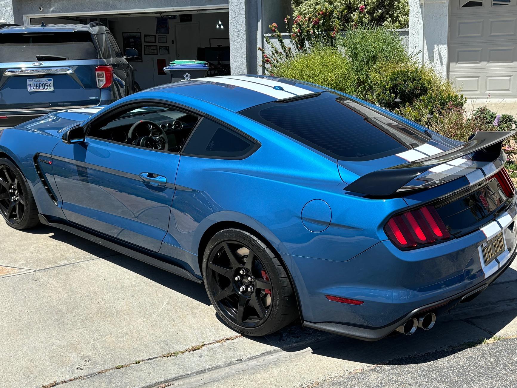

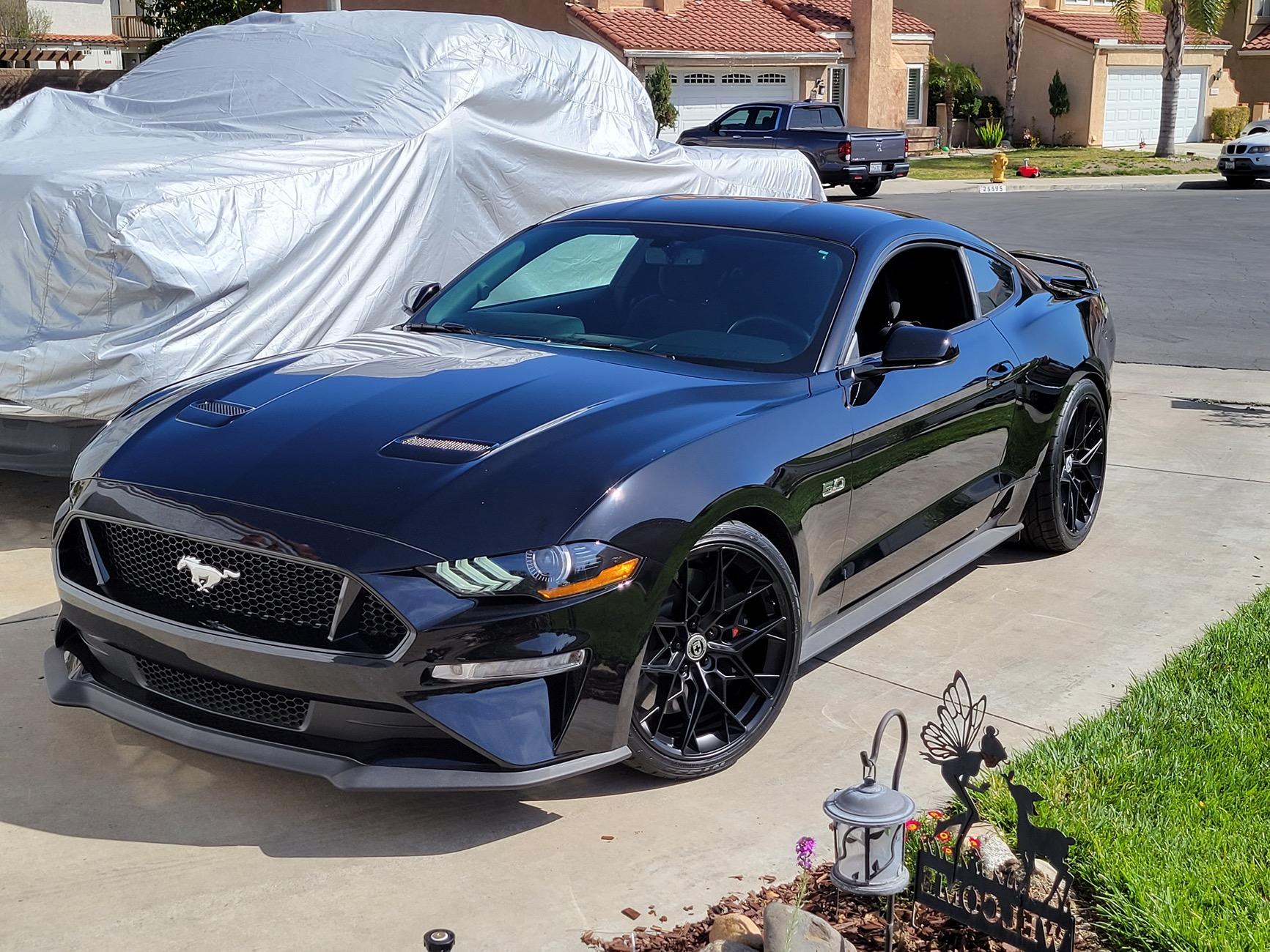

I have staggered but with 305s up front and 315s in the bsckand a sticky tire and my car tram lines like a &()&;;
on my S550 I did staggered with a 285 up front and no tram lining at all…
