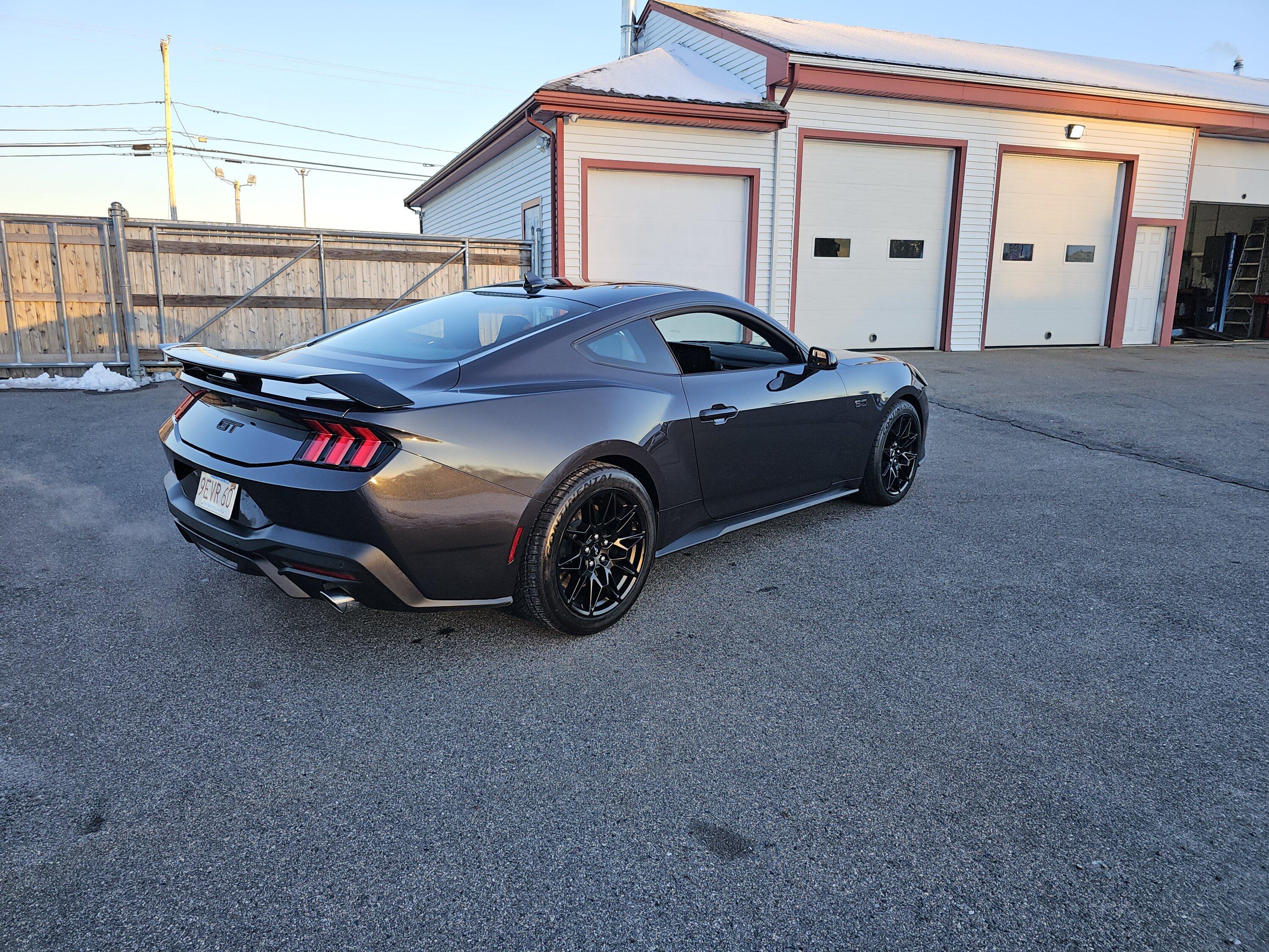

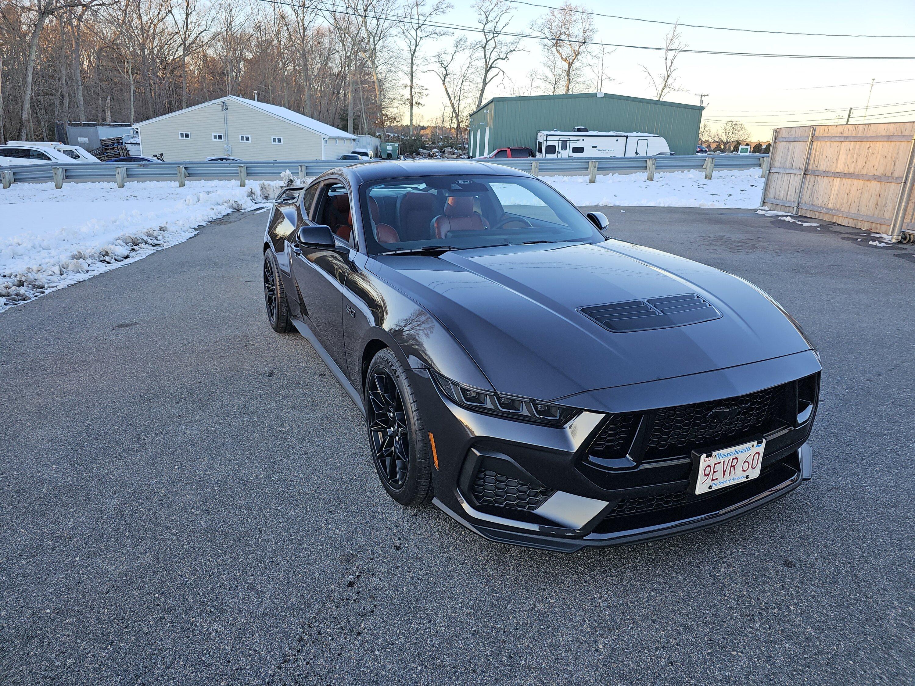

Confirmed, 25mm spacers fit on a PP with Magnaride. S650 PP wheels have a pocket that fits over the exposed studs.
S650 Mustang Spacers for Magneride 20240121_162517
S650 Mustang Spacers for Magneride 20240121_162600
Awesome!!! Can you take a pic from the rear so I can see how far out the rears are pushed? Also, what spacers did you get?
