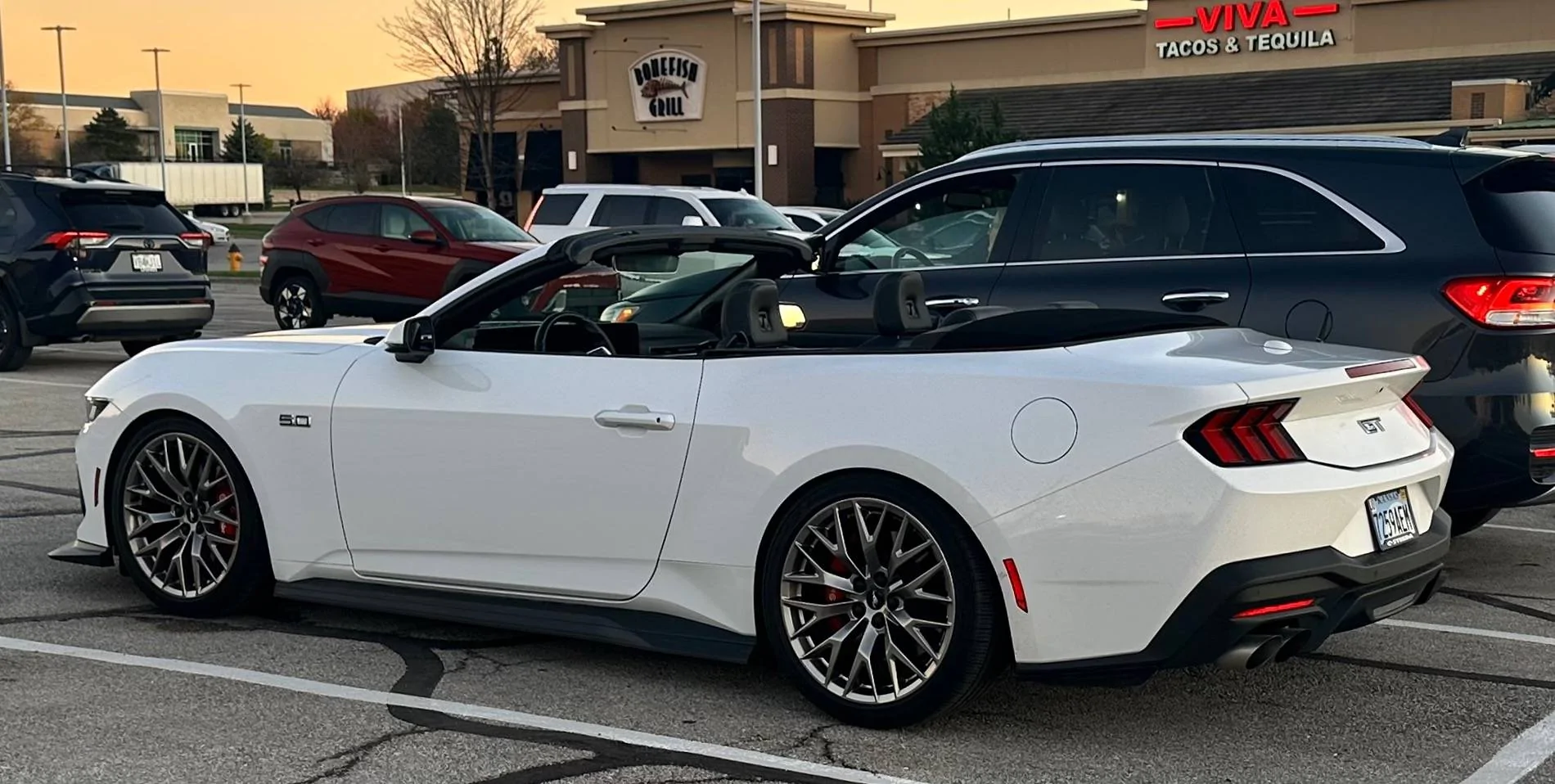

Would appreciate some input. S650 vert on Steeda progressive springs. Love it but ended up lower than expected. Did 1” spacers with the 20x9 optional wheels.
Was assured by the FB groups 1” fits, but rubbed bad in the front…where the plastic bumper meets, rolled a bit but not even close.
Don’t want to trim studs for 20mm (I hear differing stories on whether it’s required). Interested if anyone with a vert has input. Pic is w/rears on and stock front.

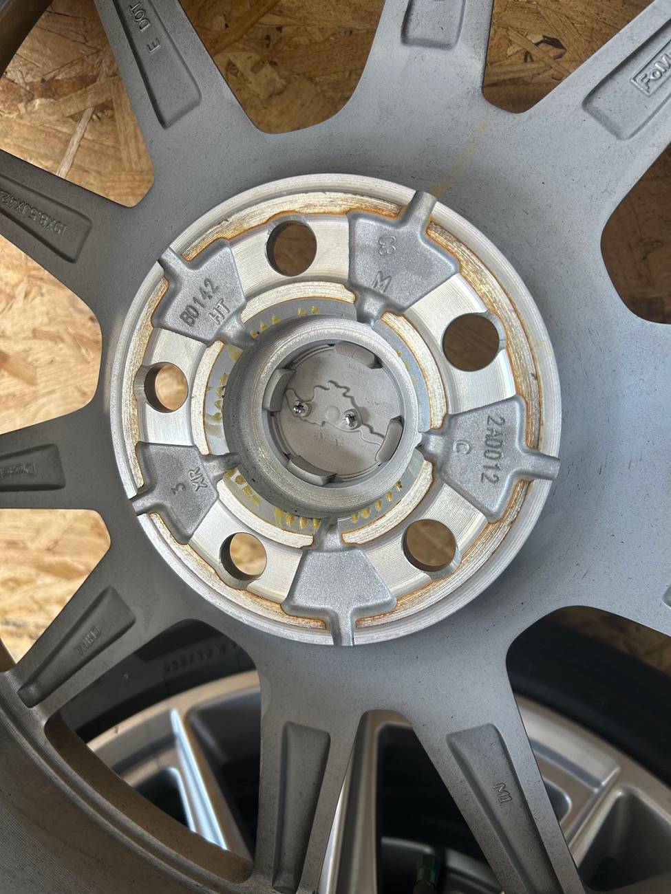

I just tried 25mm spacers on my 2025 GT with PP. I have a set of new take-off 19" gt silver wheels with All season tires. I could not use them as the studs were too long and dug into the back of the reliefs on the wheels. I did some measuring and it will take about 3mm of grinding to make the 25mmm spacers work for me.

I got the tire wheel set because I didn't want to wait 4 months to drive my brand new car (summer only PP tires) I got them because of the all season tires. I am telling everyone that my 2025 wheel studs must be longer than the 2024 studs and not to assume 25mm spacers will fit without grinding on the 2025.

I bought a set of non PP wheels for winter. there are gouges in the reliefs from studs bottoming and they never seated on the rotor face. They may have changed suppliers. The 30mm may be to the end of the last complete thread. I don't know. Just sharing to save someone else the hassle.

If it’s these rims, it’s not because you have longer studs, it’s because the relief in the back of the rim is only 4mm, at best. 25mm spacers will not work using these rims without taking off 1-2mm of the studs.
Those are what I have.
