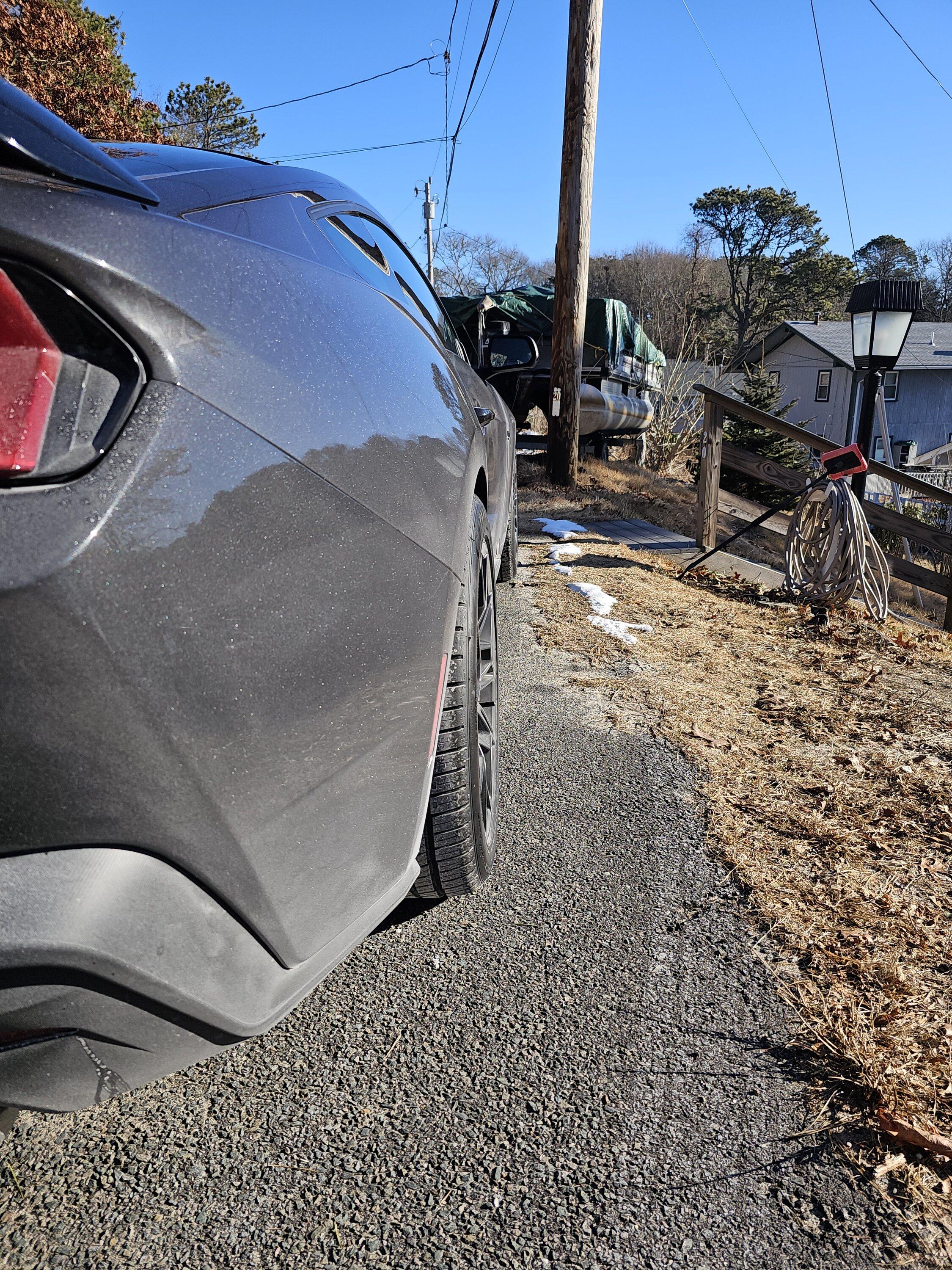

Just a heads for everyone. I’ve seen where some people say you can run 20mm spacers on a magneride car and they’ve had no issues. If this is you then you should check them again. Just installed H&R supersports and steeda 20mm spacers and at first it looked flush. Spent a lot of time getting different angles and can 100% confirm 20mm do NOT work, it’s hard AF to see. Most angles it looks flush. I know most are running 25mm, but I’m case anyone thinks you can do 20mm, you can’t.

kinda of the same thing. If wheels don't sit flush with the hub, it's not going to work. But you 100% need to trim the studs.

Confirmed, 25mm spacers fit on a PP with Magnaride. S650 PP wheels have a pocket that fits over the exposed studs.
