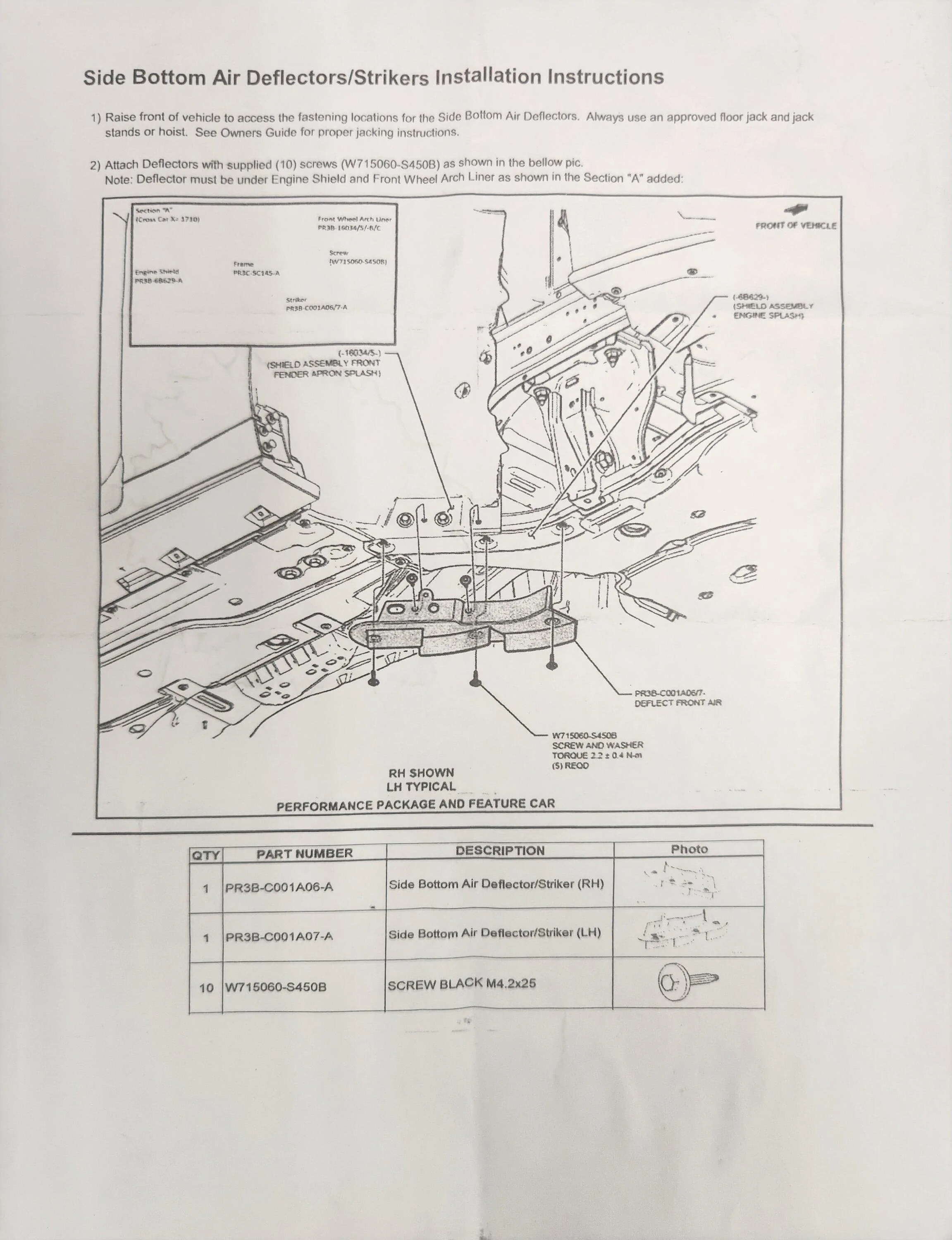

So I asked my dealer if they could install the underbody strakes and they said nobody in the service department knows how to 🤡
The directions are in the fricken bag! They are stupid and lazy
S650 Mustang Side Bottom Air Deflectors/Strikers 20230920_175654
And then you have to question how competent they would be with normal service work. :lipssealed:
