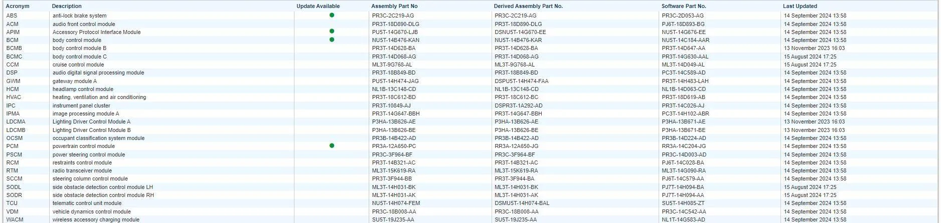

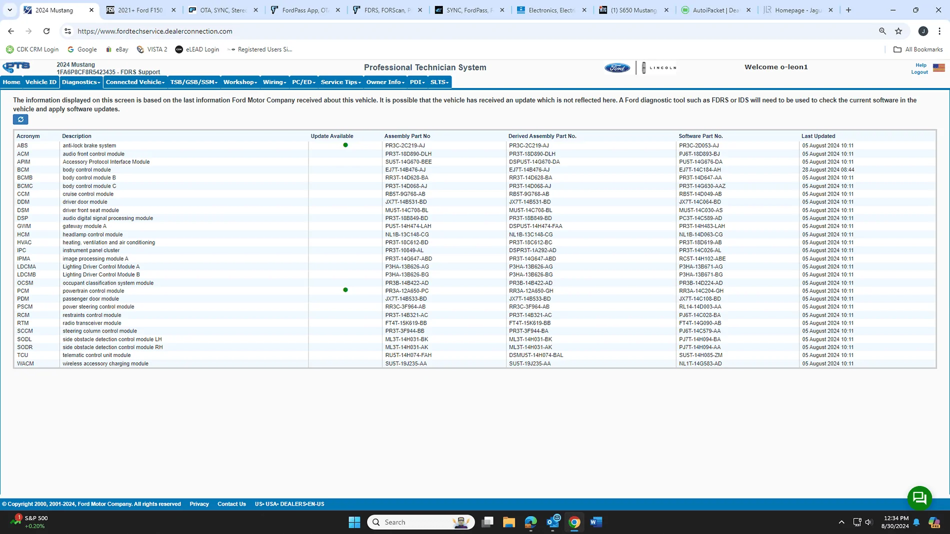

Modules with pending updates for you are below; not much showing. I'm pretty sure Sync 23291/23306 are the latest versions for these cars. Difference between one and the other version may have to do with job 1 and job 2 production, but not entirely sure. You do not show any pending APIM updates, so you must be on the latest version. OTA history is recorded in PTS for 60 days at a time, so I am not able to see every OTA you've ever gotten.
S650 Mustang S650 Mustang OTA History Thread 1725035785897-z

Pure coincidence, but glad to hear. I did get my access back and I see you got 6.3.1 on 9/14 and 6.3.2 yesterday. Only a few more updates pending as shown below. It shows you have an APIM update pending, but that is not accurate. Your car didn't report itself back to the server after the APIM update yesterday, so it is still showing you have one pending, but you do not. What Sync version does your car say it is on now?
S650 Mustang S650 Mustang OTA History Thread 1726667469551-x9
