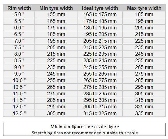

I'm aware of this chart, but I was hoping to hear from some owners who drive these in the winter and their experience.

Well the PP wheels are 9" front and 9.5" rear. I don't think 245' would be a good idea on a 9" wheel.
I would find a set of GT Premium take off wheels. Those are 8.5" wide (square) and can be found online for cheap. Put 245 winter tires on those and just use them as your winter set up.
