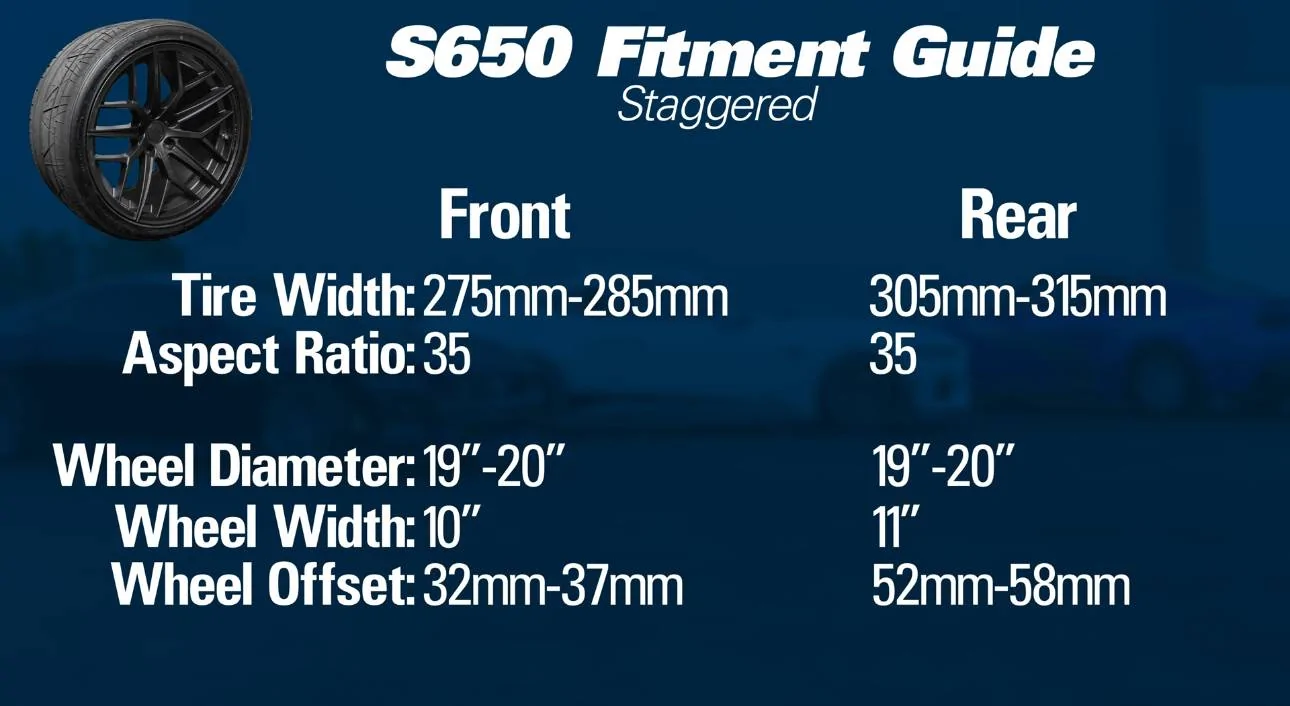

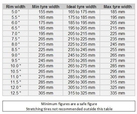

I’m kinda new to the staggered setups and I don’t want to make a mistake when getting new tires. How aggressive can I go on my tire size. I kinda want to keep the stock rims so probably 19 but can I go up to like 305 without rubbing or is that too aggressive and I would need to size down in my rim. Please help

You don't really want to go any bigger than stock sizes on the stock wheels
You want an 11" wide wheel for a 305

Would a 19 be too big if i went with an 11 wide

If you stayed with a 40% sidewall on a 305 you'd be raising the gearing quite a bit. Might need to go to 35%.

You never said what width rims you currently have. For reference, on my DH, I'm running 275/40 on front 9.5 in rim and 305/35 on rear 10 in rims. All within tire manufacturer specs. If I was buying new rear rims, I would have gone wider and at least run 315s.

I'm running 19x10 on the front (285/30/19) and 19x11 on the rear (325/30/19) with the Ford Performance Track lowering springs and have zero rubbing. You will be good!
