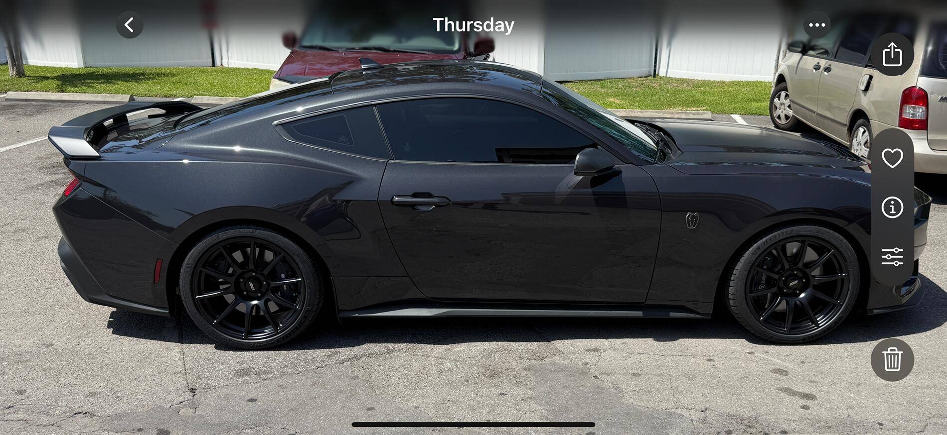

Do you have pics? A non-HP DH with that tire setup would have a huge wheel gap. Unless you lowered it
I can get them later when I’m home but it has steeda suspension work (dual rate handling springs, camber plates, etc) so it is lower.
Here is a pic. Don’t know if I did that right on mobile or not.
