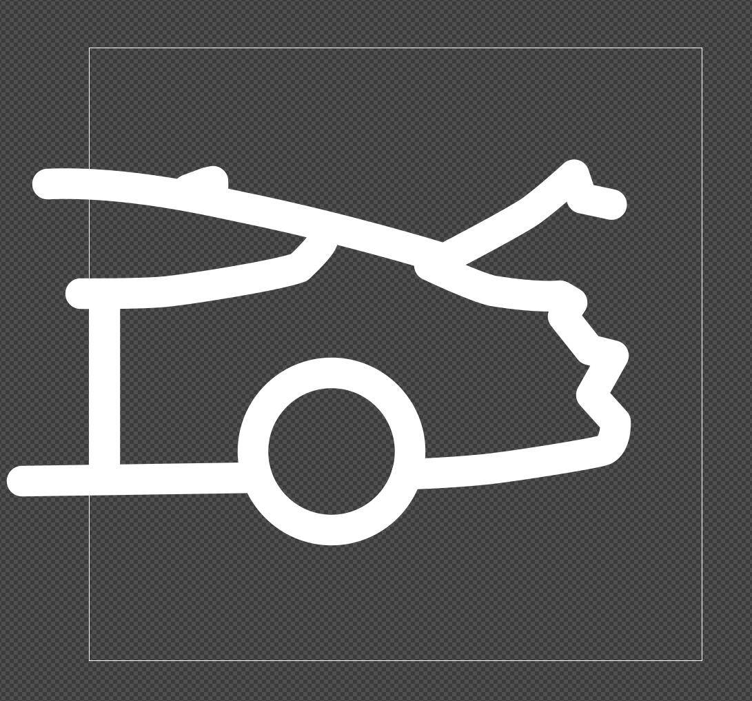

making OEM-style icons for the buttons now. it looks like Ford usually constrains icons to a 10x10mm domain, and uses 0.5mm strokes, really only doing outlines. sometimes they fill things in too. here is my attempt at a trunk release icon. made using Inkscape.

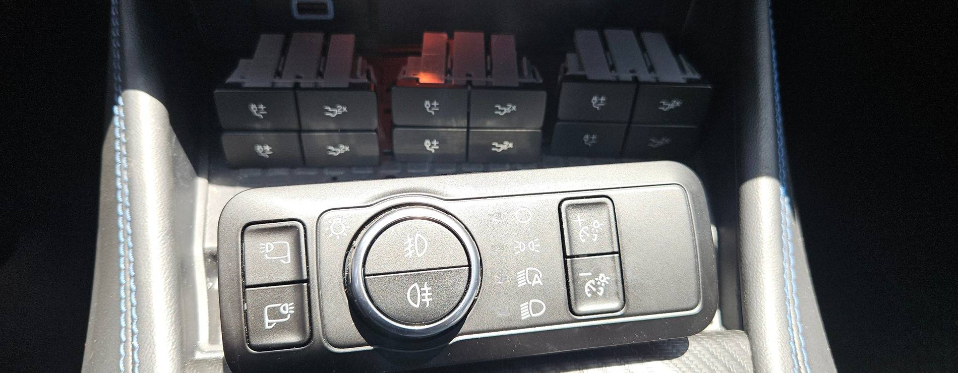

6 of 7 buttons and 1 of 2 headlamp switches are here
S650 Mustang roket's Dark Horse - "Azureus" Project 1748545951387-sv
holding that many buttons feels weird, almost illegal. also, the upper-left button on the headlamp switch still pops the trunk

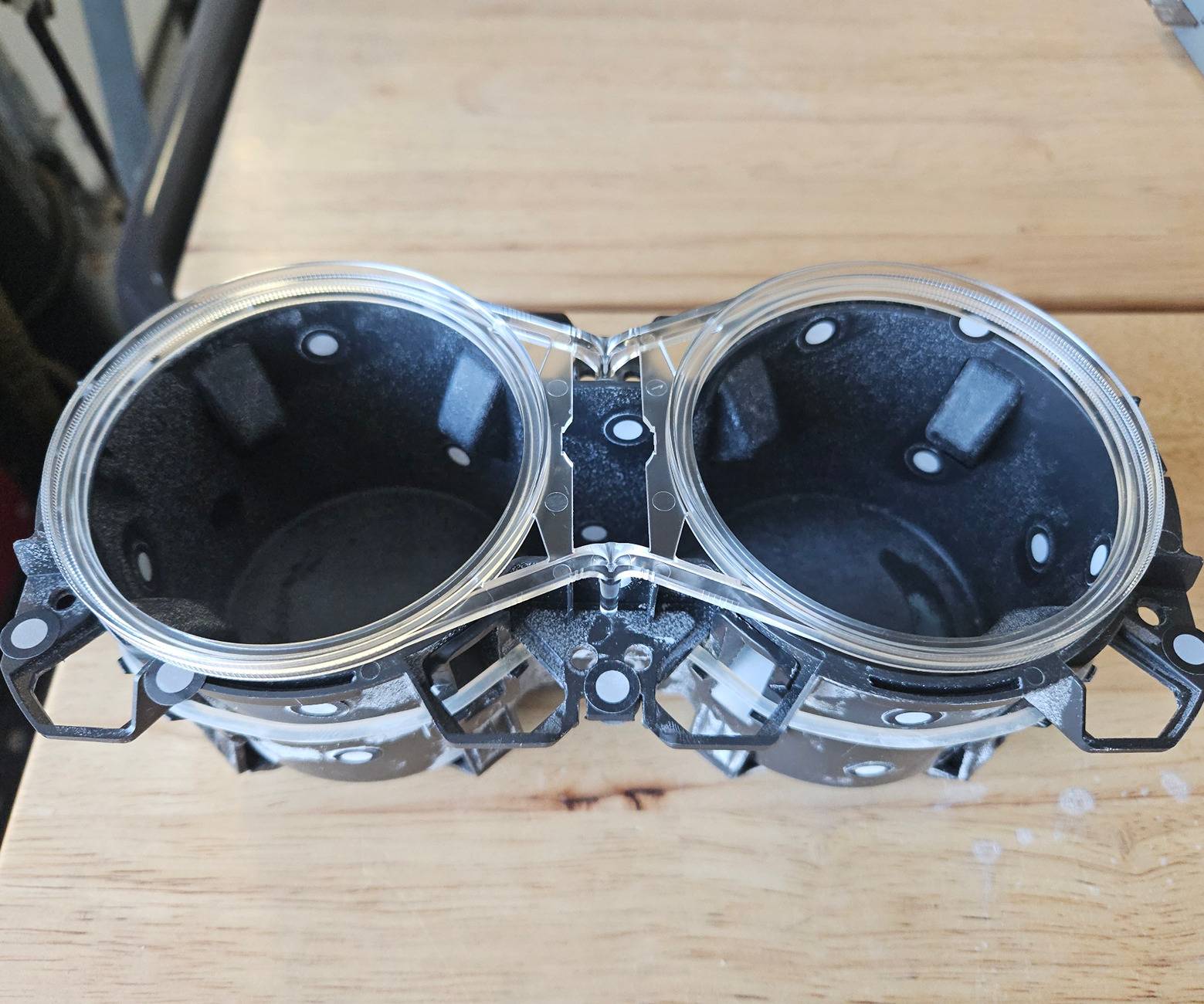

got the 7th button today. also good news on the cupholder front: i got the new lighting rings look like they are roughly the right shape! this will likely be good to model a cupholder for

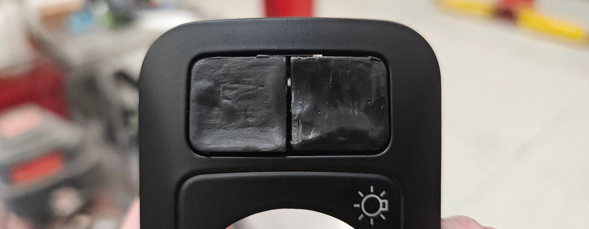

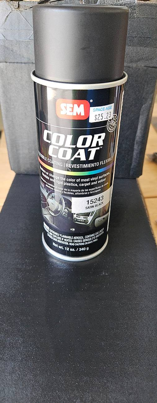

i went to Home Depot to buy some of that Baer Black in spray paint form, but satin was too glossy and matte was too dull. i also tried Sherwin-Williams but they had nothing to help me. i then went to Space Age Auto Paint 40 min away and was fully prepared to spend a pretty penny to have a custom mix made and put in a spray can (which is something they can do, and do every day). turns out, though, that there is already a color that someone made that is an exact match!
S650 Mustang roket's Dark Horse - "Azureus" Project 1748714919453-4r

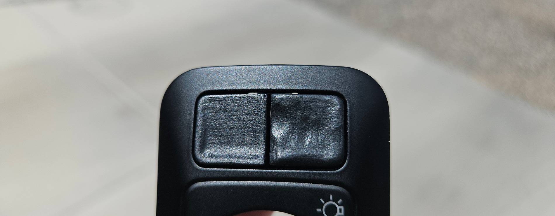

both buttons are painted, and the surround is not. it is so incredibly similar that i am happy with it. the spray paint in question is "SEM 15243 Satin Black". it was rather expensive at just over $25 for a single can, but it ended up being worth it.
S650 Mustang roket's Dark Horse - "Azureus" Project 1748715111770-pr
