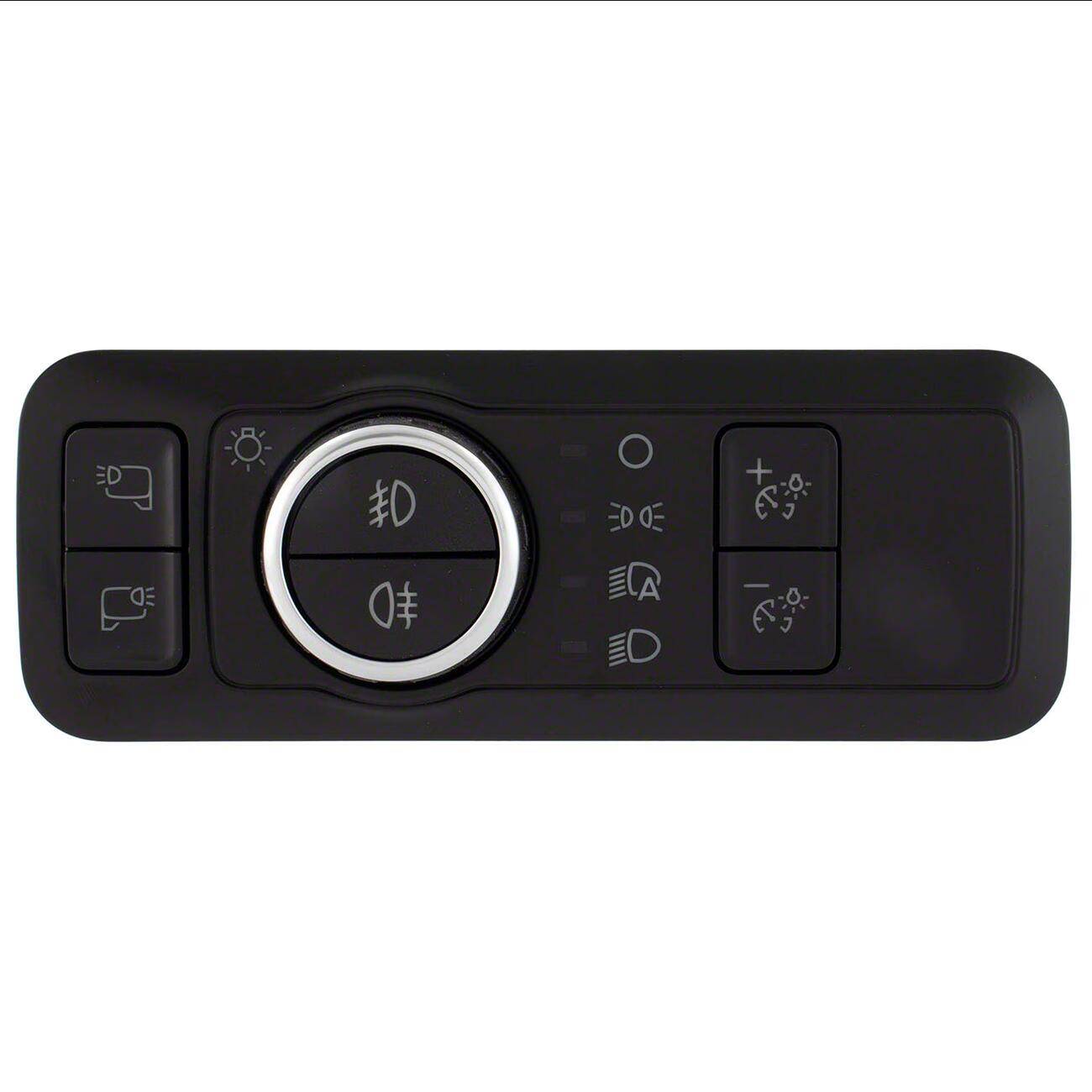

i think im bordering on too many ideas at once, but i got a 3D scan of a few other things, and i had an idea for a custom headlamp switch to control a bunch of stuff.
i could put together a switch with 6 total buttons by combining the faceplate and left and right button clusters from specifically a 2025 F-150 PowerBoost, along with the rotating switch from an overseas Bronco or an Explorer Timberline. here's my thought process
for the PowerBoost part, it has to be specifically that because for 2025 Ford consolidated the mirror zone lighting to the headlamp switch on the right side; an area previously only used for the Mach-E traction control and overseas for headlamp leveling. this means that it has two buttons on either side.

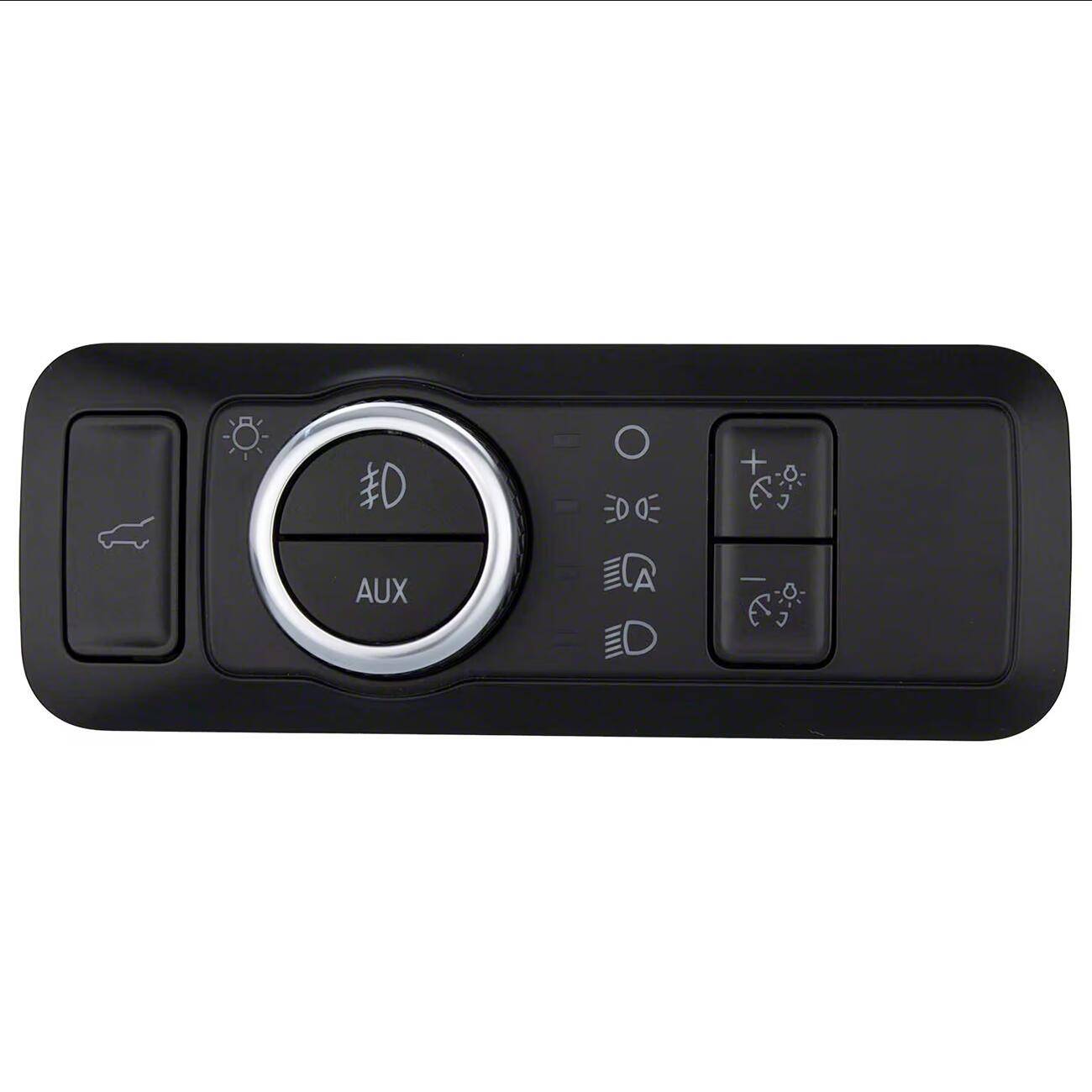

for the Bronco part, this is thanks to european vehicles needing rear fog lights, but the Bronco also having front fogs, creating this switch.
S650 Mustang roket's Dark Horse - "Azureus" Project 1748221830491-p8

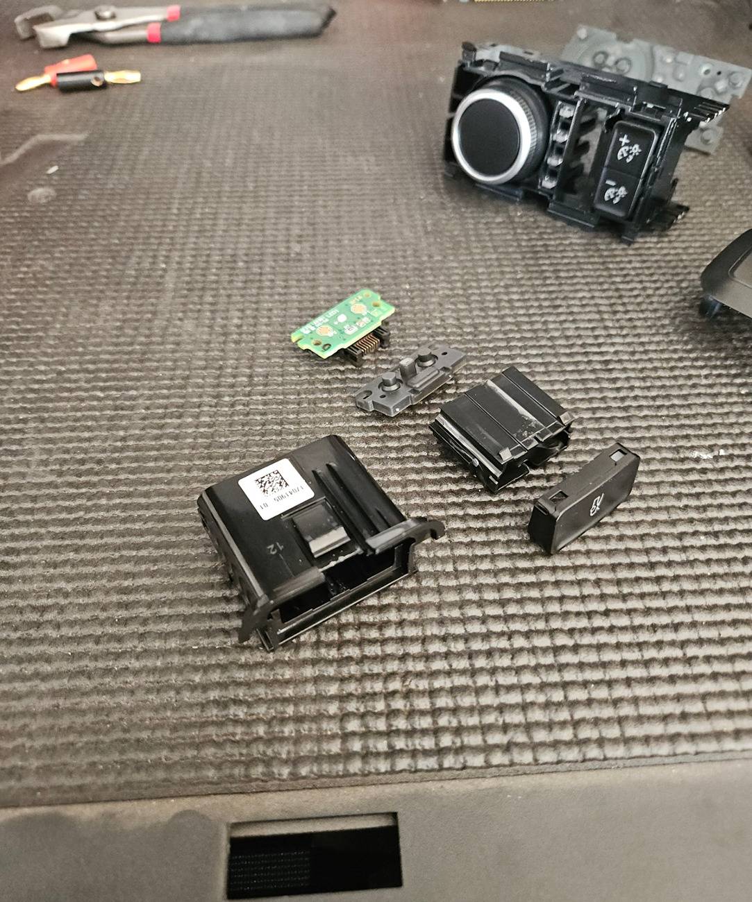

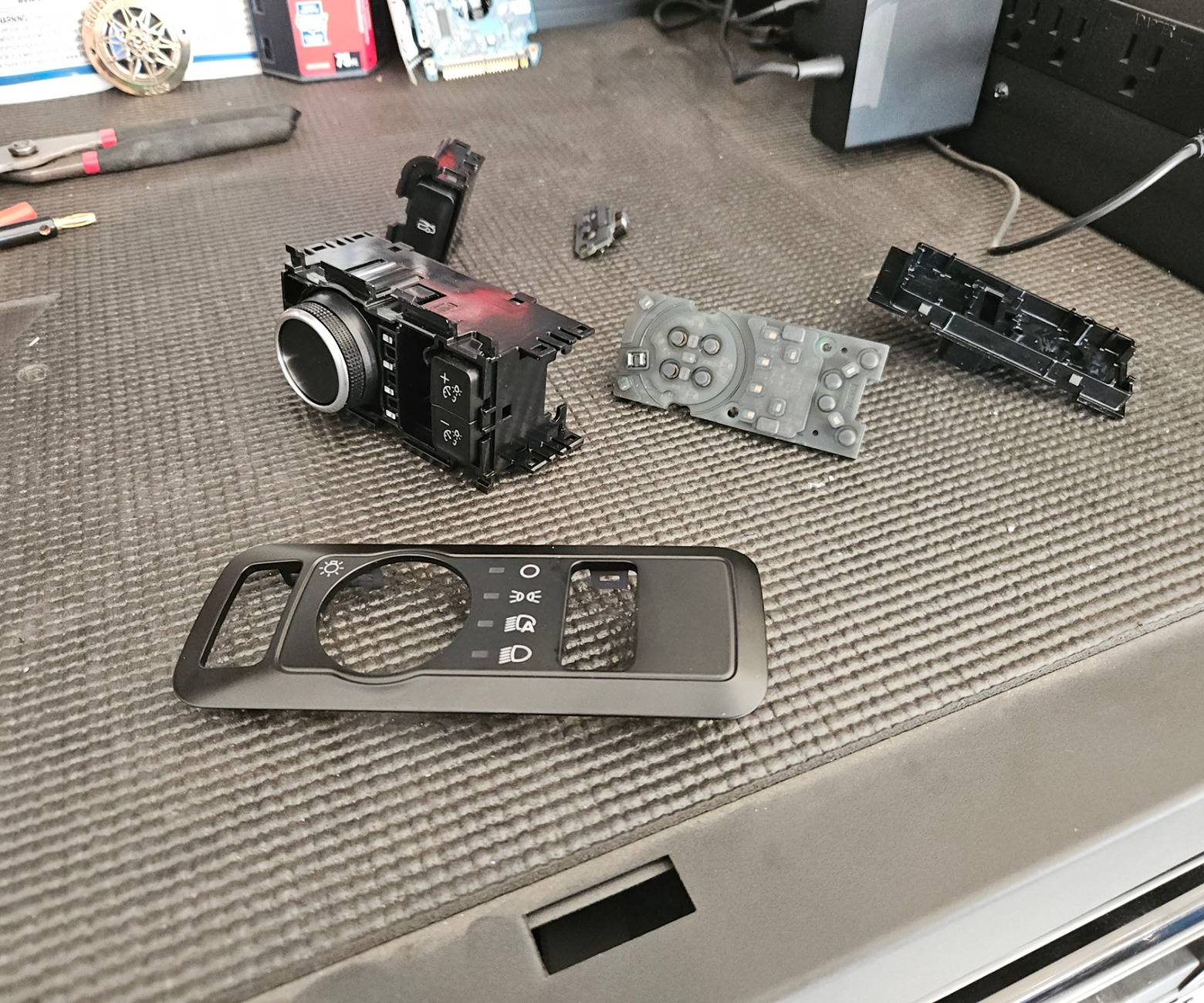

a teardown reveals that this will likely work. they are modular, and the buttons are the membrane style ones

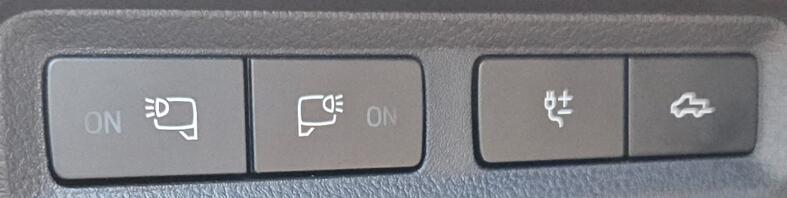

i have decided to go all-out on the extra buttons thing. i will be doing an overhead sunglasses holder delete as well so i can fit 5 of those double buttons from the F-series trucks.
S650 Mustang roket's Dark Horse - "Azureus" Project 1748370663247-h
i got the ones without the "ON" text. this means i will have 15 total buttons to do whatever i want with
