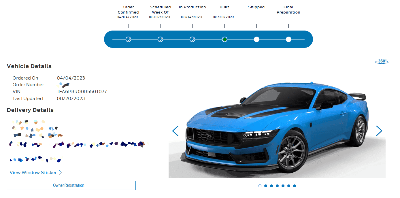

new update: it's finished! the order tracker doesn't say "Built" but OASIS gives the details, which only happens once it's done

tracker finally shows "built". also been thinking about the possible idea of making custom fenders and a wing, but again just an idea at this point

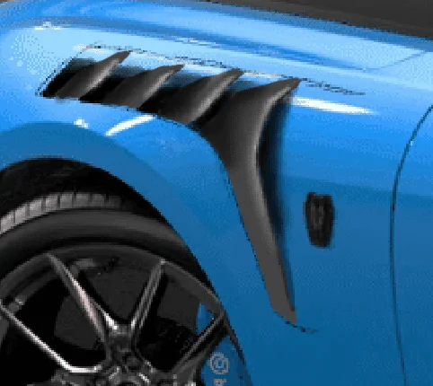

V1 of the fender idea, pretty heavily inspired by the GTD

1000 bucks says the aftermarket is going to be pumping out GTD-style front fenders, unless you're intentionally going bespoke on principle
2,714
4,118
you're probably right. if there is one released that i like the design of i might go for it, if not i'll give a shot at making it myself. in any case, it's still up in the air if i'll actually do any of this or not

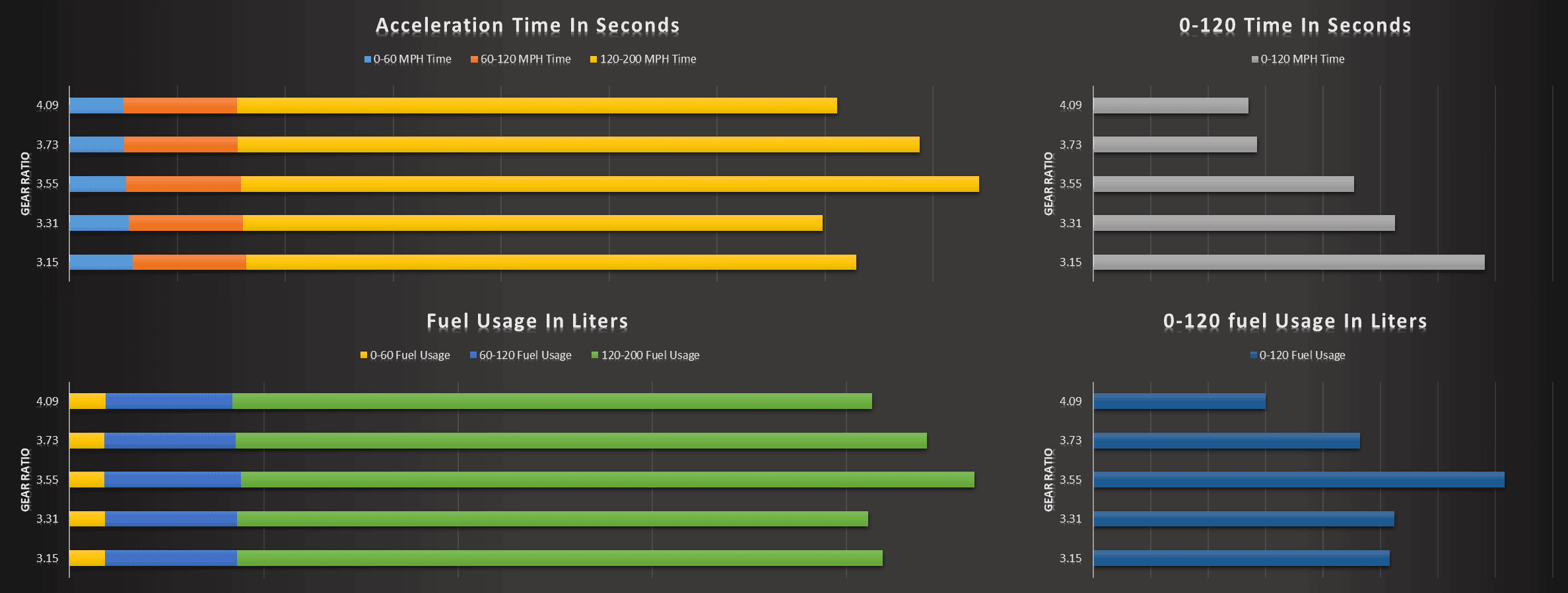

very sorry for the late reply. yes, i will be able to re-tune it (i actually made a tool for that here). it will be a daily driver, but there is a reason why i am considering the 3.73. i used a program called Engine Simulator to take a re-creation of the Gen 4 5.0L V8 paired with a 10R80 and did 5 0-200mph runs for 3.15, 3.13, 3.55, 3.73, and 4.09 diff ratios. here are my results from the tests
For Time0-600-1200-20060-120120-200
3.155th5th3rd2nd3rd
3.314th4th1st3rd1st
3.553rd3rd5th5th5th
3.732nd2nd4th1st4th
4.091st1st2nd4th2nd
For Fuel0-600-1200-20060-120120-200
3.153rd3rd3rd4th3rd
3.314th4th1st3rd1st
3.552nd5th5th5th5th
3.731st2nd4th2nd4th
4.095th1st2nd1st2nd
Average3.153.313.553.754.09
Placing3.42.64.32.62.1
S650 Mustang roket's Dark Horse - "Azureus" Project 1692738347952
the 3.73 isn't perfect, but does well overall in performance and fuel economy, especially in daily driving tasks, and is much better at everything than the 3.55 it comes with from factory
3.155th5th3rd2nd3rd
3.314th4th1st3rd1st
3.553rd3rd5th5th5th
3.732nd2nd4th1st4th
4.091st1st2nd4th2nd
3.153rd3rd3rd4th3rd
3.314th4th1st3rd1st
3.552nd5th5th5th5th
3.731st2nd4th2nd4th
4.095th1st2nd1st2nd
Any chance you have the ratios for gears 1-3?
