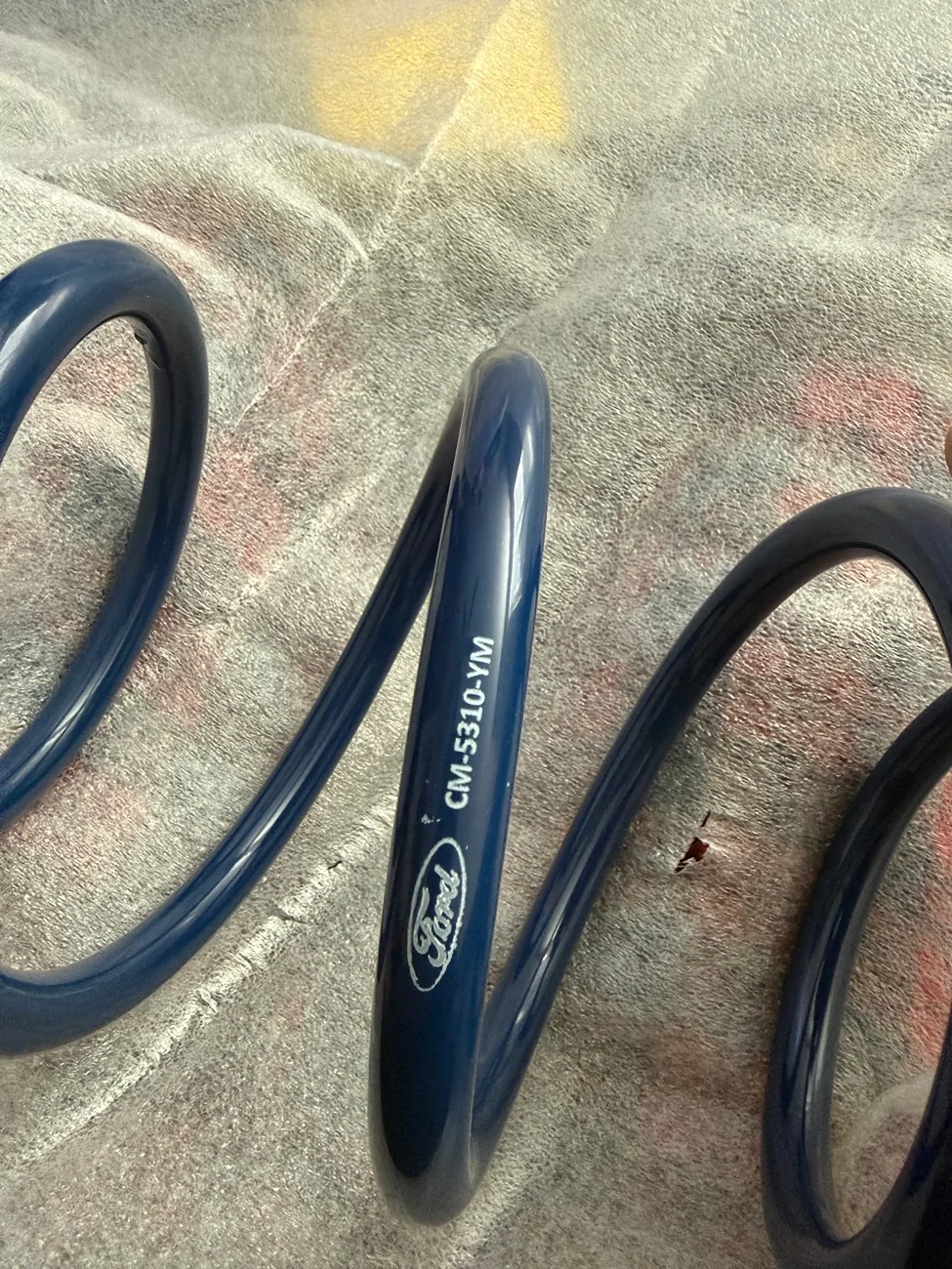

If you look at this photo take note of the tight side being up and the loose side being down. It looks like my springs were installed opposite of each other one has the tight side up and the other tight side down. That’s what makes it look funny like this .
looking back i think your exactly right. one is upside down

Maybe the spring rates are different? Something looks wrong because of the apparent coil binding with the car not even moving. Never seen a spring setup like that on a street car.
The springs are installed wrong. One will have to be flipped

That won't change the coil binding.
Boss I’m not sure how else to explain it to you lol. I’m not sure where the communication gap is coming from. I have shown photos talked to the shop talked to another member who has the same springs they all say the exact same thing. One spring is right side up and the other spring isn’t. It’s really simple..

Someone stuffed up. Springs should be installed symetrically. Perhaps when they fix it they'll double check those insulators
