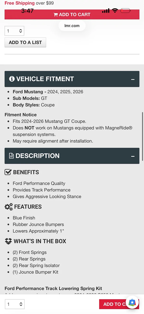

Searching that P/N and this is what I find:
The CM-5560-YA part number refers to Ford Performance Rear Track Lowering Springs designed for 2015-2023 Mustang GT and EcoBoost Fastback models with Independent Rear Suspension (IRS), providing about a 1-inch drop for aggressive stance and improved handling, but not for MagneRide equipped vehicles, and often paired with Ford Performance shocks/struts for optimal results.
Did you verify it's the correct P/N?

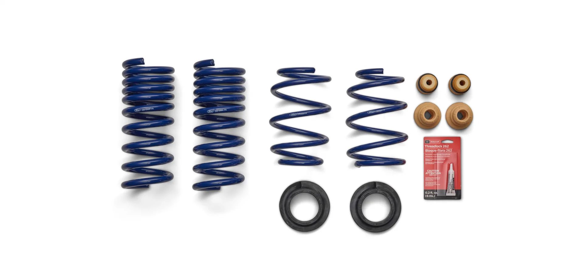

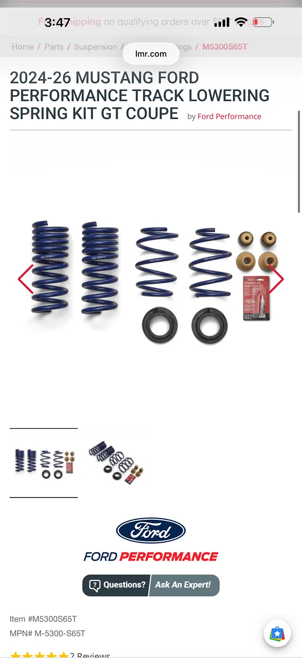

Direct from ford performance site for 2024-2026 mustang gt’s this is what I ordered. Which spring looks like it’s binding? Repost the photo

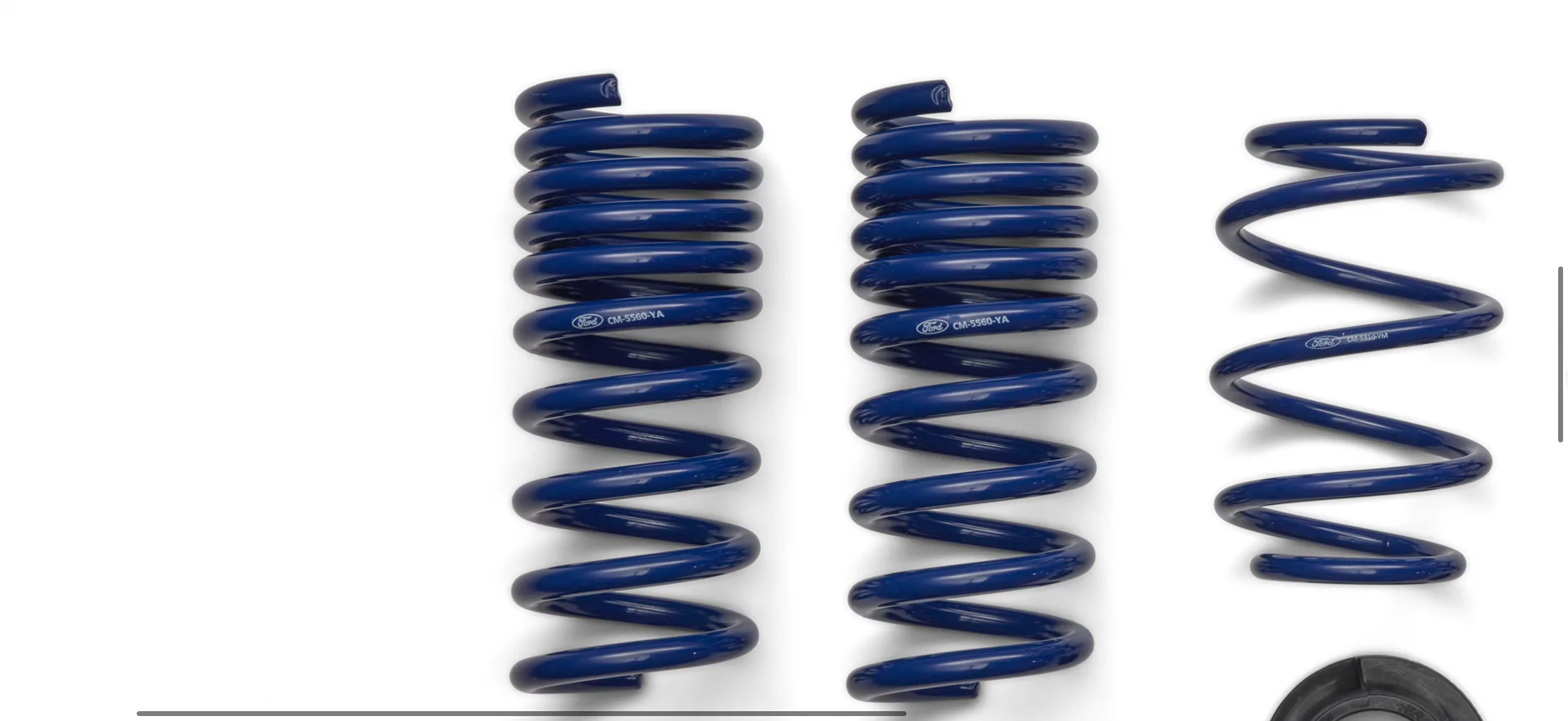

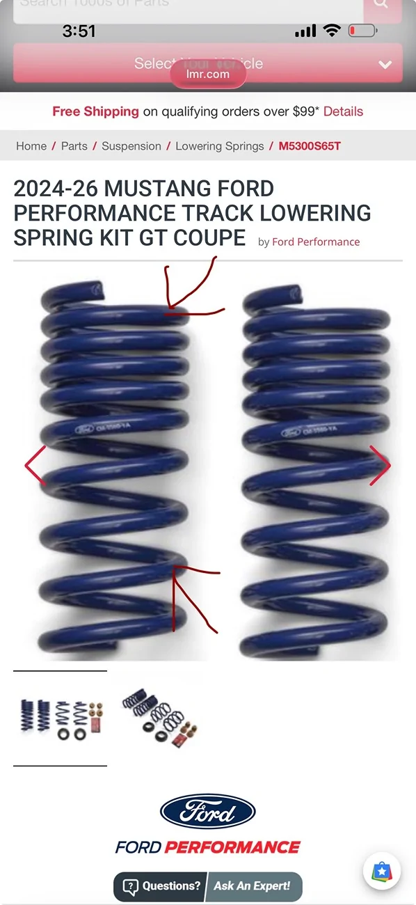

If you look at this photo take note of the tight side being up and the loose side being down. It looks like my springs were installed opposite of each other one has the tight side up and the other tight side down. That’s what makes it look funny like this .
