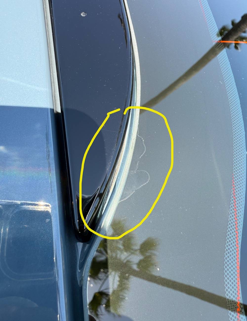

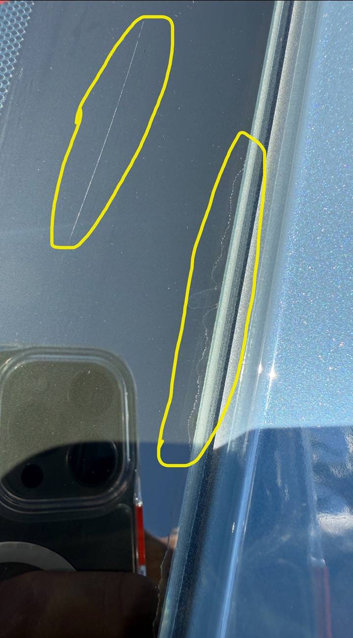

Hi! I bought my GT around 40 days ago. Today I notice these marks in the rear glass. It’s from outside because I can feel it with my finger nail. I tried to remove it but I couldn’t…. Not mentioning the scratch I found too…. Any of you guys know what is it? Do you think it worth to make a complain to replace the rear glass?
I’m afraid the new glass will be worst ( bad installation and water insulation) or leave the way it is…

Okay dumb question first have you tried cleaning the inside of the glass? It looks like (A) glass delamination or (B) window adessive that has seeped out and needs to be removed. Take it to the dealer they should fix it. Good luck with your car.

I had some odd looking streaks/smears/splotches on the inside of the back window that I didn't notice upon inspection during pickup (new). I looked over all the body panels and gaps and so on and somehow never paid any attention to the back glass,
When I first noticed them I had an oh crap moment. I hurriedly tried to clean the back window because I thought this might be permanent damage of some sort. The marks didn't budge. I dug in deeper with a hard elbow grease cleaning with success on the second attempt. The back glass is hard to reach and a pain to clean.
Speculation here. Not saying this is the case for you however a deep cleaning is worth a shot. By deep cleaning I mean hard elbow grease and Stoner's glass cleaner coupled with microfiber towel. No abrasives or harsh chemicals. I would never recommend cleaning vehicle glass with Windex or paper towels.
My theory is.... I'm guessing there is some sort of protective film applied to the glass that is removed at some point either pre or post installation on the assembly line. I surmise it's just as hard for assembly line workers to get whatever this is off and they let it slide. This is only a theory and I may very well be wrong IDK....

When I bought my DH a year ago my rear window was a mess worse then yours. I used 3M compound cleaner and it cleaned up nicely. I have a scratch on my passenger window which Ford refuses to replace. Ford states because I waited a month after taking deliver they won't warranty it. I told them well I just found it but still no luck. Fords warranty sucks.

Did you have that back glass tinted?
If so, that scratch looks like a cut from a razor blade when they trimmed the tint to size. I had cuts all over my front glass that looked like that after having the windows tinted.
In theory, the tint is precut for all the glass except the front (so I've been told), but I had a scratch like that on my back glass as well. I really think was from the metal edge on a heat gun nozzle, since they lay the tint on the outside to heat it to get the curves semi-correct before putting it on the inside, but I never did get a solid answer about that part.
The tint shop eventually paid to replace my front and back glass because the damage was so bad.
See here for pics: https://www.mustang7g.com/forums/th...ated-now-turned-nightmare.162149/post-3301191
If you have had the windows tinted, you might ask the shop what chemicals they used during install too, since maybe that staining could be from some chemical used during application. You wouldn't think so, but I wouldn't have thought that they'd use a razor blade on the outside of my windows either, but here we are.

I tinted but the shop used a precut machine to cut the exact size of the the glass. They showed me in the computer and I saw the machine cutting the tint. But I didn’t see they work on my glass.
The shop that damaged my glass also said they used a plotter to cut the tint for the back, yet that scratch was still there. Other professional tint installers that I've spoken with said that it could absolutely be from a heat gun.
I also talked at length with a couple of glass repair people and an auto glass installer, and they all said that kind of scratch can't be fixed like a chip can. You can't buff it out, but you also can't fill it with resin like you can with chips.

The Scratch should be an easy fix.
The Window will probably need to be replaced.
Please remember the Dealer will probably send your Mustang to a Glass Shop to replace it.
I don’t know of any Ford Dealers who does their own Glass Repair or Glass Replacements work?

Would have been nice if the OP mentioned he had the window tinted. Good catch by whoever ask that question. That changes everything.
