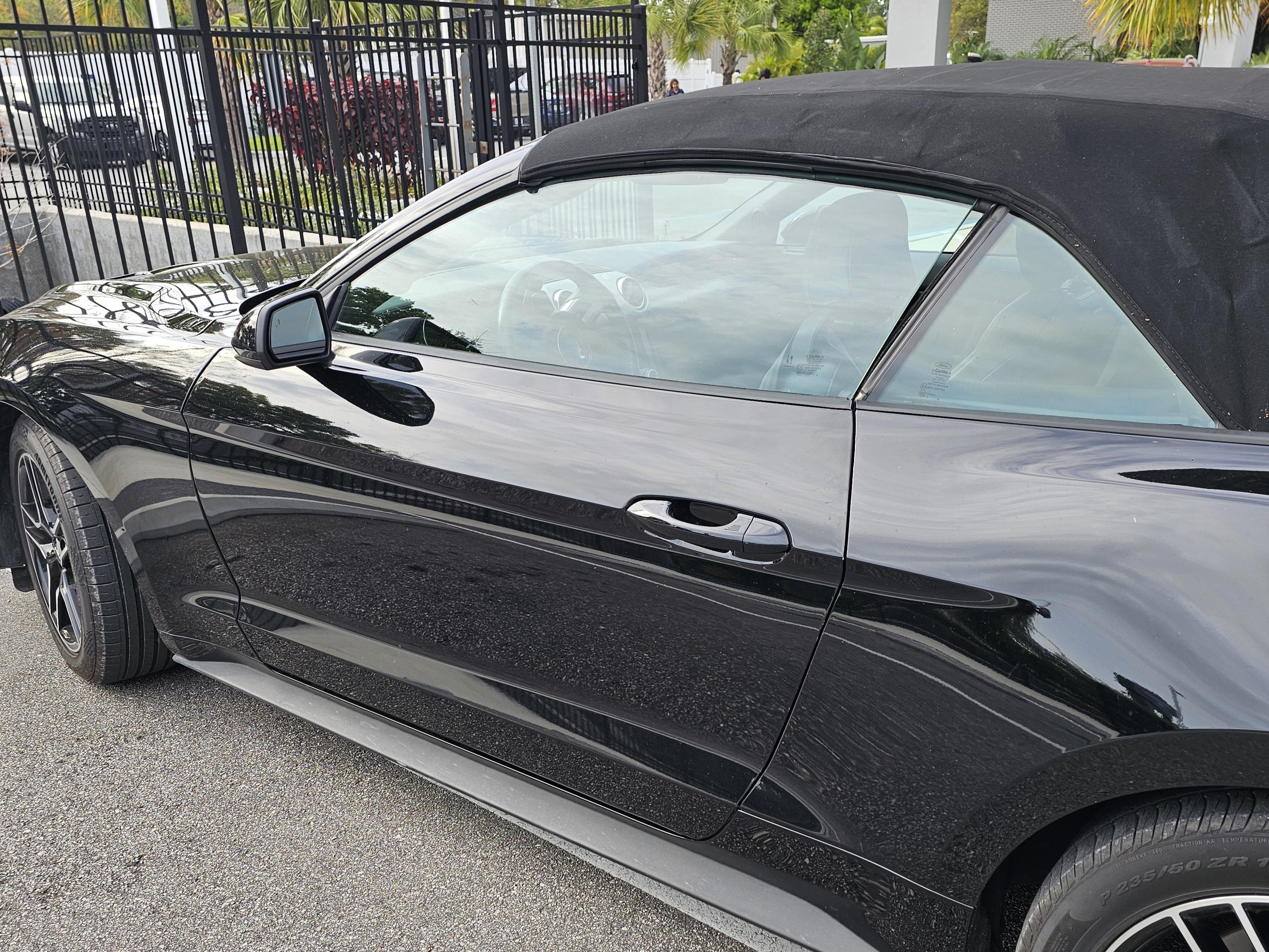

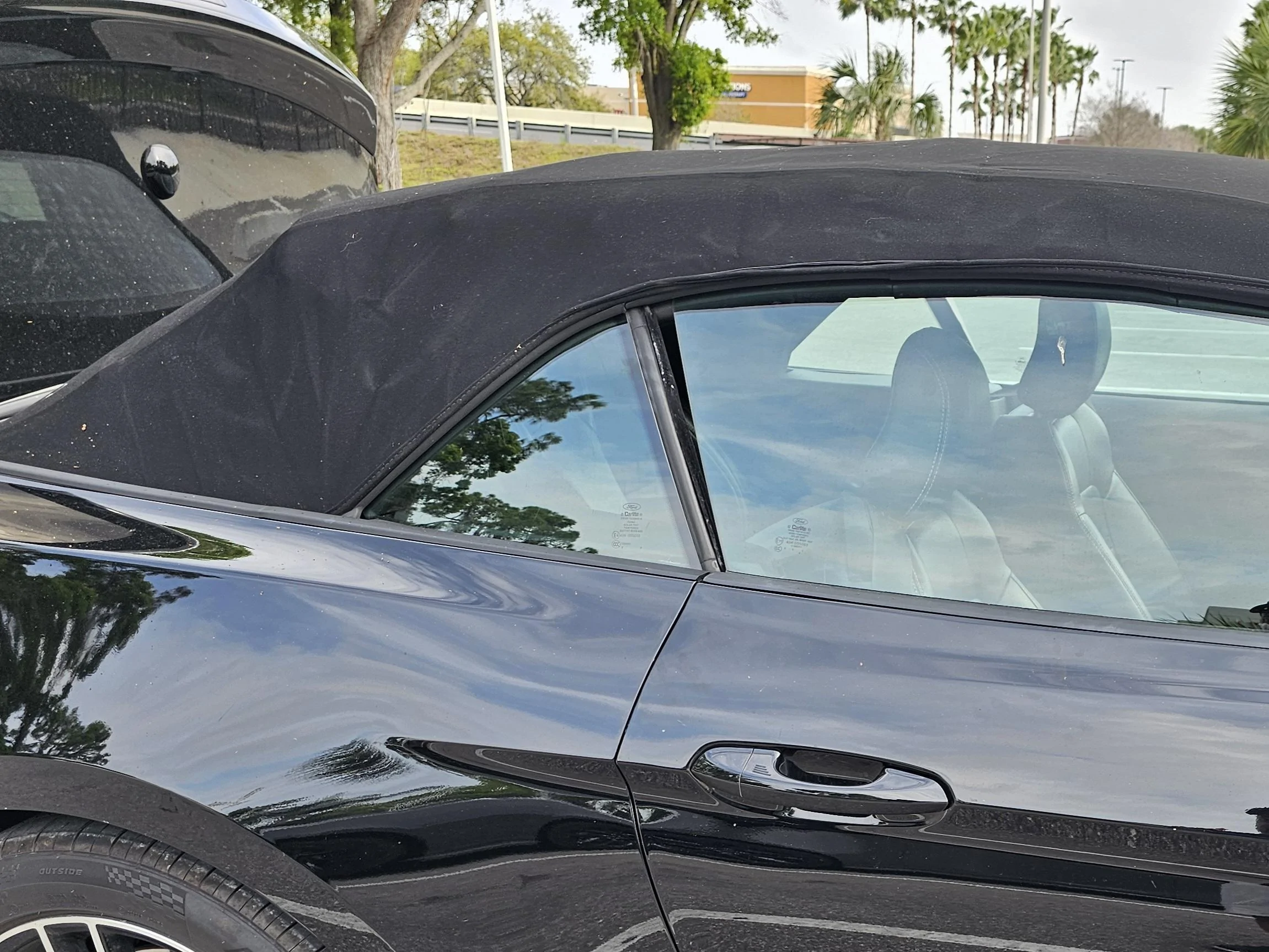

So have they fixed this with the '24s? Renting this '22 in FL this week and sure enough both back windows don't close all the way. I've heard this is an issue with the 550s and now I got to see it in action 😆

I put the backs up first and this is as far as they will go. But I can grab them by hand and pull them up the rest of the way. Annoying but hey it's a rental.
