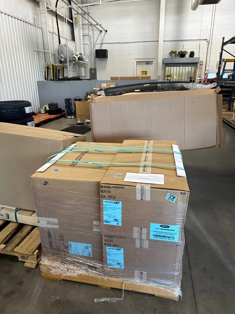

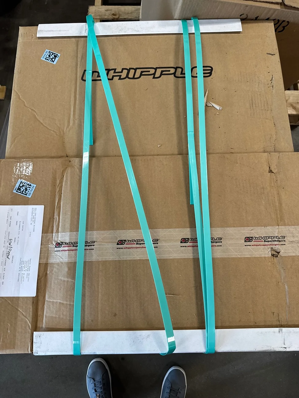

Finally bought my wife s stage II Whipple kit. Without searching 1000 posts, please provide any recommendations on additional add ons or supporting mods that the kit doesn’t include. I bought a whipple catch can so far. Thanks everyone.
