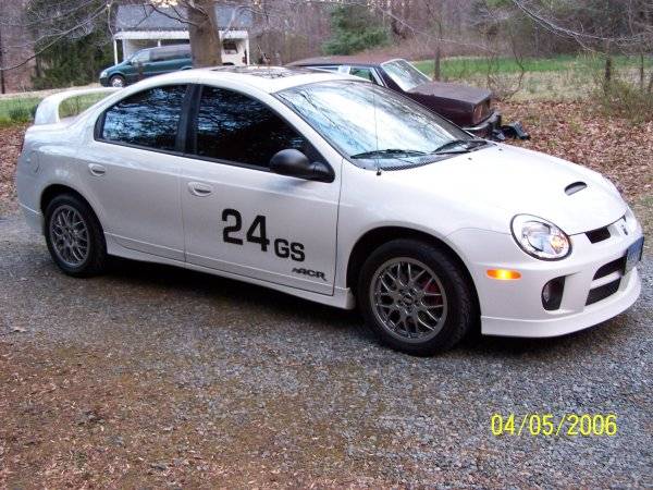

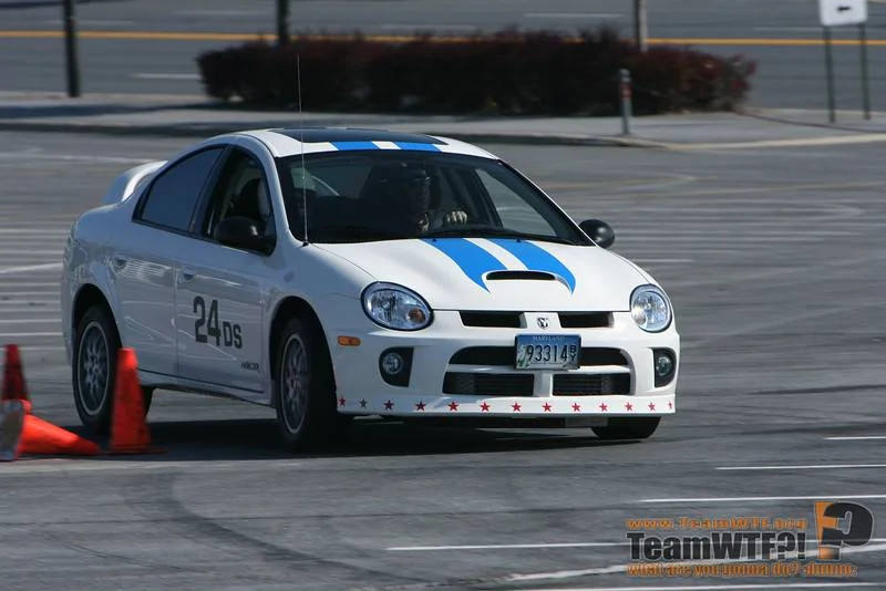

nice cage. How fast was it? mid 10's to low 11's?
Reminds me of my 500hp srt4, but I was only pushing 25 lbs
