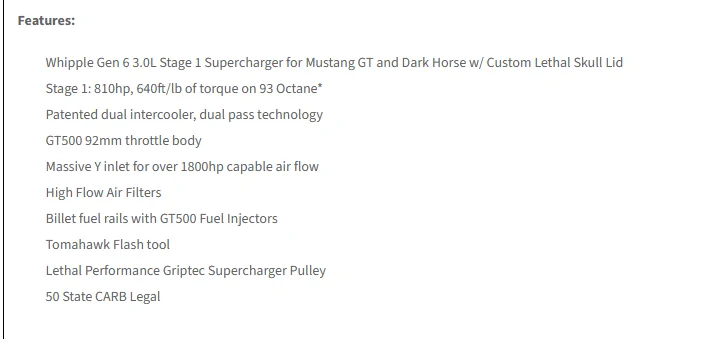

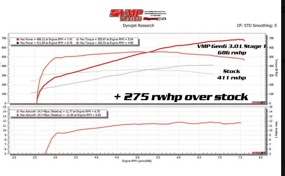

Where are you seeing that it makes different numbers than say, the Whipple stage 1? Please post screenshots or links to the website you see this on.

Yes, Crank measurements only account for the engine while Wheel measurements account for the entire car. So wheel HP and Torque will always be lower than crank measurements. But these kits are the exact same outside of a label on top of the supercharger
