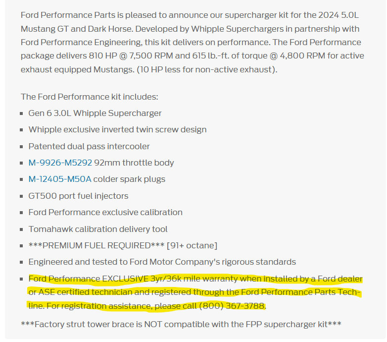

If you buy the Ford Performance Whipple for the 24+ and install it with an ASE mech it is warranted by FP through the Ford dealers.
S650 Mustang Warranted Stage 1 Whipple registration? 1724880263463-ql

Called Ford Performance’s 800 number today, and as long as it’s installed by an ASE-certified technician (and their number is on the invoice), it will be warrantied through Ford. Same goes for installations by a Ford Master Technician. Musta be registered withing 30 days. Thank you all for your help.
