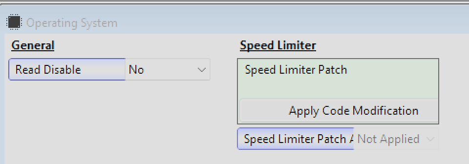

Best for the a10 if you are doing WOT pulls is to use manual mode to hold gears to get past the OSS limits for shift schedules. Ford/Whipple lock out auto upshift in manual mode so you can hold it in any gear until you hit the hard RPM limiters based off of your oil temps, coolant temps and trans temps. RPM limiters also come into play well before those speed limiters or the shift schedule short comings depending on if you are running hot or have perceived misfires and so on. The trans alone has tons of limiters on all kinds of things...
