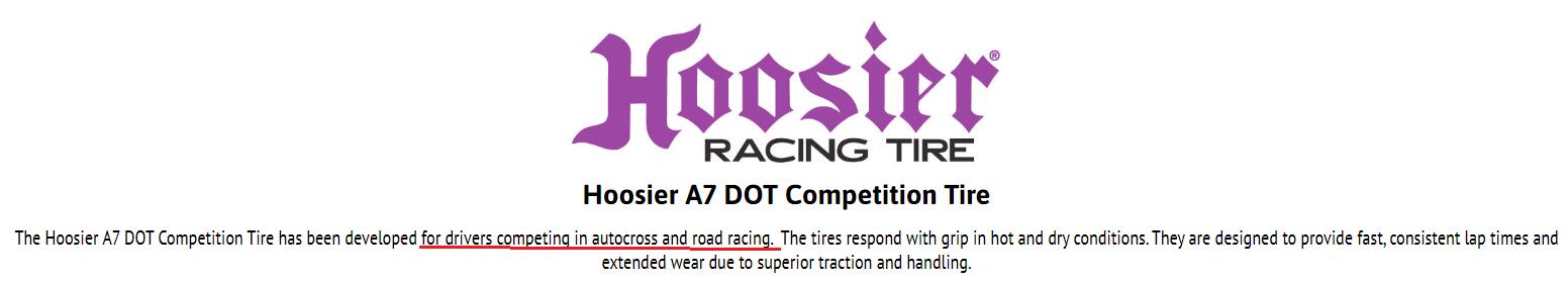

A7 compound is for auto cross on cold tracks

No, it’s a single purpose compound for cold temp auto cross.
OP put a R888R on or ET street SS if they have your size.

Ok, you bought A7s and had problems hooking up, holding power.
You’re complaining about it while debating its uses? I don’t get it.
Complaining?? You obviously have me confused with someone else as, I was only pointing out your comment about A7's being, "a single purpose compound for cold temp auto cross", was not entirely accurate. And, I never said I had problems hooking up, holding power. Once the A7's heated up they did very well, good enough that I ran them for nearly 10 years road racing. My whole point in thread #7 was to point out it doesn't matter what make tire or size you have, a high HP & TQ car will still break them loose. I'm done, time to move on................
