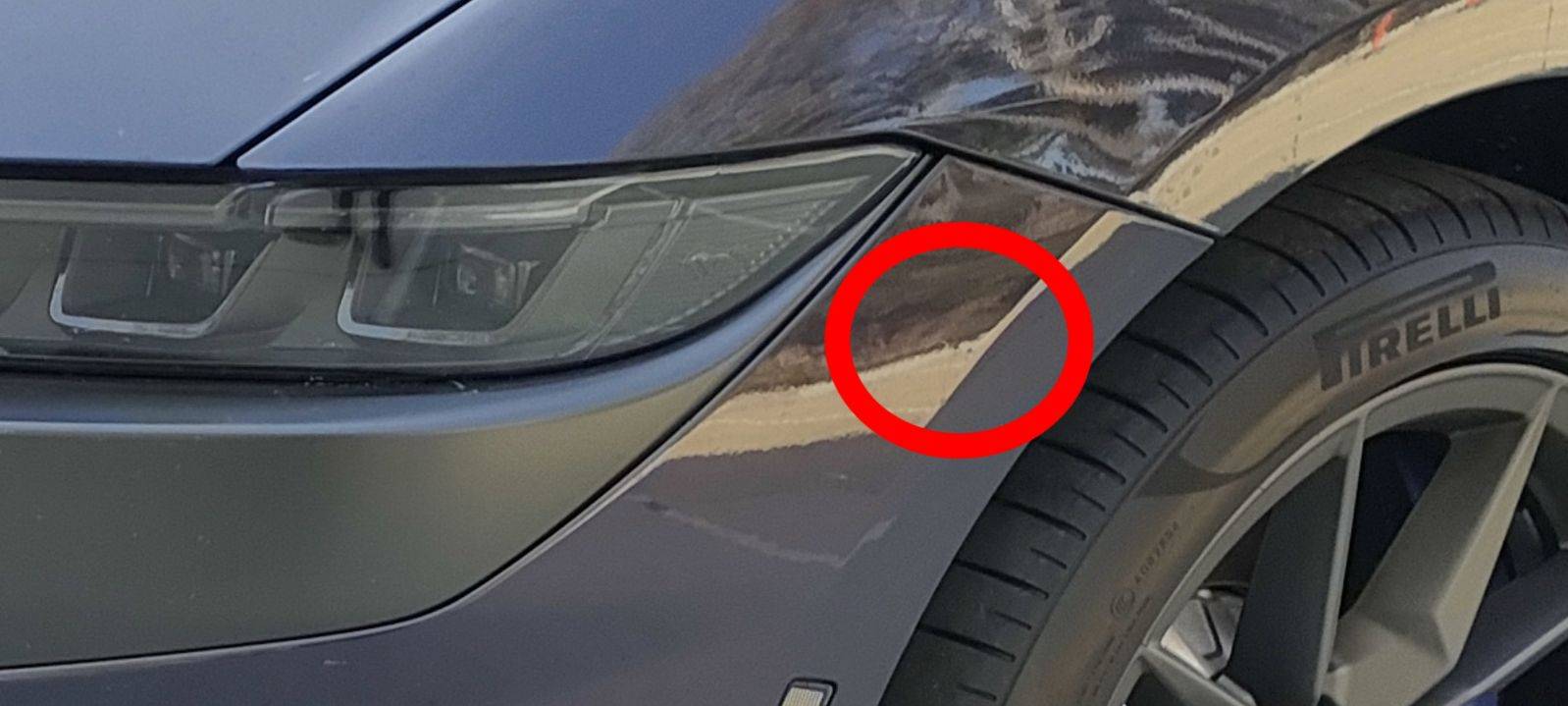

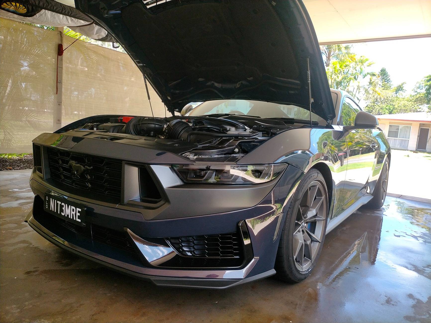

Morning,
When I got the car transported to PPF they identified marks on the left fender (possibly a chain?), but it was also some of the first DH's in Australia, and were a little hesitant to try and paint match the Blue Ember - after many discussions and photo's, it was PPF'd over and to be honest, you would notice if was not pointed out - even to the point that there is no real difference on the surface of the PPF at the point of the marks - threw in some before and after photo's
Prior to PPF - 4 knotches in line possibly for link of chain
S650 Mustang PPF Over Existing Rock Chips? image000000
After PPF - nothing were done to chips prior to PPF being applied over top
S650 Mustang PPF Over Existing Rock Chips? IMG20250113132352
Even zoomed in, it is not noticble - I can pick it and depending on angle of light easier sometimes, but it is not an issue to go over chips - would most likely be a benefit to seal off from atmosphere and stop any further deterioration.
