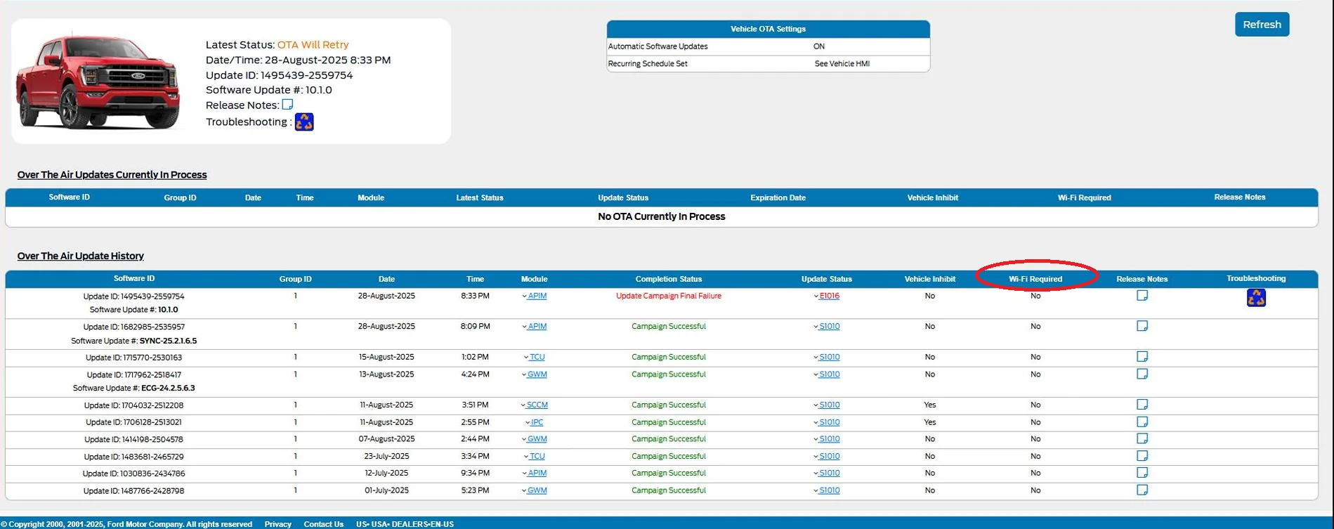

100% of OTAs where firmware needs to be updated come in through cellular. In Ford's PTS website, you can view the OTA dashboard of a vehicle and one of the bits of info is if the OTA requires wifi or not. I have been following Ford's OTA process very diligently since the first F150 and Mach E's with OTA capability came out in 2020, and this has been the case since then. The only OTAs that will say wifi required a configuration only updates where no files are downloaded and only the config is changed within a module to fix an issue.
Below is a screenshot of the OTA dashboard of an F150 that has a healthy recent OTA history. This truck received 9 updates between June and today and not one said wifi is required. That I know of, there have only been a total of 4 updates that require wifi to install. 2 of these are exclusive the the F150, one is exclusive to vehicles equipped with Bluecruise, and the other one was to fix an issue affecting all vehicles where a TCU update changes the country code from the US to another country rendering the modem useless. It could only be fixed via wifi (or FORScan) since the modem went offline. This TCU update was sent out before the S650 Mustang existed, so it was not and will not be sent to these cars since it will never be affected by this problem.

So when you say wifi not required, it does not exclude that it can be done on Wifi only, right?
I am asking because I have a US Spec 2024 in Dubai and of course the TCU cannot connect, although the upload and download arrows are shown on the screen.
I am wondering if anyone has managed to reconfigure the eSIM Profile?
