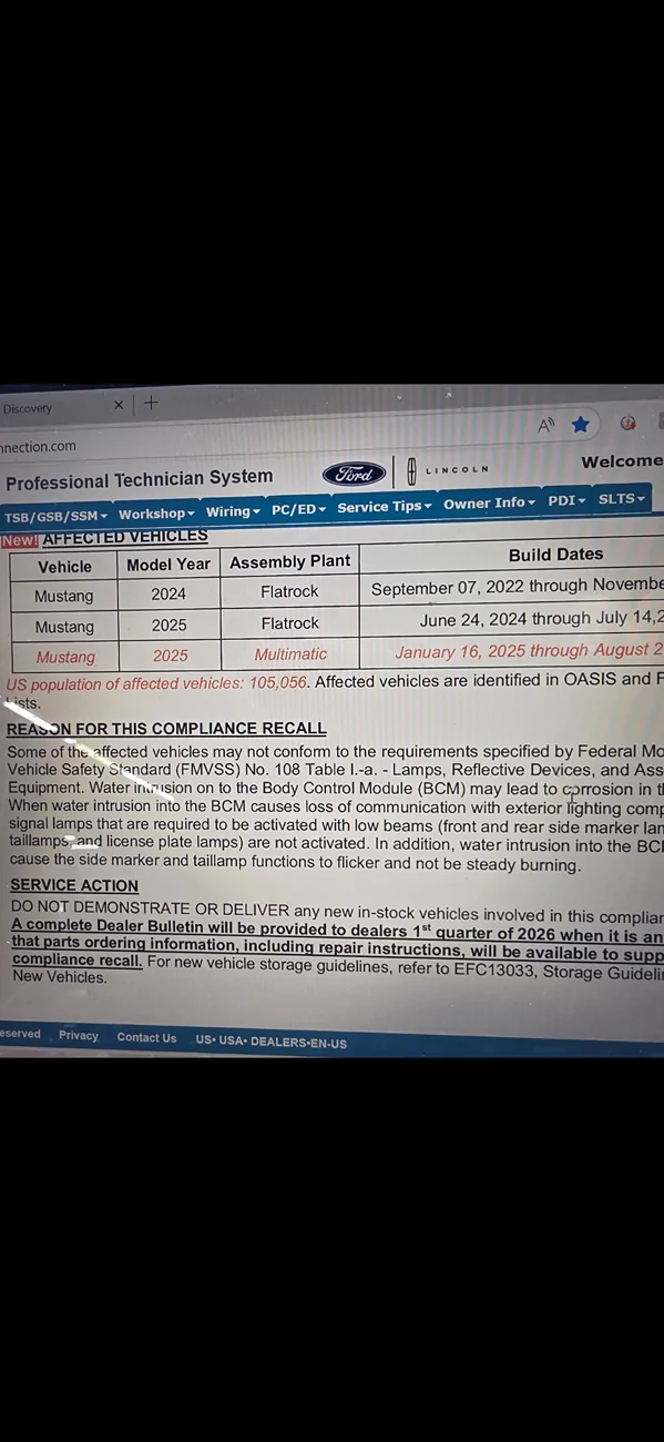

I found the same thing. I had a Ford Certified Tech check- nothing good. Combined into one is all.
funny my dealer had no clue smh 🤦
I had to go to an Indy shop with a lifelong ford tech to get the answer

Not sure about the combining. The recall that remains is based upon the possible water intrusion into the BCM. The first recall had to do with a possible bad diode with the LED headlights. If combined, I would expect the description in the water intrusion recall to change. I’m driving, enjoying, and not worrying about it — will get the recall work done once fix is available. Sure glad I got it when I did before the stop sales.
The description from Ford for the original recall which disappeared:
"Ford Motor Company (Ford) is recalling certain 2025 Lincoln Nautilus, Mustang Mach E, and Mustang vehicles. The LED Driver Modules may contain a burnt diode, which can cause the low-beam and highbeam headlights, daytime running lights, front position lights, and front turn signals to fail in the affected headlight...As such, these vehicles fail to comply with the requirements of Federal Motor Vehicle Safety Standard number 108, "Lamps, Reflective Devices, and Associated
