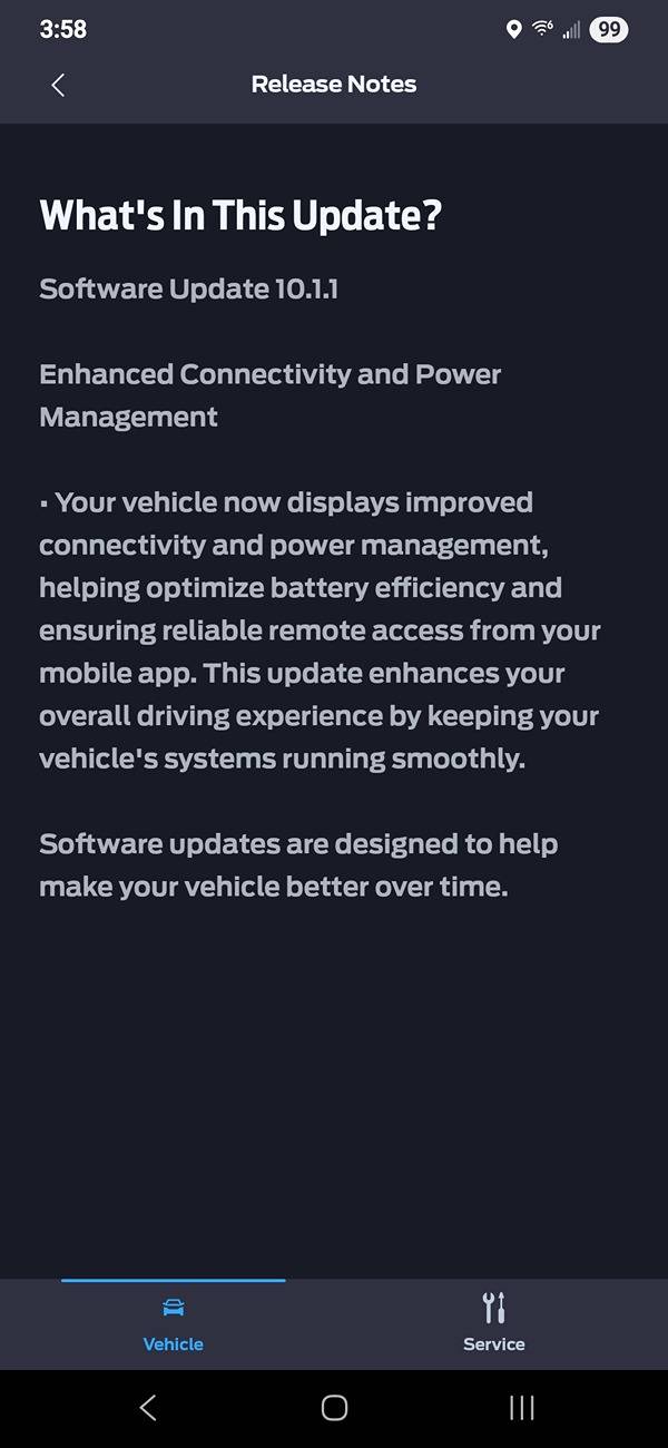

After the latest software update to 10.1.1 on my DarkHorse, "Location" on the FordPass" android app is not updating. I don't think it's the apps problem as my other Ford's location is updating. I tried using the refresh button in the upper right hand corner, with no change.

Go to the connectivitysettings in the car itself and find location or location sharing. Can’t remember what it actually says. Mine was toggled off after the update.

Had a similar issue with the wife's ST. Ended up having to do a full connectivity reset on the vehicle, remove the vehicle from the Ford pass app and re-add it.
