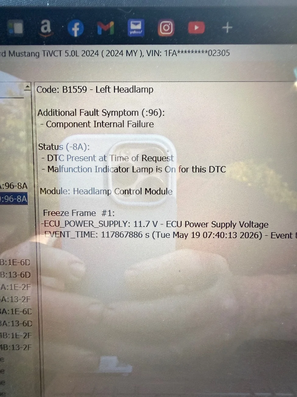

Help, I replaced the battery in my 24 GT and now the front turn signals do not work. The mirror and rear signals work fine but the front amber ones do not. The DRL’s work, and the ambers will come on when I hit the unlock, but when I use the turn signal nothing. The signal indicators on the dash have a weird blink also not a steady one as before. Fore’s can shows this for both sides. I have cleared the DTC’s and rebooted the modules, DTC’s stay clear until I use the turn signal and they show back up. Any suggestions?
