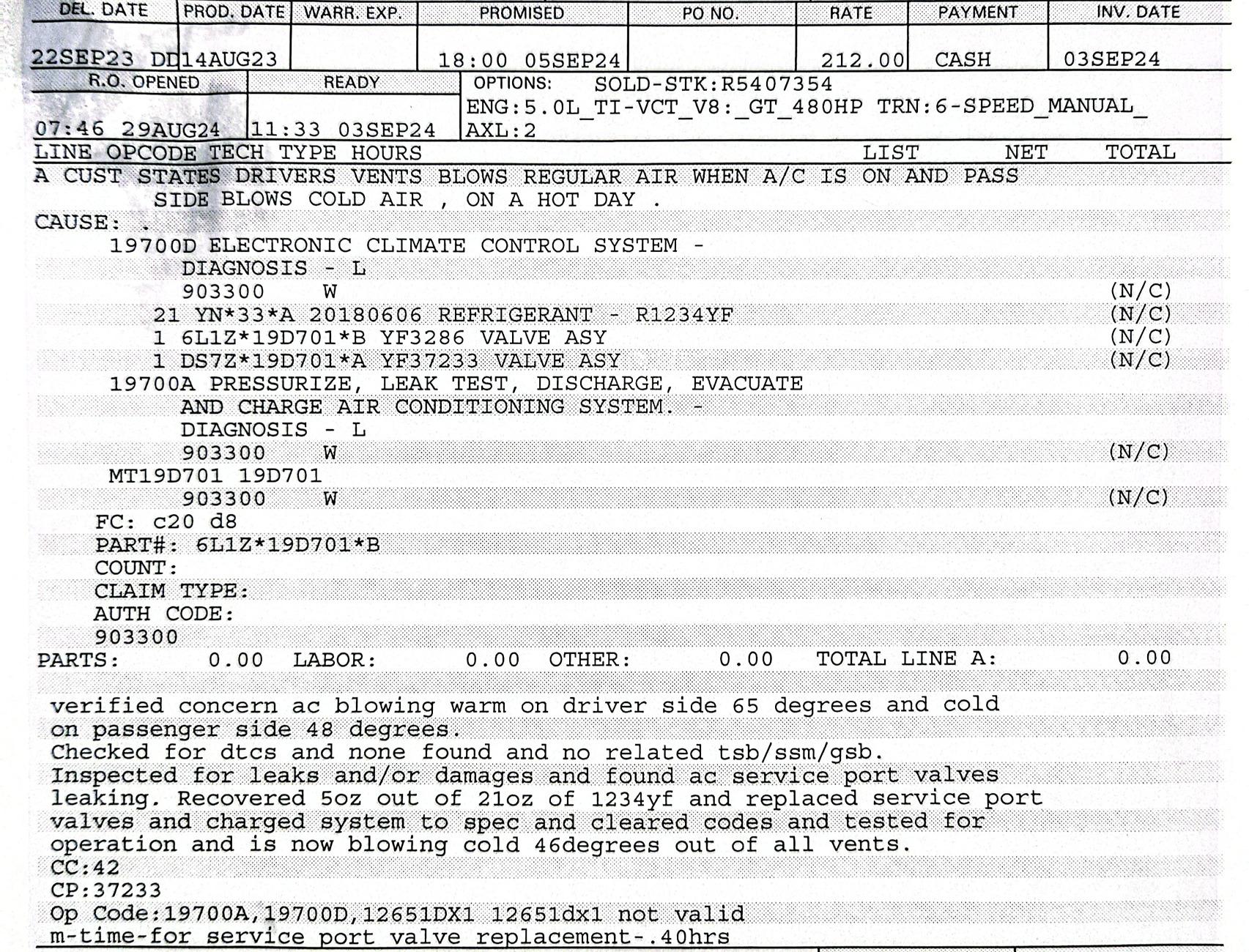

Just got my GT back from the dealer for the 2nd time for AC issues.
First time it just started blowing warm air. Dealer recharged the refrigerant and said it came low from the factory. Worked fine for awhile (6 months).
Second time it would blow cold on the passenger side (for a bit), but warm on the driver side. After driving for a bit both sides would eventually blow warm. Dealer found a leak in the AC service port valve. Replaced the valve and recharged the system.
Hopefully this was the fix.
