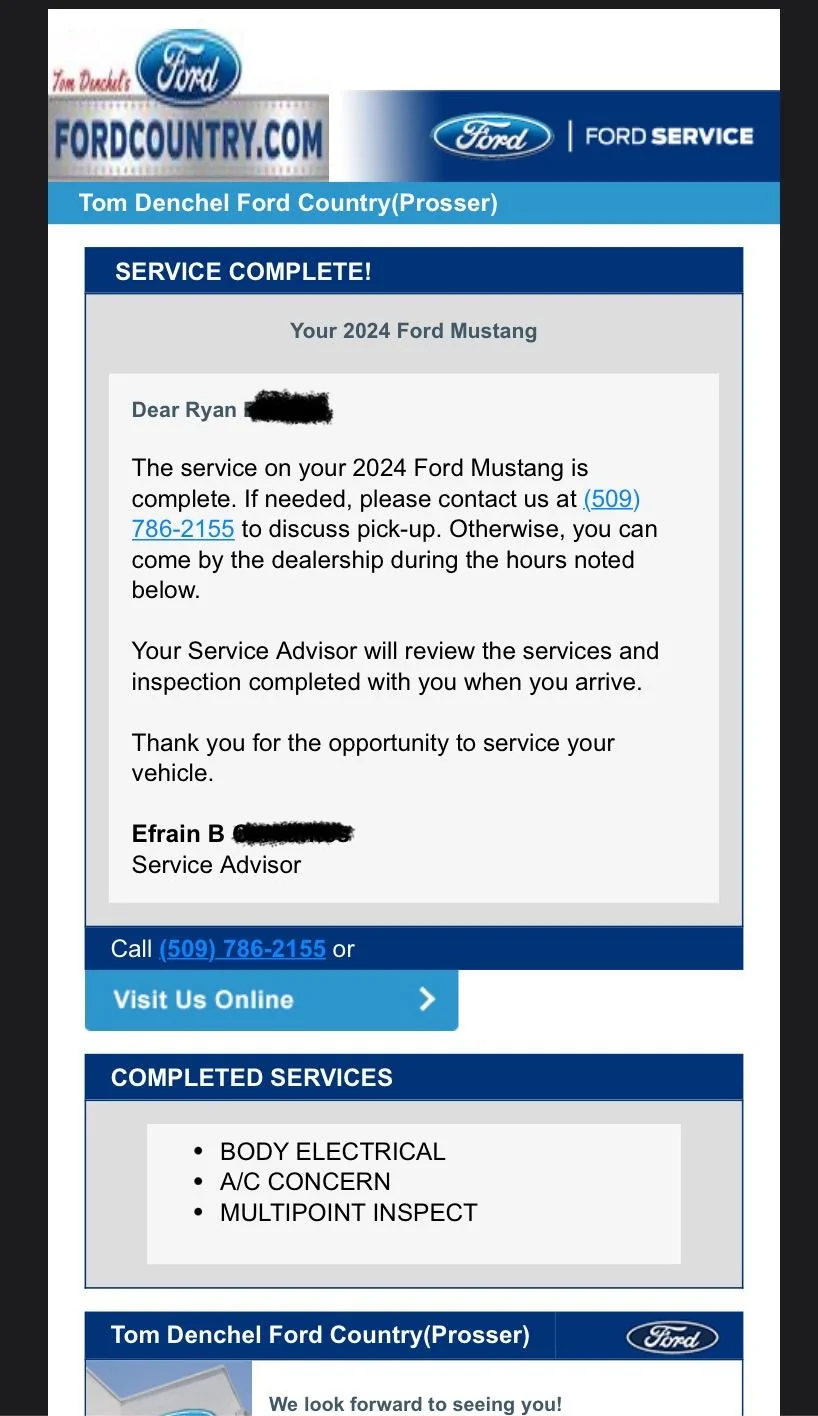

Hey guys, I got my Mustang Back 👍👍👍 Super happy they finally fixed my AC. They did replace electrical fuse, box and relay, and they reprogrammed my computer They evacuate my a/c System so they can weigh the refrigerant. all that matters is that it’s blowing cold air. They told me if there’s any other issues just bring it back. they guaranteed it should work for a long time without any issues !! Case Closed.... Now lets install this VF-5 wheels I hope I got the correct TPMS Sensor Part #: TPMS74 (F2GZ1A189G)
