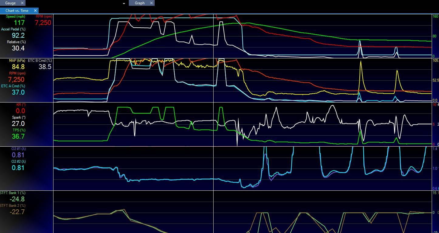

I guess it depends on your definition of 'practical' ... Track only use it's practical, Street use, not so much. Plus, Nitrous has gotten Expensive over the last few years, it's $7lb around me, luckily it's only 7miles to the shop for the refill.
I installed a single nozzle in intake tube on my car, But I already had all the nitrous stuff laying around, along with 60lbs of nitrous in several bottles, so all I needed was a few fittings to install it.
I'm spraying a 100shot [ 52N / 26F jet ], However, my logging shows the throttle bodies are closing down to less than 40% due to the extra oxygen so it's not advisable to use a nozzle or those new TB plates NX is offering for anything bigger, The direct port plates will be needed IMVHO.
And I'll caution you now, If you have the A10, It does NOT like being slammed with the extra HP nitrous hits it with. It'll skip and short shift gears all over in Auto mode.
I'm using a WINMAX controller and wired the solenoids to stage 1 and wired stage 2 as a shift light/buzzer.
I have a billet aluminum bottle bracket and mount it in the spare tire well, Ran the line down the drivers side cabin wiring harness run and out the OBD firewall gromet, need to pull the driver side fender liner to get to it, but it's easy to get out.
Other than that, high 9's should be easy to hit with some weight loss, DR's and manually shifting a 200shot.
I ran a 10.688s @127 last time out on the 100shot with the A10 short shifting 3rd and 6th @6800 and it shutdown on the 6tg gear short shift when it hit 7th about 100ft from the end. That was bringing the nitrous on @3500
S650 100shot
Eighth mile tracks are opening tomorrow around me so I'm going out and try for a 6.75xx.

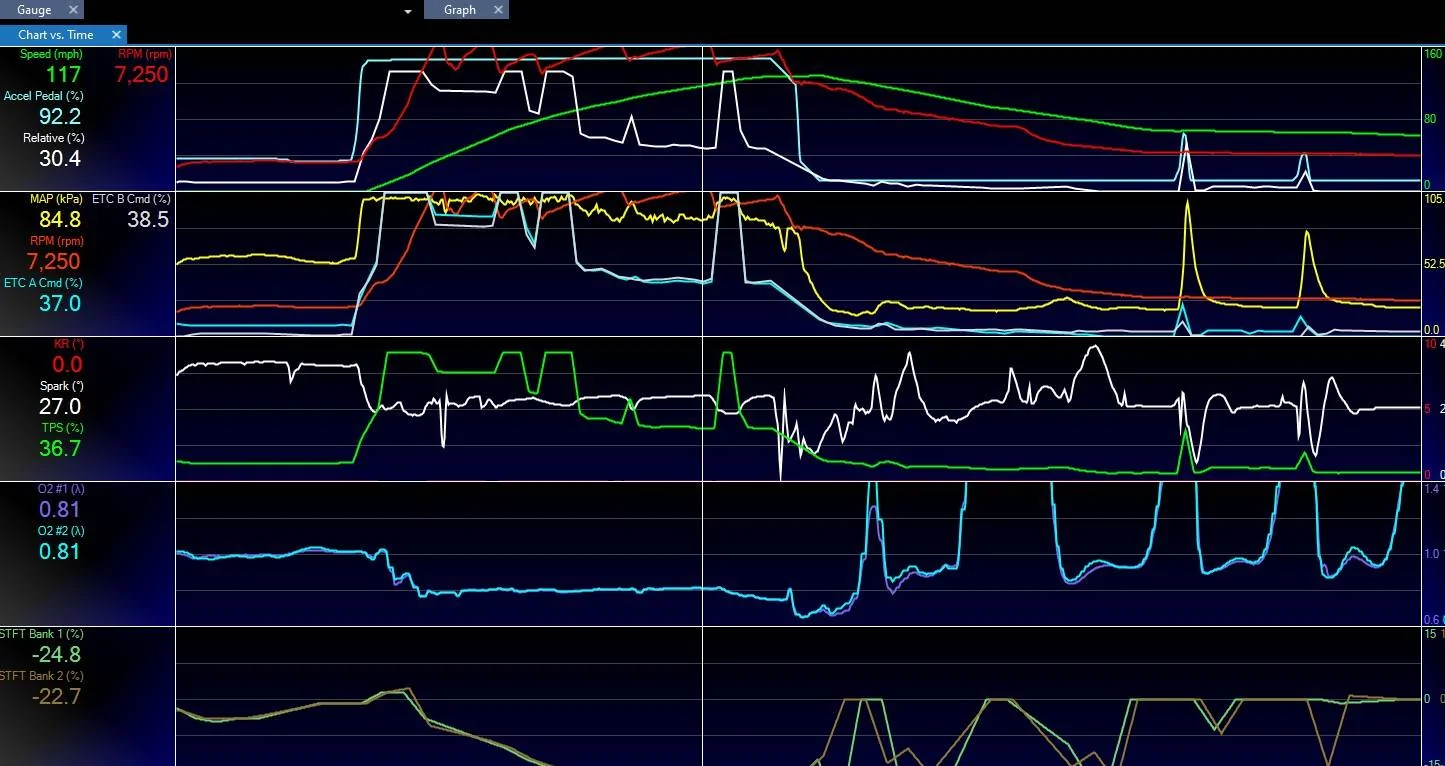

Best has been 11.32 with 1/4 tank of E40. DA was negative 500ish.
3.15 rear, 275/40-17 Hoosier DR2, I'm using the 18x5 OEM spare rim with a Kumho 135/80-18 tire as the front runner. With Passenger and rear seat removed along with the optional spare/jack nets about 175lbs weight reduction.
Upping to a 125shot, I ran a 10.54, Started spraying at 2800, It skipped 2nd, short shifted 3rd @6600 and I tried manually shifting to 7th to avoid the 6800rpm 10R80 6th gear limiter but the tranny still shutdown due to an overspeed condition, All that cost me a a quarter second I'd guess.
The fluid level is good in my 10R but it does not like the extra power.
I'm coming up on 25,000miles so I'm going to change but I have doubts it'll help with the wonky shifting.
Even with tuning my 2018 Gen3 had the same wonky shifting issues on a 150shot ...
