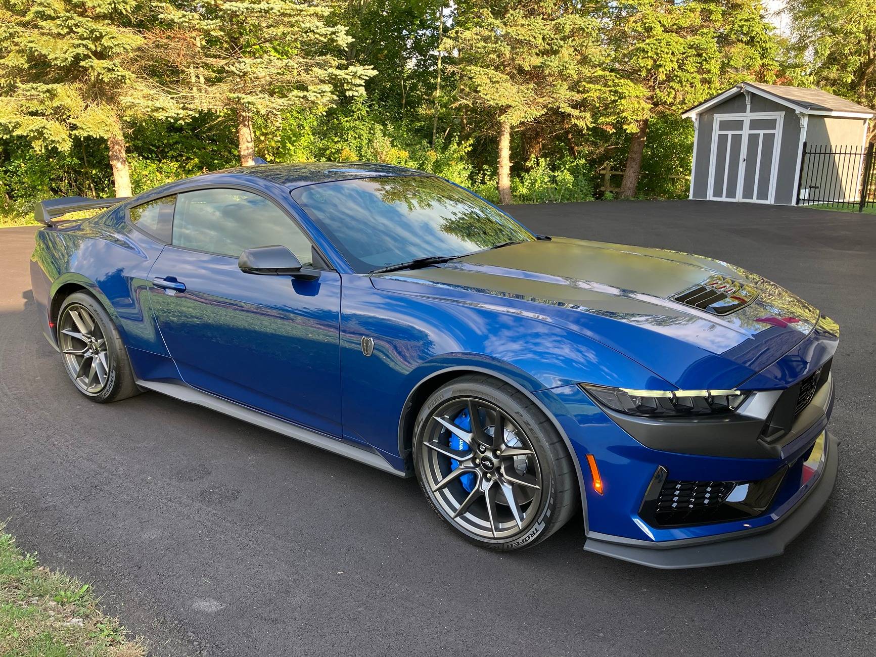

Thank you for all of the helpful comments. I've decided not to change the OPGs. My track days are over now so no need to swap out the half shafts either. I've had supercharged cars before and I just want the added torque and power for occasional "spirited" driving so I'm sure that the Horse will be able to handle the Roush Phase 2.
