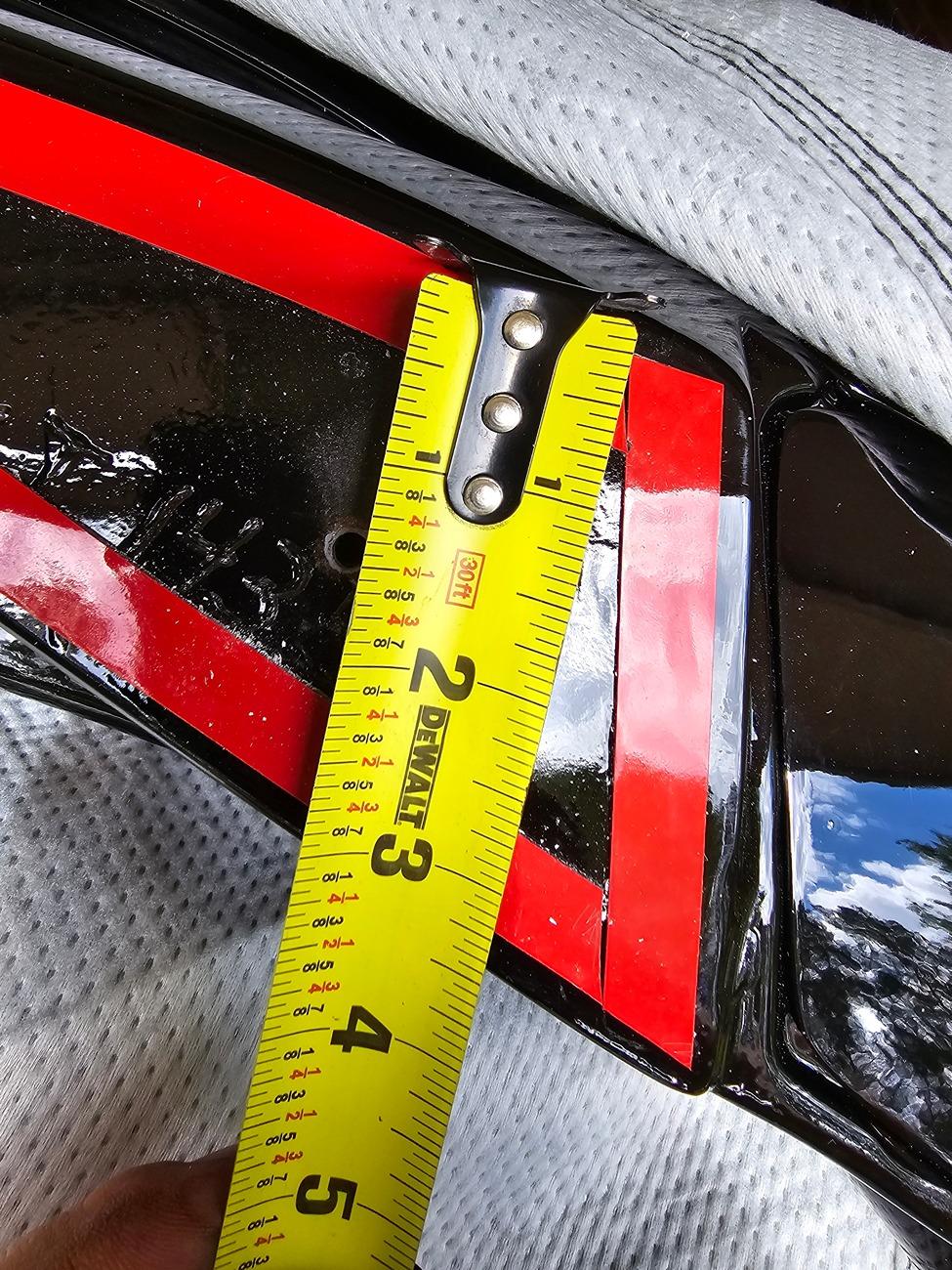

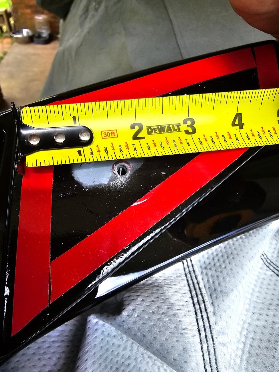

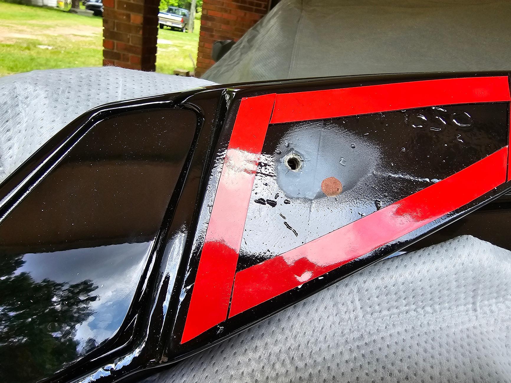

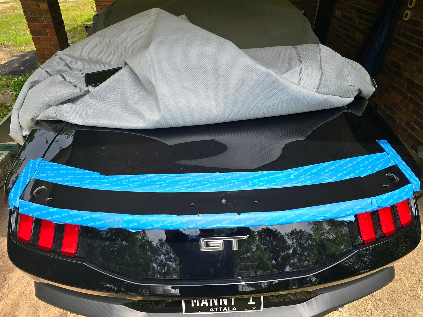

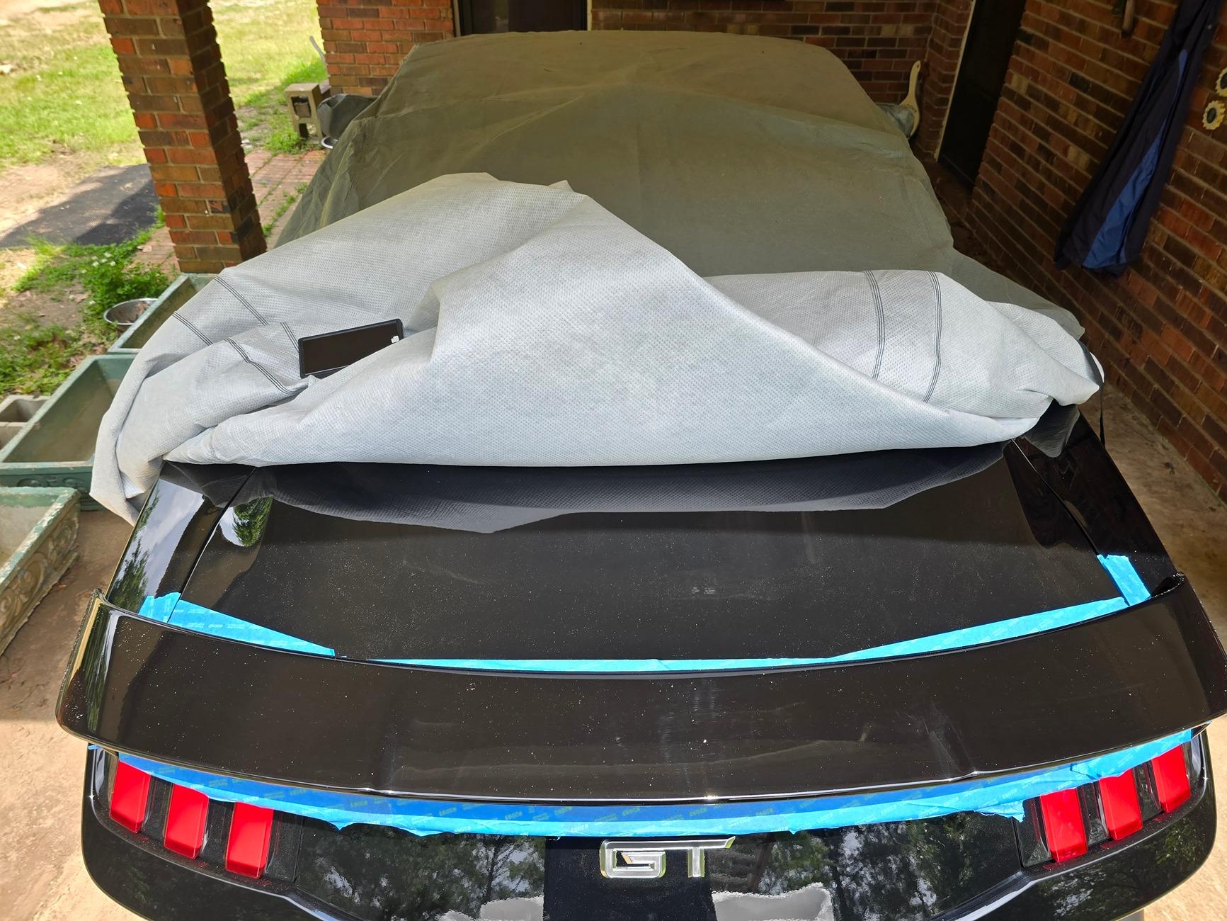

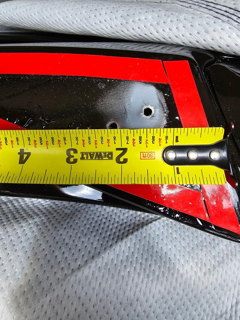

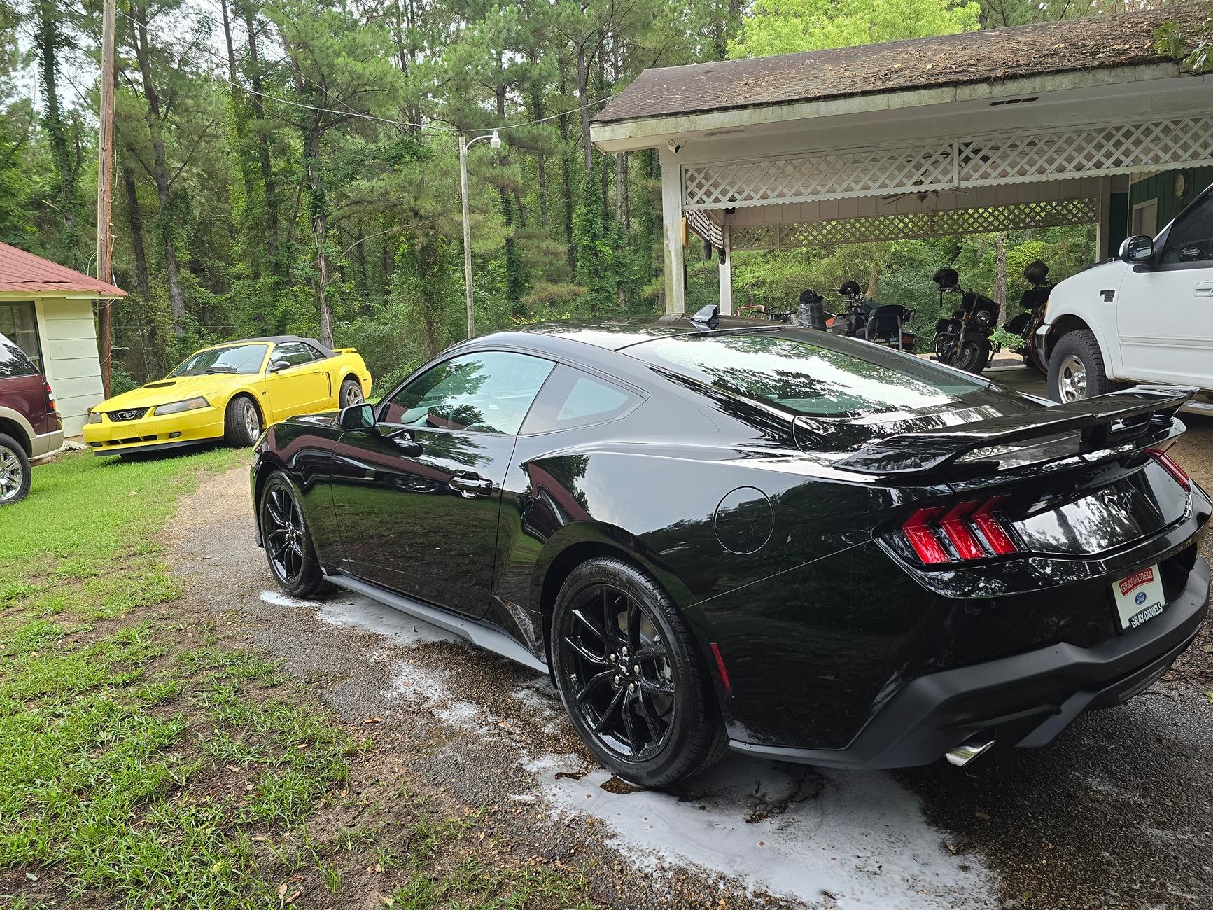

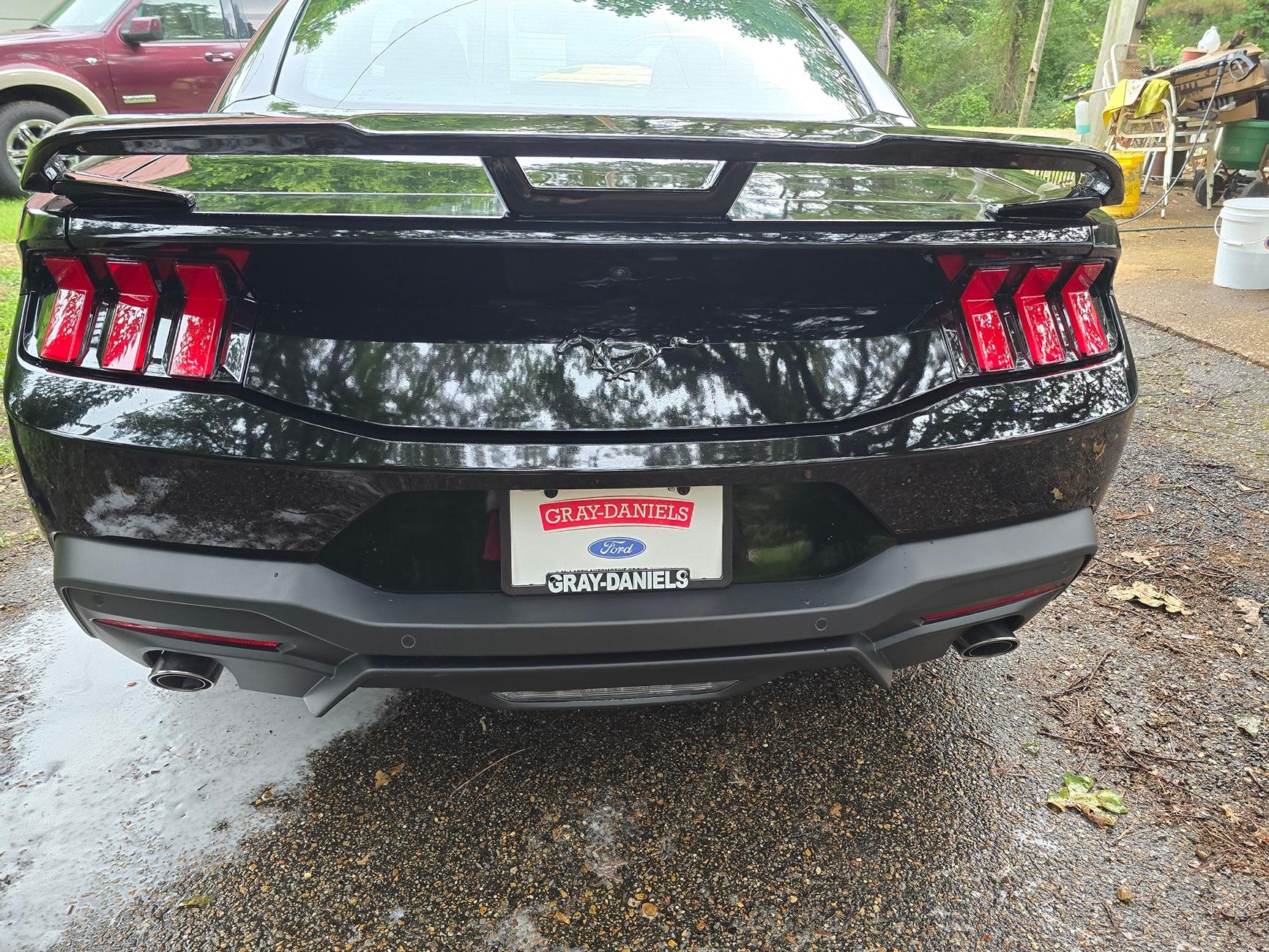

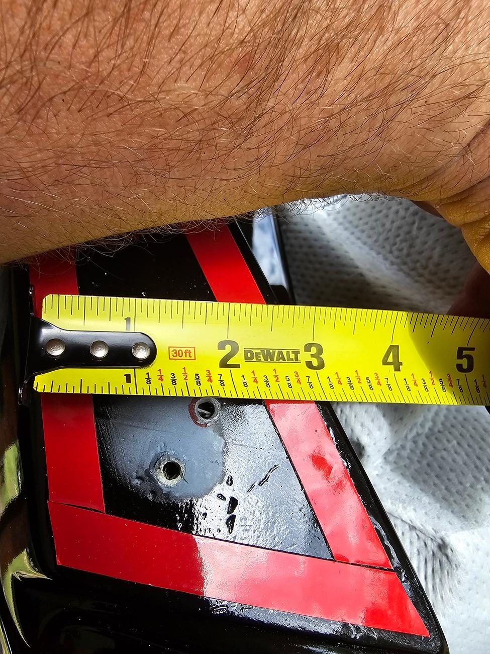

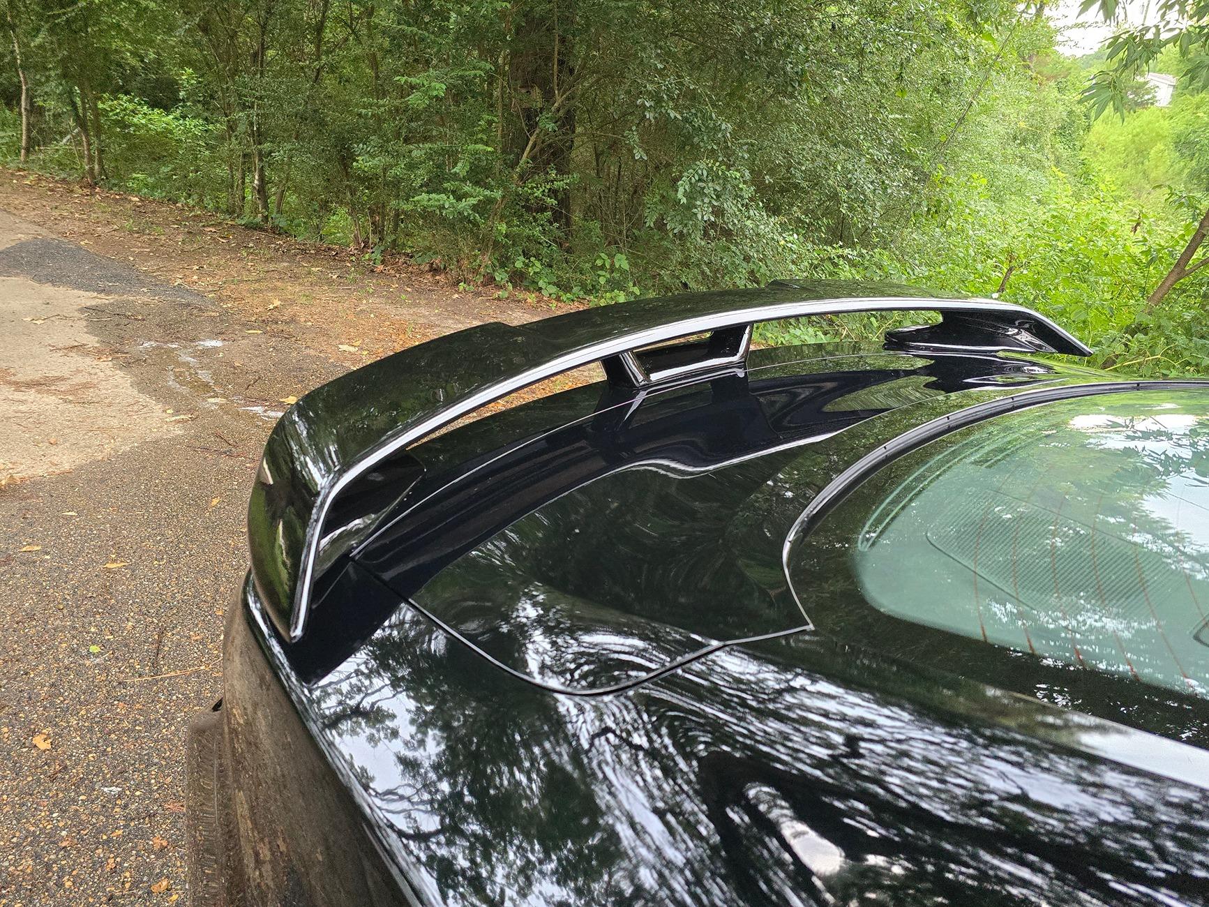

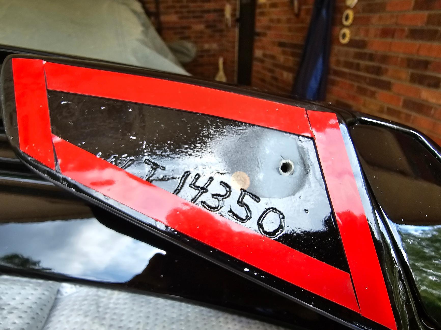

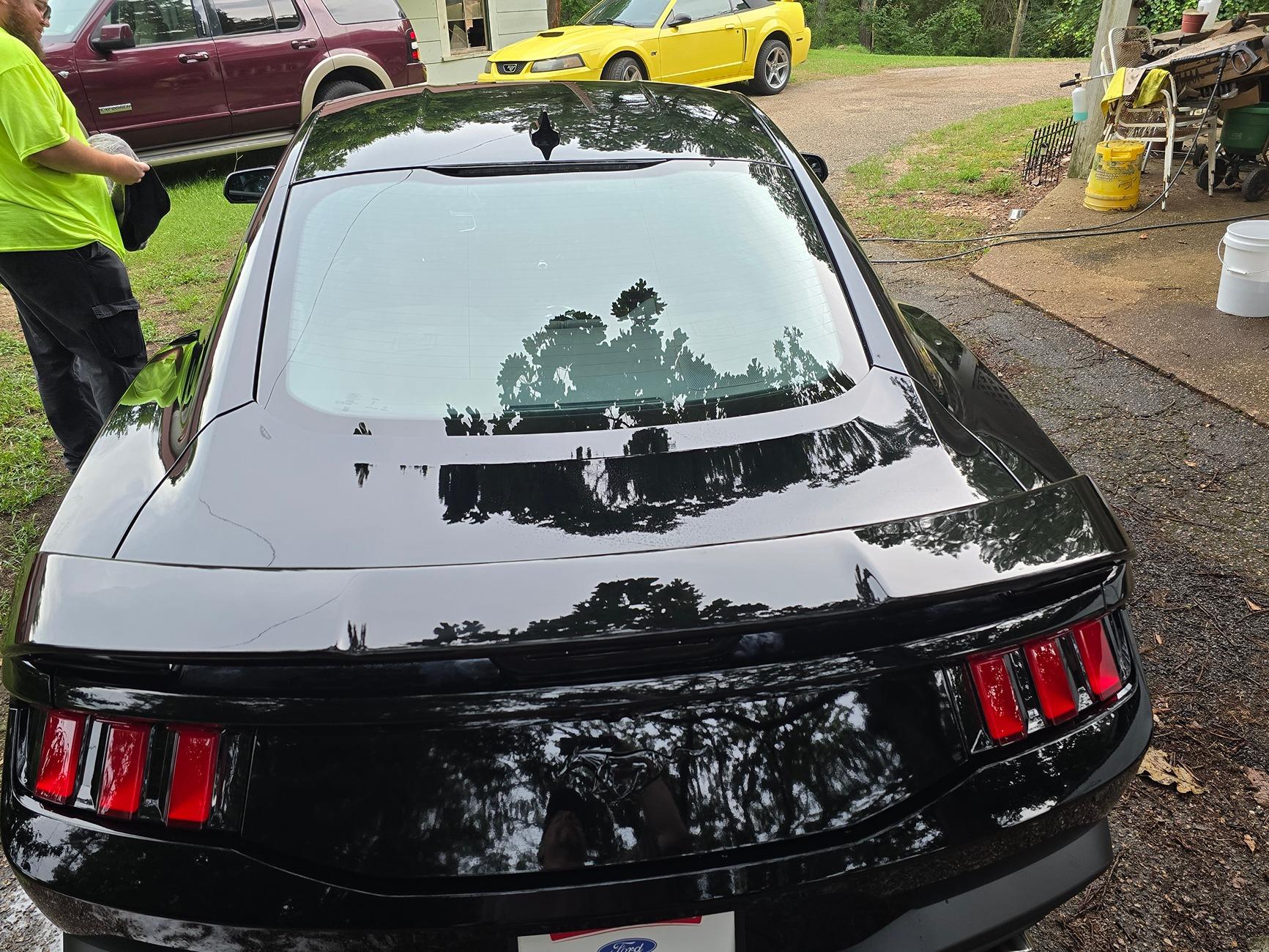

Both end plates are metal, no drilling of the decklid, just aligned everything up, marked my holes from underneath with a red sharpie and drilled the spoiler for the new placement, everything bolted down after that with no issues and looks perfect
That looks great! Good to know it's a simple bolt into the spoiler. Silly DAR didn't realign the holes, but that's better than having to redrill the trunk... Awesome!

Couple quick questions -
1. did you end up just positioning the spoiler and then marking / drilling new holes on the spoiler at the OEM bolt location? (I see the measurements, but is that just for awareness?)
2. Did you use the same lag bolts that came with the spoiler or did you go with shorter ones? I saw a note earlier in the thread that you were afraid they might be too long at the new location?
Thanks!
stang2b
Mar 31, 2018
Mississippi
2015 Mustang GT
Yes, I set it all up, adjusting it to make sure it was completely even and marked the holes from underneath through the trunk original hole locations, then matched up a drill bit just a bit smaller than the bolts that came in the wing, I was uncertain if the new location would be shorter that the original spot so I added washer to compensate the difference and add some support to the trunk hole, because it's just thin sheet metal, the bolts it came with are metal sharp tip screws and not machine thread, if I ever remove it for any reason I'll drill it out a little more and use rivet nuts, but as it is now with the bolts and 3m tape, it's really solid and no issues at all, even the paint on it was great, so kudos to Dars Spoilers, for just a little modding, can't beat the price, very happy with the results so far
