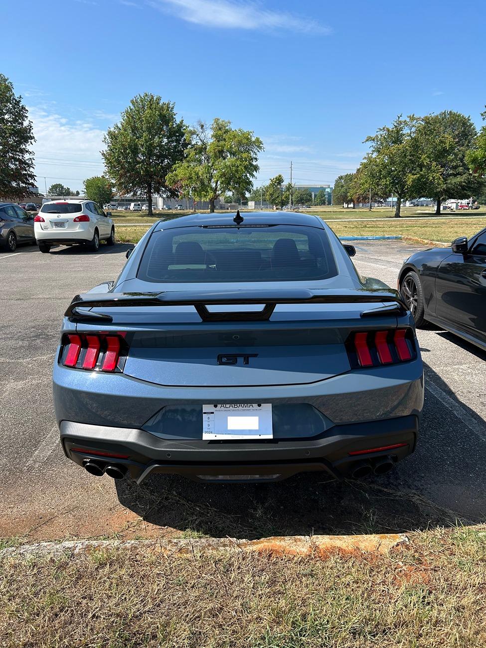

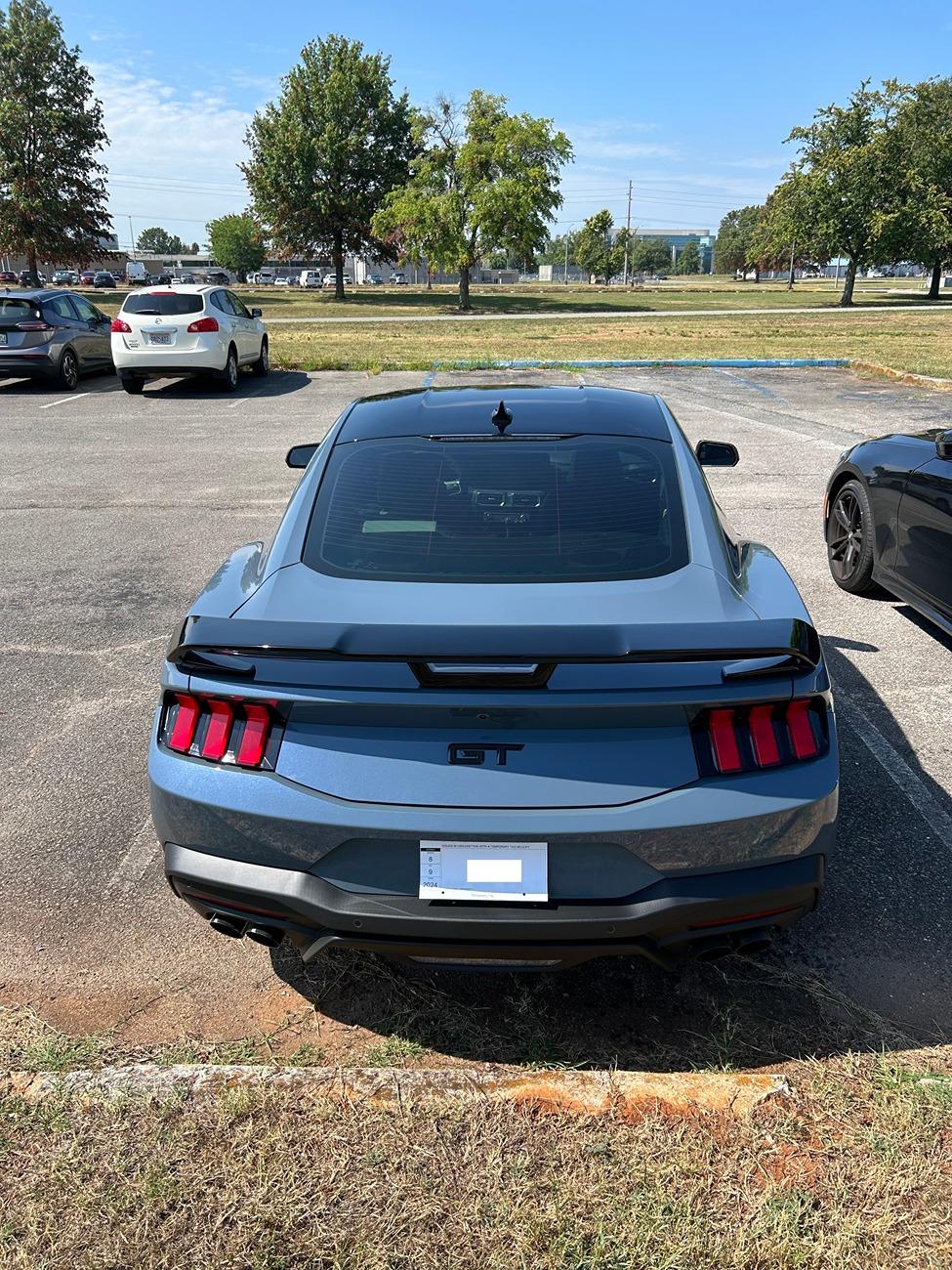

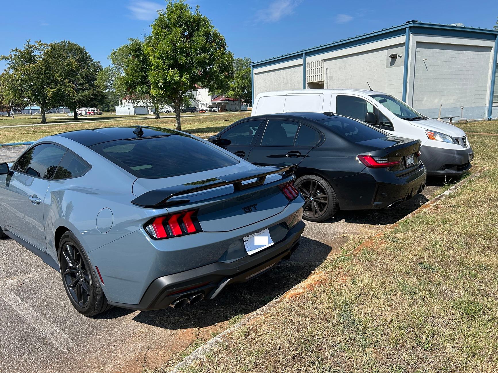

I decided to try again and I successfully installed my DAR gloss black spoiler. Drilled holes in the locations @stang2b provided. Looks very good. I am happy with it.
I called George at DAR and told him he would have a perfect product if the holes were in the right place. He agreed and asked for the measurements, so I sent him the photos of the measurements on this forum. I told him this was the only reason people were hesitating on buying this spoiler was the holes not aligning. He said they would update the product with these measurements soon. He also said the convertible version of this spoiler is online and available; they had a convertible in house a few days ago to test with.

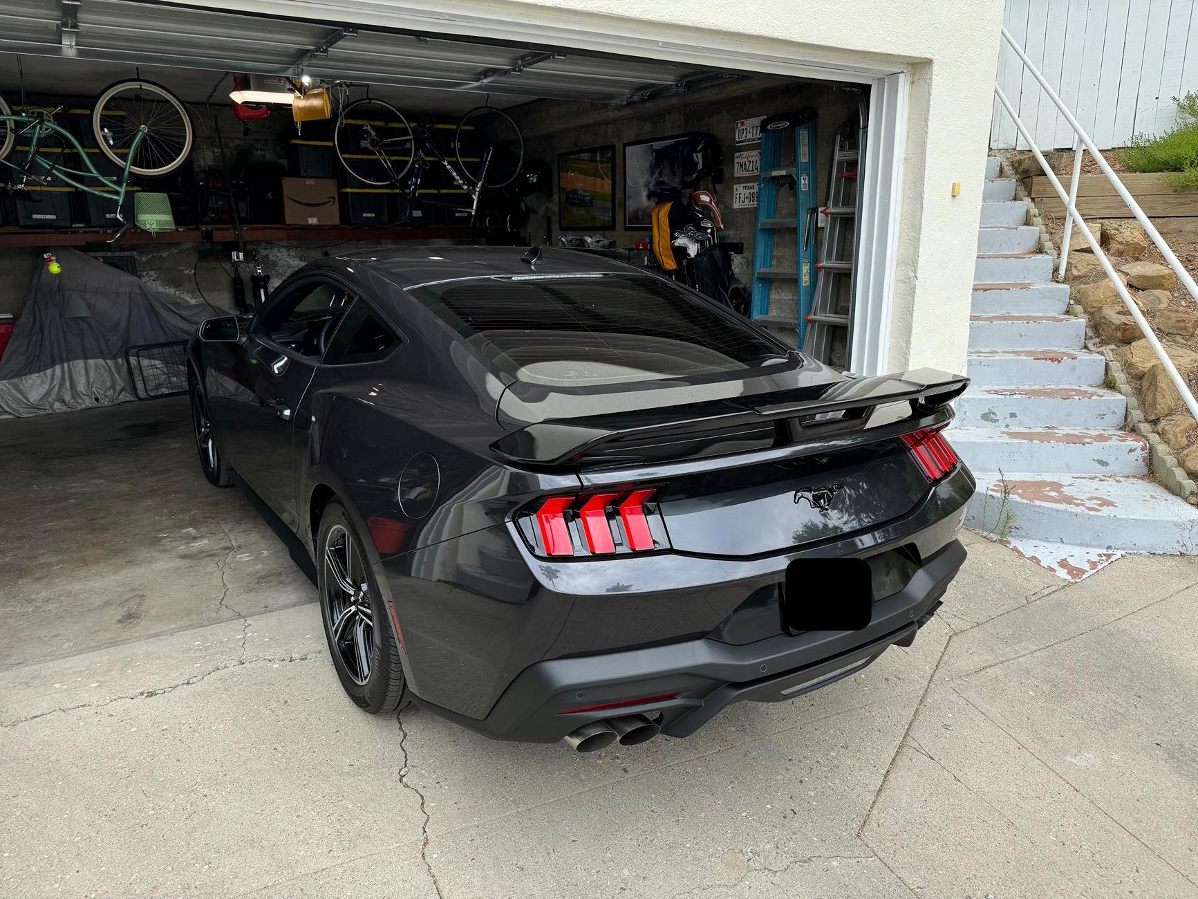

I've had a similar experience on my end. Ordered at the beginning of July, received and installed about a week ago. I had the factory spoiler delete option, so lining up with factory holes was not a requirement for me as I knew I'd be drilling new holes regardless. There were 2 holes on each side of the spoiler when it arrived, one larger with the screw in it, and one smaller next to it which aligned more closely with where the factory holes would be. After measuring 3 times to make sure everything was perfectly centered, I drilled my holes lined up with the smaller of the two holes as that made access from underneath the trunk/decklid easier to attach. With the spoiler perfectly centered on the car, those holes came through on the underside of the trunk in slightly different positions, so I don't know that I'd trust them to be perfectly aligned to the factory holes if you already have those. With the screws tightened down as far as I was comfortable (didn't want to over-torque and strip the pre-drilled holes) there was a very small gap on the left and right sides where the spoiler didn't quite sit flush with the trunk. I went and got some black silicone and covered up those gaps, and am pretty happy with how that turned out.
Overall I'm very happy with the look of how it turned out given the price. But the install was a little more involved than I would have liked and the fitment wasn't perfect.
