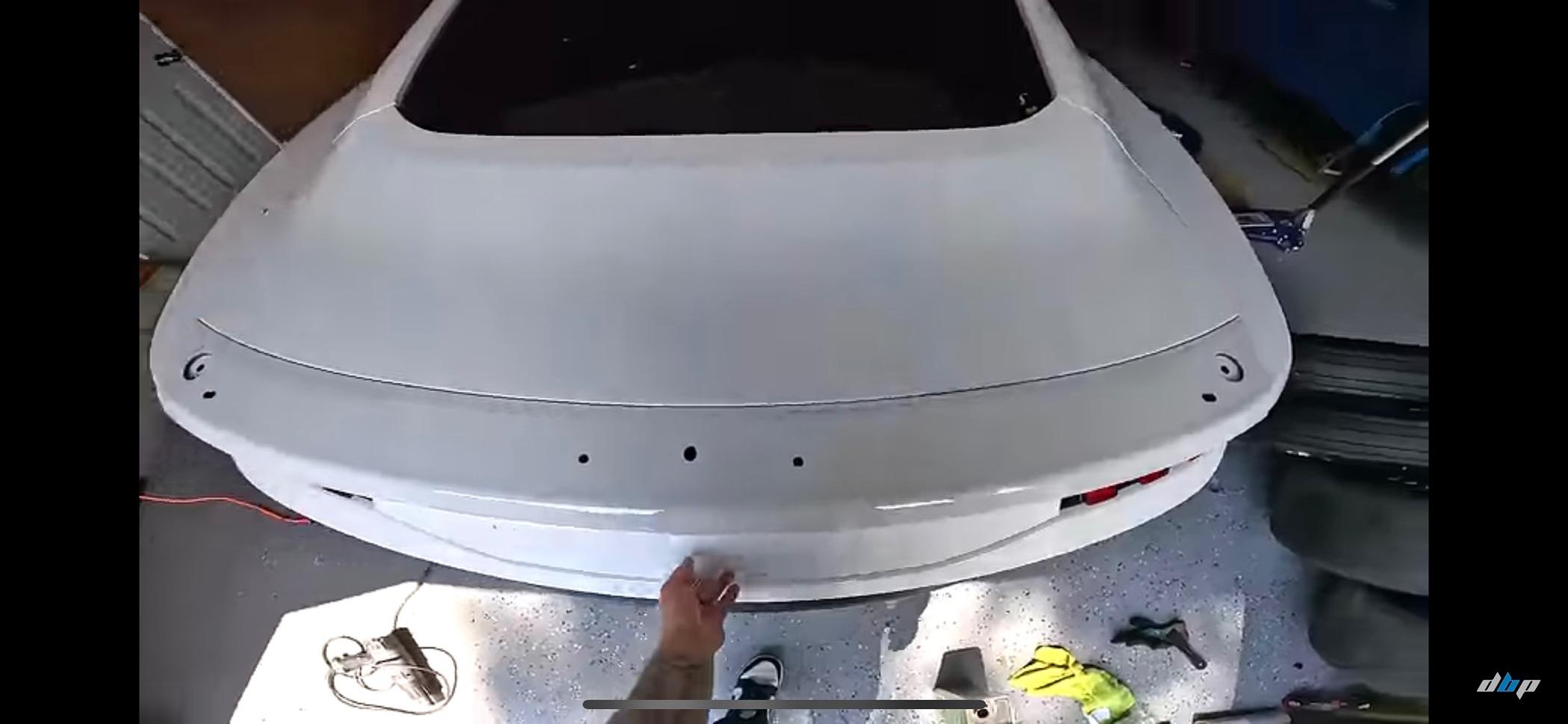

This screenshot might help those who are removing the factory blade spoiler. I took this screenshot from derekbaranproductions video on YouTube when he removed his spoiler. You can see the bolt he removed on the left and right sides. Then the 5 other holes are just alignment pins that come up as you lift the spoiler off. He heated the blade spoiler with a heat gun/hair dryer and flossed the adhesive away from the underside of the spoiler as lifted it up.

I can confirm, just removed mine. Removed the left and right 10mm bolts. Carefully used a heat gun and floss, it helps if you have someone manning the heat gun and lifting as you floss it. Just have to be a little careful the outer two center holes are plastic clips and I could see if too aggressive lifting up they could snap off and end in the trunk lid.
