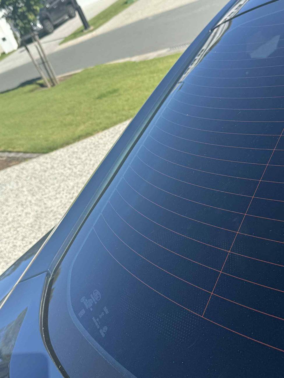

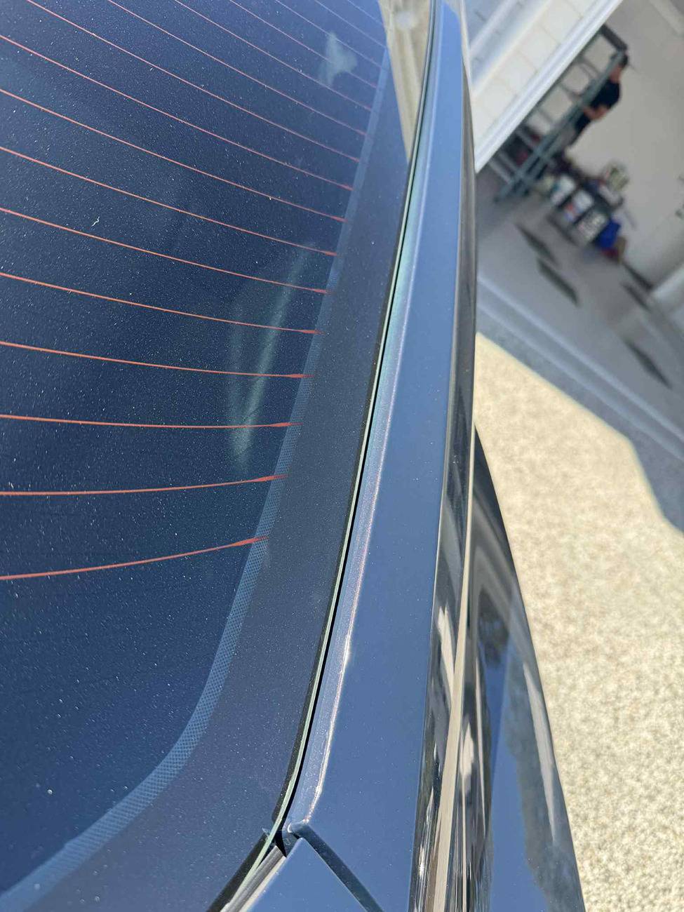

Has anyone else had issues around the rear window where you can see the undercoat / through the colour etc. My Dark horse is Blue Ember and on both sides of the rear window the metal that goes under the glass and around the side has light paint. I am devastated by how bad it looks.
I waited over 2 years for this car (Australia).

Hard to see in your pictures, but I have an unpainted area between the windshield and A Pilar inside the crease on the drivers side. It's not noticeable unless you look for it. But it's just another example of the awesome paint application at the factory.

@Velocitys2020 ....... I can see where you are upset. As I see it you have two choices. Before considering either I would take it to the dealership and have them record the issue - WITH pictures and give you a work order or warranty issue claim number. - in case there is a further future deterioration. Then I would take it to a very, very good custom paint shop(s) and ask them their opinion. Could they do something that was less noticeable? If they said yes I would take that information to the dealer and discuss having the custom shop do the work. Most dealerships can not do this level of repair. Then, after hearing options, I would have a good "think" about what I wanted. Having owned a custom paint company I know that it is easy to make a situation like this a LOT worse if the wrong technician is involved.....and with this type of repair (where a number of disparate materials come together) it is easy for matters to go sideways. Are you prepared to roll those dice? If it were me I'd have the dealership record my concern, gather info from great paint shops then decide if I could I could live with it. I would wait at least two weeks before I made a decision that could end-up worse. What you do have is an awesome car. Most can only dream of owning a DH. Don't let this ruin your enjoyment. My guess is that after a few weeks of awesome driving you won't even think of that area. If you still do then look at a custom spray touch up.

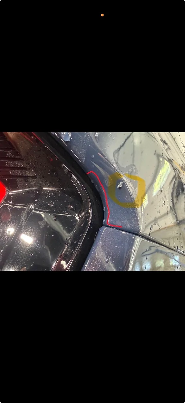

Just picked up my 2026 Mustang Dark Horse last week and was getting it ready for full PPF when the installer found this paint defect near the left taillight
Since the car is only a week old, I'm planning to bring it back to the dealer before the PPF goes on.
Looks like this isn't an isolated issue. I've only put 200 miles on the car, I'm taking it back to the dealer for a paint warranty claim. Pretty disappointing on a brand-new Dark Horse.
Hopefully Ford takes care of it quickly, but it sounds like I'll be without the car for another week.

That looks like damage, not a defect.

I understand what you mean, but seeing it in person, it doesn’t look like external damage at all. It’s a raised bump in the paint/clear, not a scratch, chip, dent, or impact mark.
The PPF installer found it during prep, before the film went on, and it appears to be under the finish rather than something caused afterward.

@mthx .... on the 2026 Premium GT convertible that I took posession of in March then took to a technician for ceramic coating he noticed a small bulge on the trunk edge near the convertible top. We think a piece of body caulking from inside the trunk lid got pushed up then painted. I used my wife's small grit nail file to level it - yes it was soft gray caulk under the paint. I applied primer, paint and clear coat with an artist's brush - not the crap brushes that come with the touch up kits. It's almost impossible to see.

Thanks for the info. That sounds very close to what I’m seeing on mine. It really looks like something under the paint/clear that was painted over, not impact damage. There’s no chip, scratch, broken paint, or dent pattern. Since the car is brand new and the PPF hasn’t gone on yet, I’m going to have Ford inspect it and document it as a paint warranty issue before touching anything myself.
