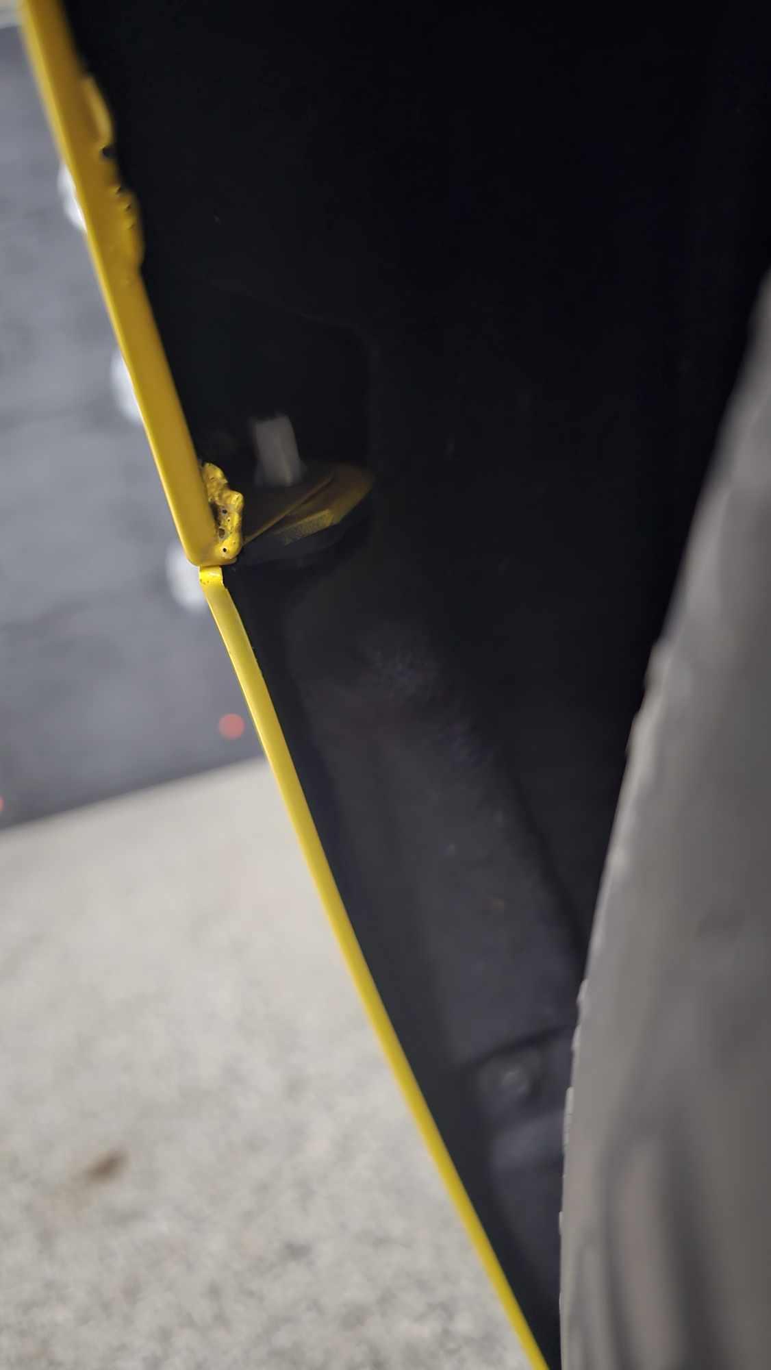

I found the same kind of crap inside the rear fender. It's like a mass of goop settled there.
I didn't catch it during delivery but i'll take it back and see what they say.
I was tempted to cut it off but i'm worried it will make the paint flake off over time.
Maybe cut it sharply and then clear coat the hell out of the "cut" ?
That looks like melted cheese
Got the same, its in both my rear wheel wells. Although it's only one "clump" for each well. Missed it at pick-up and didn't want to remove since it it seems like it would create bigger issues over time.
My appointment with the dealership isn't until 10/20 but if you get a response from your dealer sooner on how they'll handle please let us know.
Panel adhesive where the outer skin is glued to the wheel house. Leave it alone.

If you are going to remove it, then you are going to have to seal that part back up.
I would cut it with a razor blade, sand it down with some 600-1000 grit and reapply a coat base(if you removed the color) and then a coat of 2K clear to make sure the paint is sealed off to the elements.
If you are worried, have a professional knock it down and touch it up.
