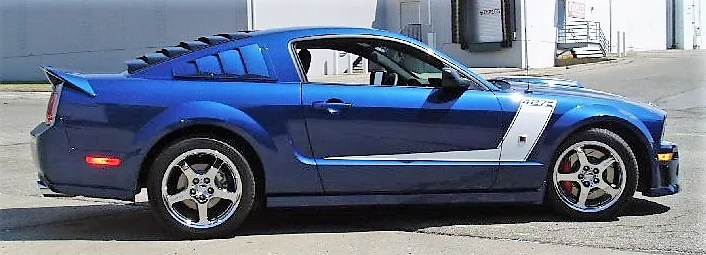

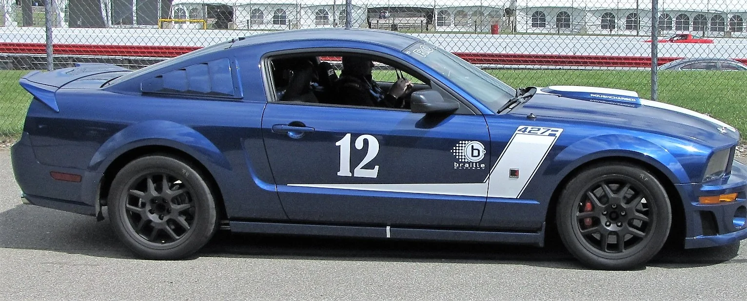

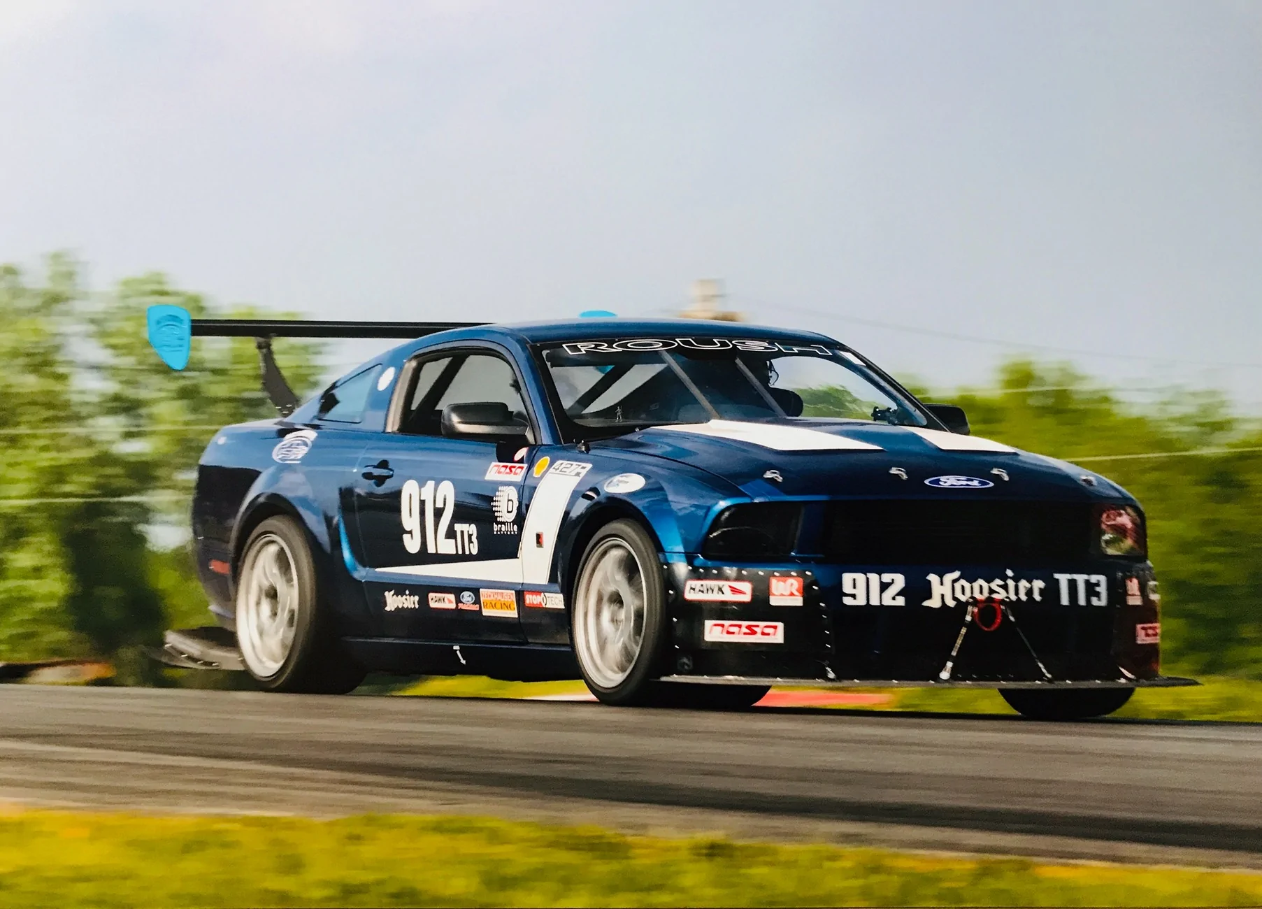

Yes it is. As I was ready to move out of HPDE (with NASA), I was convinced that racing class American Iron was my next move. After talking to many drivers and weighing the cost factor as well as potential damage factor, I reconsidered the racing classes. Instead, went into Time Trials (TT3) and loved it. Cost factor for TT was not as bad as it would have been in racing class, but converting a street car into dedicated TT car, took time and $$. In TT, as you are always looking to go faster and improve your times, there's always improvements to consider, from aero to tires to suspension and so on. I spent 5 years in HPDE (2 in HPDE4) and wanted more and was totally committed to making the changes needed to be successful in TT. A great experience and I miss it.
The evolution from street/show car to HPDE to TT.
S650 Mustang New Build! Ultimate Daily / Track Weapon Combo 2008 Roush 427R
S650 Mustang New Build! Ultimate Daily / Track Weapon Combo IMG_2285 (3) (2013_08_03 18_35_33 UTC)
S650 Mustang New Build! Ultimate Daily / Track Weapon Combo ROUSH 427R
