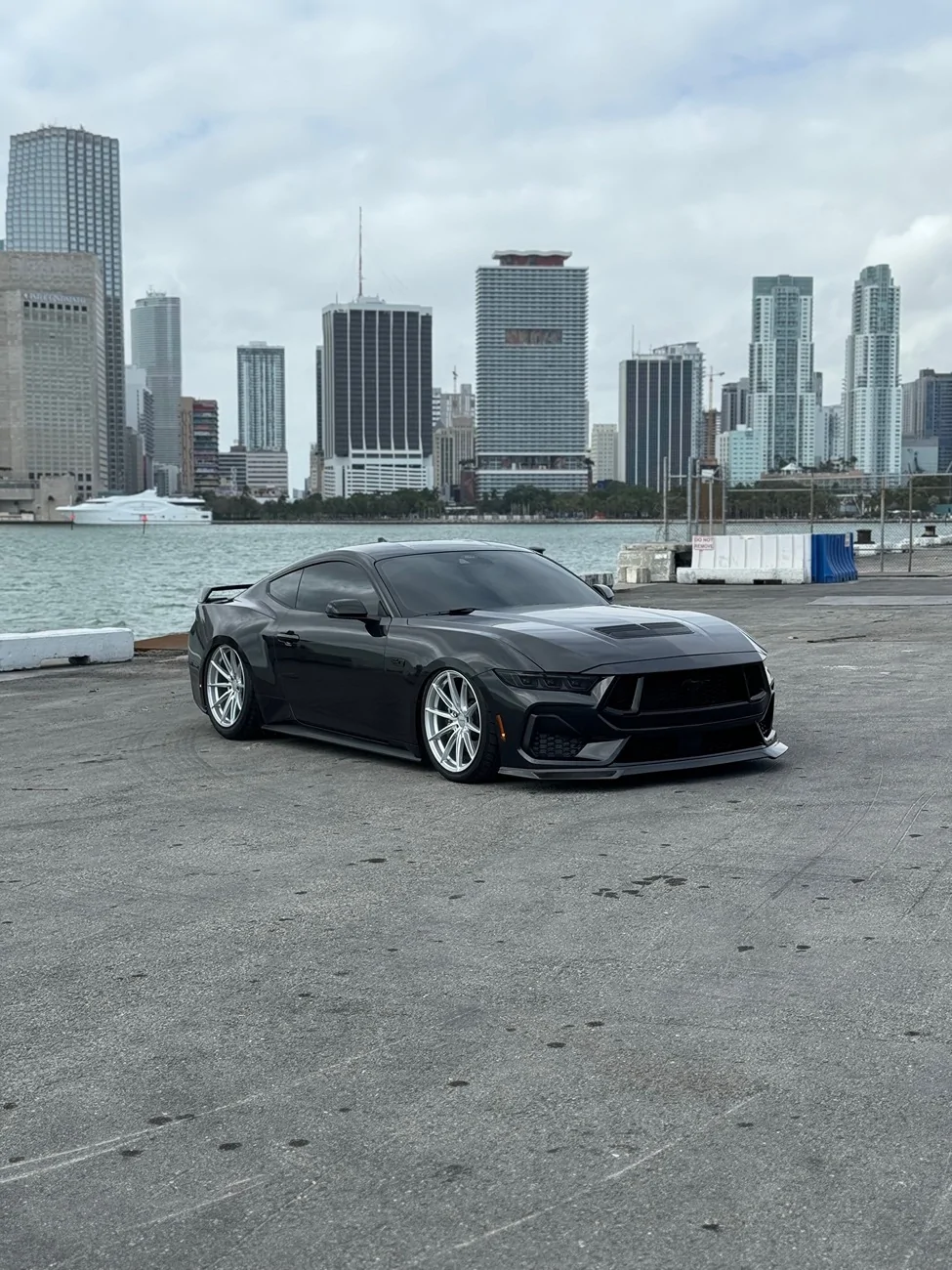

Congrats on the new purchase! You'll definitely love the new s650 platform.
When I first got mine, I went ahead and went with the Steeda progressive springs. It was a nice drop and the ride was great. I went ahead and later on switched to airlift performance for the looks.
As far as wheels, you can't go wrong with velgen's 20 inch wheels. They have many designs to choose from.
Check mine out
S650 Mustang New Build! Ultimate Daily / Track Weapon Combo mustang 3

I dont think 20s will allow me to run a more aggressive 305 square setup. Plus Ill want more sidewall from some 19s. Even 19s on 305s is going to be annoying.
I would for sure run 20s if I wanted to make that sacrifice. I may end up running like 18x11s..
