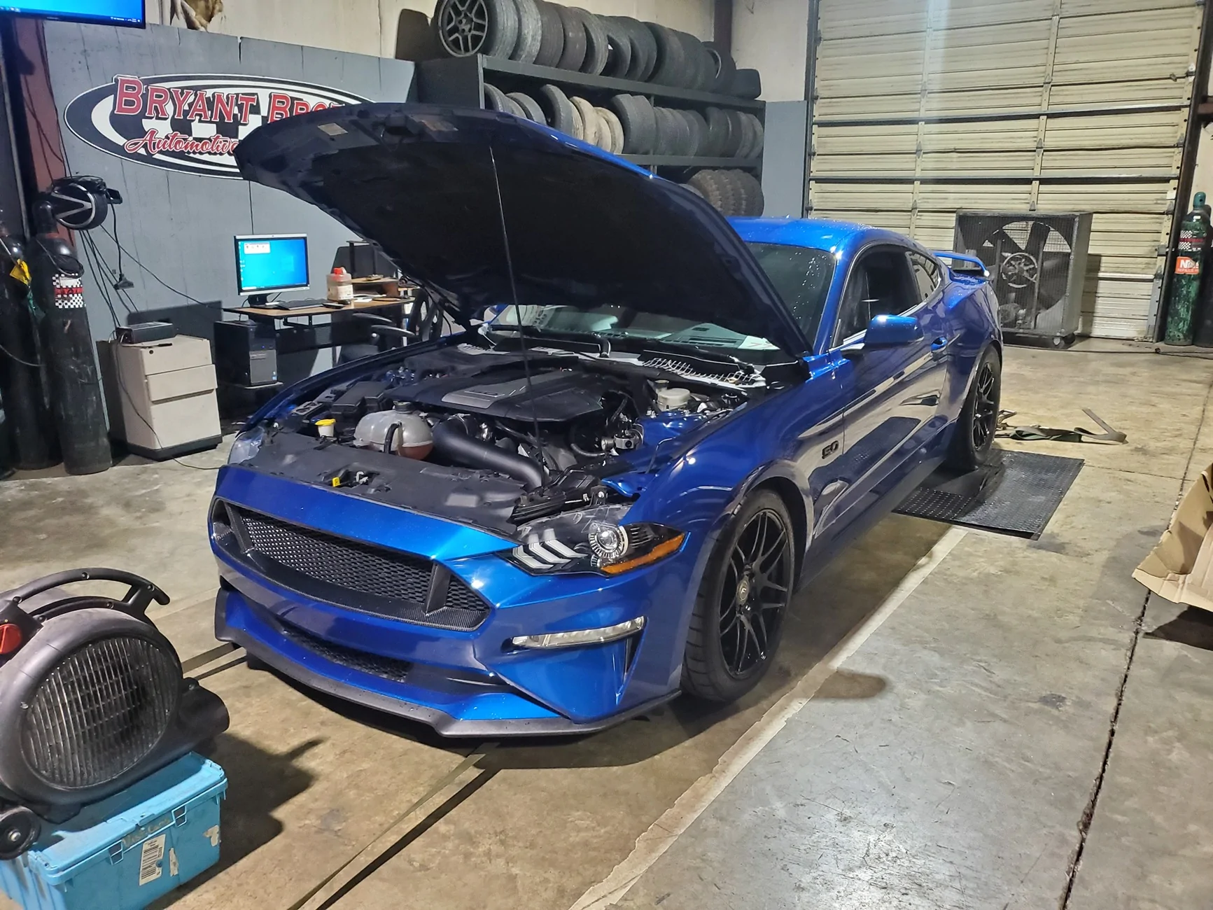

Also I was putting down slightly under 1200 to the ground and driving it to work lol but its easier to keep your foot out of something than it is to cool and keep everything properly lubricated, aligned, and just not busted while beating on a car for hours on end at a road course. God bless those mechanics man. Also rip to the tire gods.
Here's a Pic of the old Mustang tuned up. Sleeper build. Twin turbos on E85 with all of the supporting mods.

LOL, I would not have guessed anything by a quick glance at the top of the engine bay.
