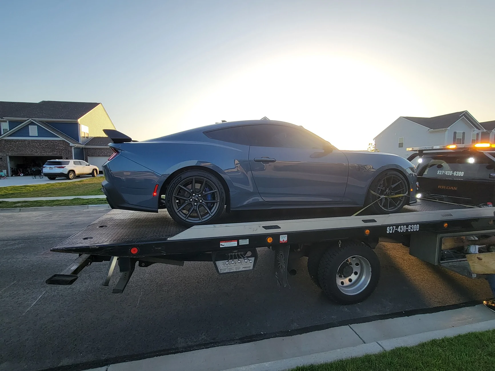

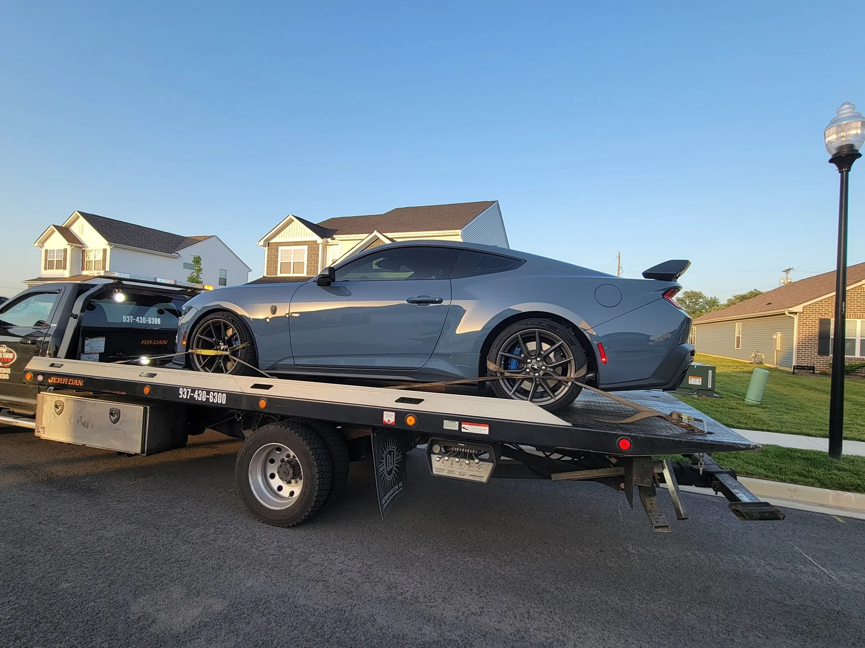

Pulled up to a stop light and smoke was rolling from under the hood right down the road from my house. Pulled in shutdown immediately and lifted the hood. Something is smoking on the right rear cylinder head if you are standing in front of the car looking at it by the master cylinder. With what I heard took no risk of driving it and not being covered under warranty. Being towed to Lebanon Ford as I type this now. Hope it is nothing serious. Was time for oil change but didn't want it like this.

So you win a chicken dinner. Valve cover gasket leak. Hope to have it back Friday. Lebanon Ford has been great through the experience so far. Talked to Cameron about getting the Steeda H pipe and a stop the hop kit installed also.
