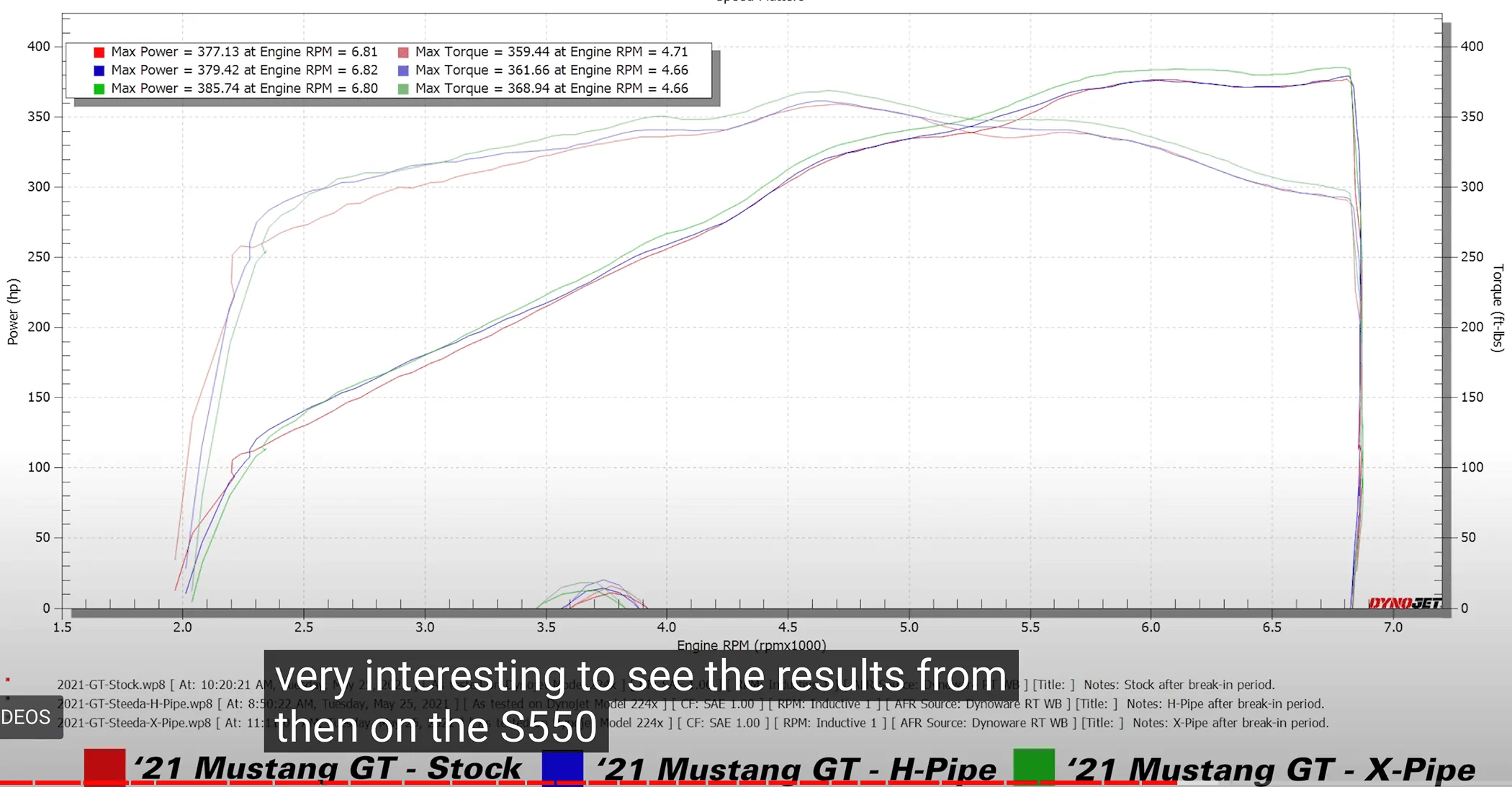

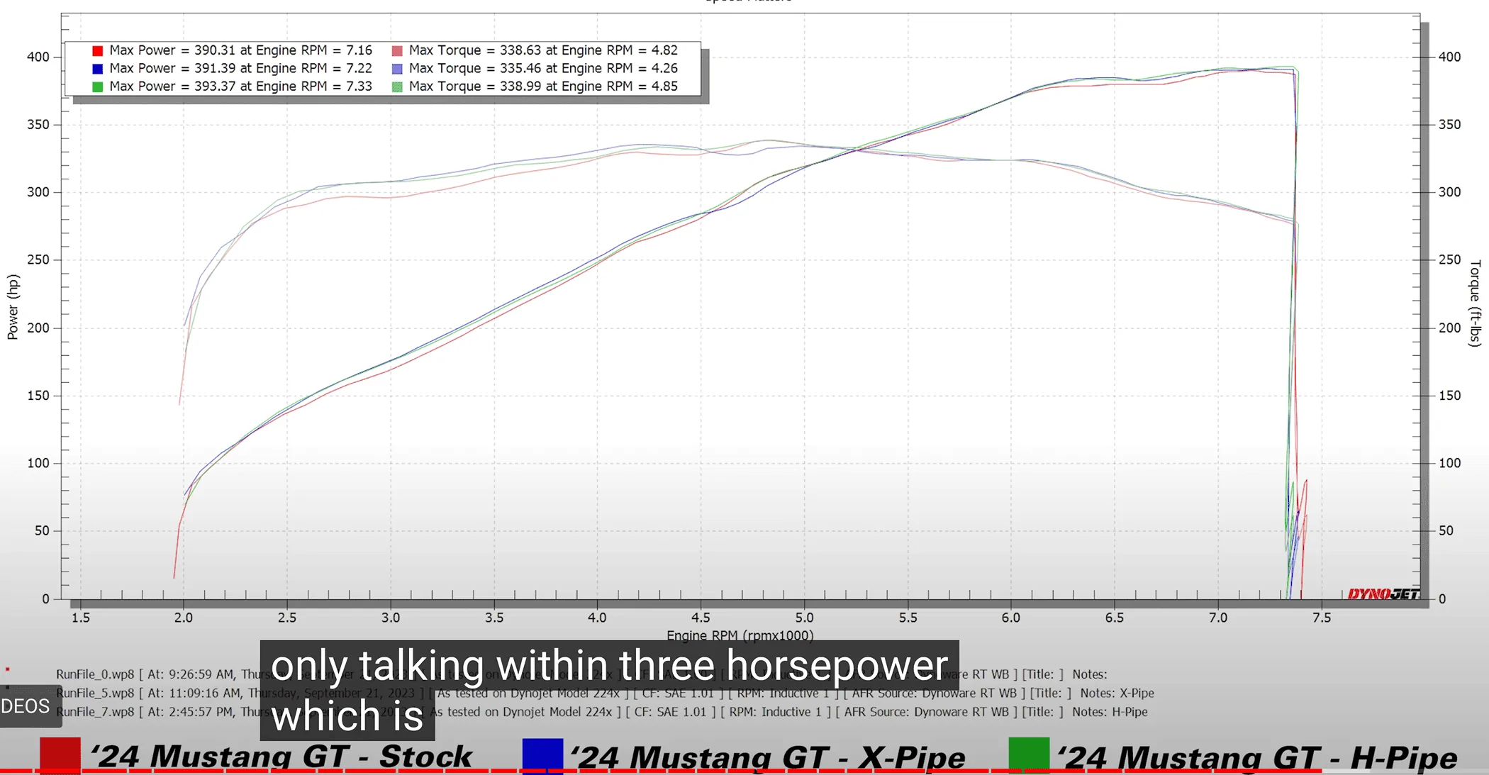

H-pipe had better dino results in the S650. 🤷‍♂️
It made 3 hp peak....
However, the X pipe (blue line) makes more power through most of the graph, especially on the low-end like the increase the H pipe supposedly gave. " butt dyno certified improvement in low end torque "
On the S550 test in that video, the X pipe made 6hp more throughout the powerband
It's also not the Corsa double H pipe so this all means nothing.

3 hp....
Why does this S650 only make 390whp?
Steeda’s dyno gives lower readings consistently when compared with other dynos. That’s why you can’t always compare numbers when run on different dynos.
Edited the post, it was the S550 numbers
